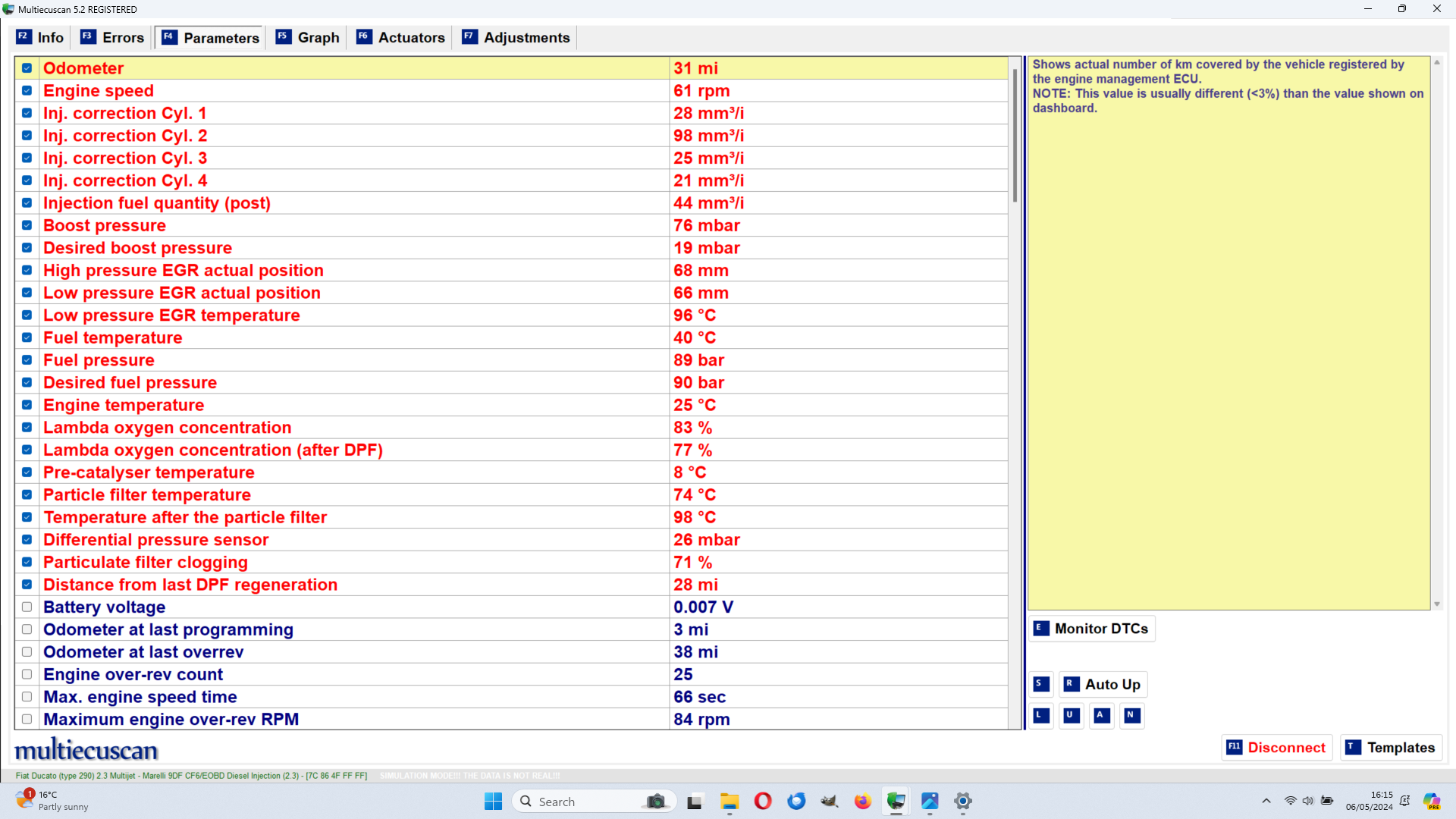

heres a question, has any one done a DPF delete.
I understand that you may not want to broadcast this info , it may be legal or no issue in your country.
what i would like to do is charecterise with MES so we know what a Deleted DPF would look like. (got ideas but show me the data)
PM me in confidence. I all ready have data for HPEGR and LPEGR delete and a LPEGR delete on its own, but not a sieve removal and cracked DPF.View attachment 445173
