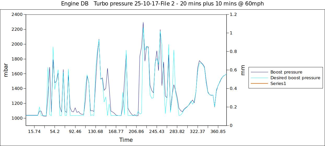

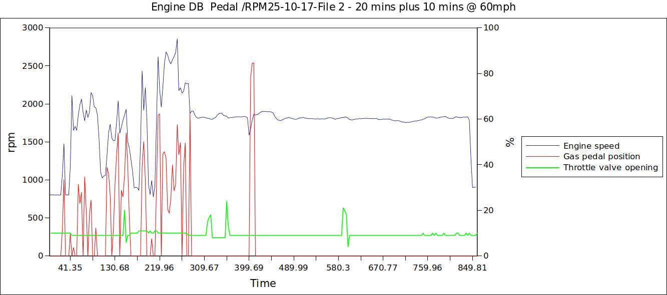

yes i realised i hadn't updated template 0 but was on a road trip with my kids... with do so before the next for sure! If i'm in a position to do so, i will give it a good boot during the next regen and see if i can spike the temps with the throttle - i think @theoneandonly suggested this might be contributory a while ago.
