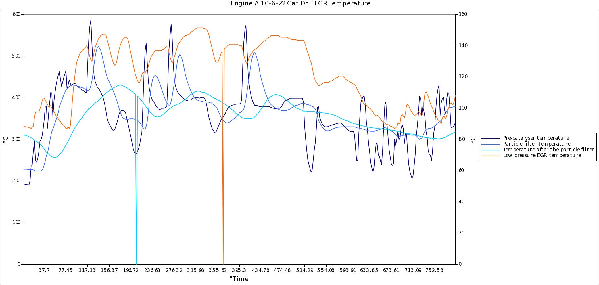

On the mobile version is it possible to access the .csv files or export a csv file to be imported onto a PC. I regularly do this on the windows version and on my android phone (using alfaobd)Injectors corrections I had on old (before change) just on started engine not driving over 2mm^3 now on band new on I have on started engine less than 2mm^3. During driving it is going more than 2 mm^3. I have MES only on mobile and its not easy to record such good graph like on laptop. Somebody explained to me that correcation is not oly about injector, it can be also connected to not proper valve or other aspects in engine...
