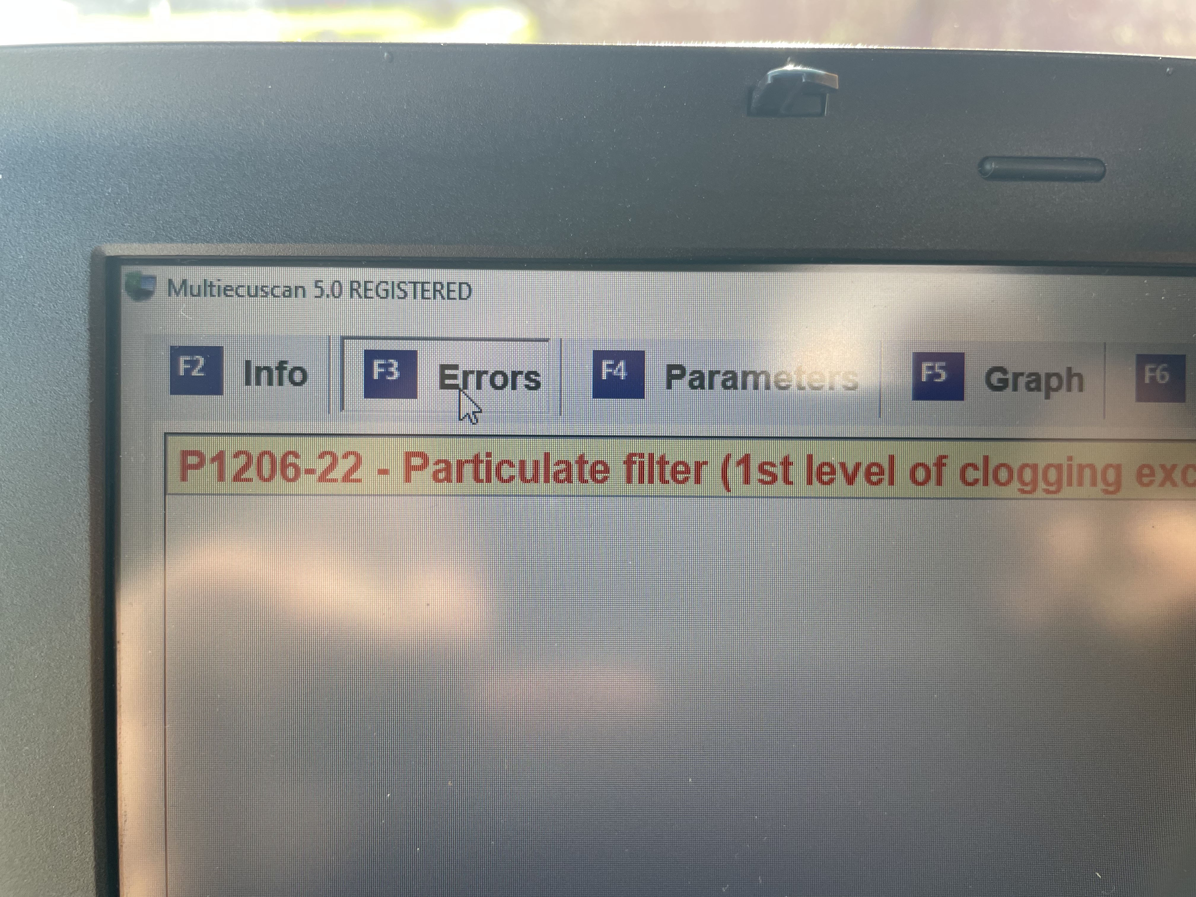

I have different problem now. Dpf is doing its job, but is not doing the regrnerations. Due that the engine is going to leap home mode. It was working OK for about 5000 km after changing DPF and cleaning operation, but then suddenly regenerations stopped. If i do forced regeneration it is OK for around 1000 km and then it goes again. All components after DPF (cooler, EGR….) are spotlesly clean. temertures at DPF are OK. Pressure differental sensor was replaced, hoses were cleaned and have no eak. Lamba sondes are OK……
I am stuck again…

If you check at 200km then say at 500km, after forced Regen what level of clogging percentage is it showing? Ie can you see it slowly clogging up? Did you recalibrate the differencial sensor after fitting the new one? If clogging percentage isn't as it should be is it possible you have a split black air pipe to/ from the differencial sensor?
Percentage of the clogging is a puzzle for me. If you observe the numbers in my case when i count to six it goes up for 0,01 % an so on after each count (in idle stand still). What is strange is that before forced regeneration (with error code on) clogging was around 35%. After regeneration it jumped to 70%. I was in the state of panic and we took the dpf off and checked it. It was virtualy clean (see the pictures). Strange is that after i took out the temperature sensors (i connected them to the car when they were out of the exhaust system, heated them and the parameters of all 3 sensors were exactly the same, boling whater temperature was shown at 99 degrees) when i returned them with ignition on the clogging was at 89%, but when i started the engine it jumped to 59….
The hoses are OK, the differential sensor in idle shows betweeen 7 and 12 mbar
In total humble innocence I would replace the pressure sensor and Programm it.
Is there any other sensor for exhaust back pressure?
I already replaced differential sensor and programed it in as a new one. As far as i know that is the only one. I forgot to say I also replaced injectors…..
the regen is a puzzle. the temperature sensors are Ok, what temperature is the DPF getting to, 600c?
The one thing that knaws at me is the Differential pressure sensor even though it has been replaced it reminds me of a Danner scanner utube video that had him chasing around and the problem was a dead replacement sensor. I am aware of one other instance where the pipes were full of water a new sensor and blowing pipes out solved the issue.
You quote the sensor getting 7_12mbar at idle does it get above 20 at 2000rpm
Because i suspected that the new differential sensor could be faulty as well i replaced it again, but nothing changed. So now i have 3 sensors. I used compressed air to blow out the pipes. I am not sure about dif pressure @2000 RPM I will check it . Maximum temperature values during 20 km drive on highway were pre-cataliser 448, particle filter temperature 439 and after particle filter 415 degrees celsius…
