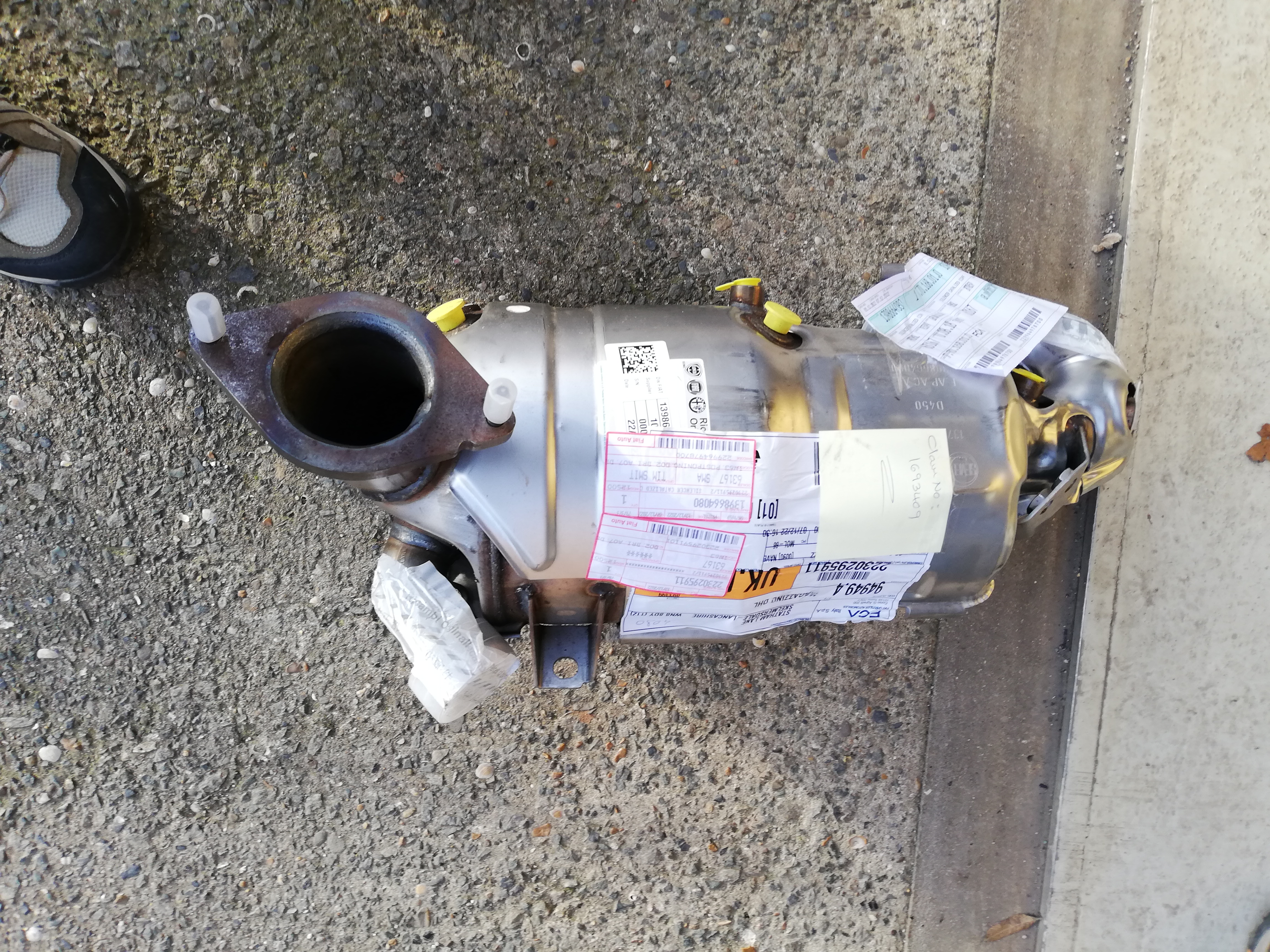

Picture of old DPF below, much bigger than i expected. And its heavy!!!
Hi Smudger, good to hear you are back up and running. May I ask what all the labels are on the DPF? Are they stickers from all the replacement parts? Did you get any receipts giving a list of parts fitted. I just wondering if the rest of us can learn something.
Hi Fredastaire,
Not sure about labels but I will get a list of work done in the New year and will share it with you. Cheers and Merry Xmas.

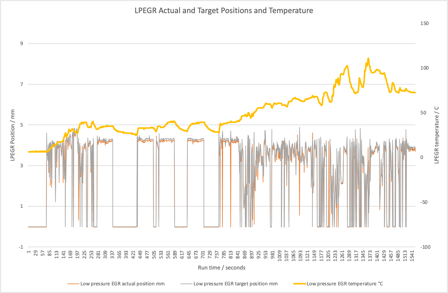

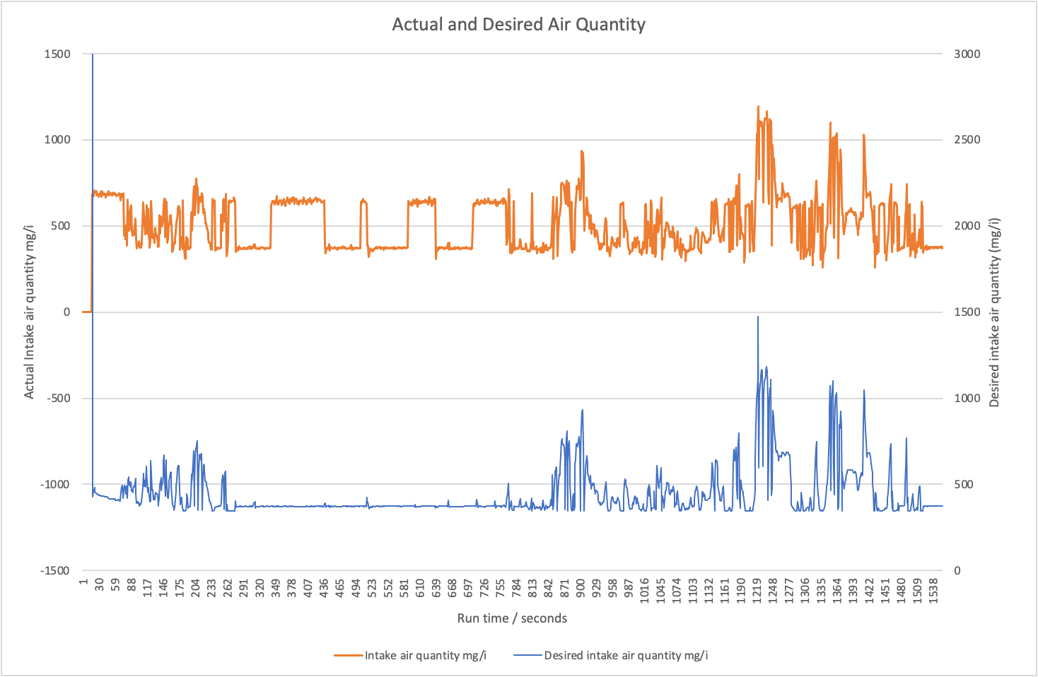

Hello everyone. I’m new to this forum and this is my first post so please bear with me.
I have a 2018 (I think) Euro 6b, non-Adblue Ducato 2.3 in which I have done around 15000 miles. For the first time, a couple of thousand miles ago, the MIL came up and the van went into limp mode. It hasn’t happened since although I’ve the ! yellow warning light on a couple of times.
Digging around I came across this forum and this thread in particular which I’ve read with interest. So I asked Father Christmas for a MultiEcuScan which I’ve been messing around with for the past couple of days.
The first thing to say is I’m running software version 0028 and I don’t have any of the codes discussed on here so perhaps I don’t have a problem? But I do have a two error codes:
P0203-13 Cylinder 3 injector Open circuit Intermittent
P250A-38 Engine oil level sensor Signal Frequency incorrect Intermittent
For both of these codes it says “Dashboard warning light was not activated for this fault” but as there are no other faults and the MIL came up I’m puzzled.
I should also say my exhaust looks clean and the DPF regenerates on average every 500 km at an average temperature of 613 C and for an average of 428 seconds. It has “Normal clogging”

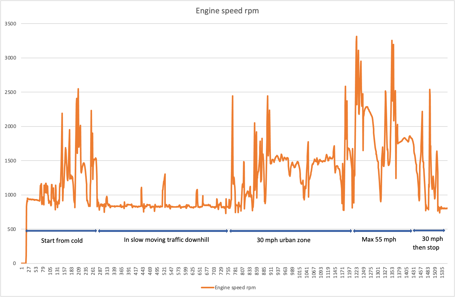

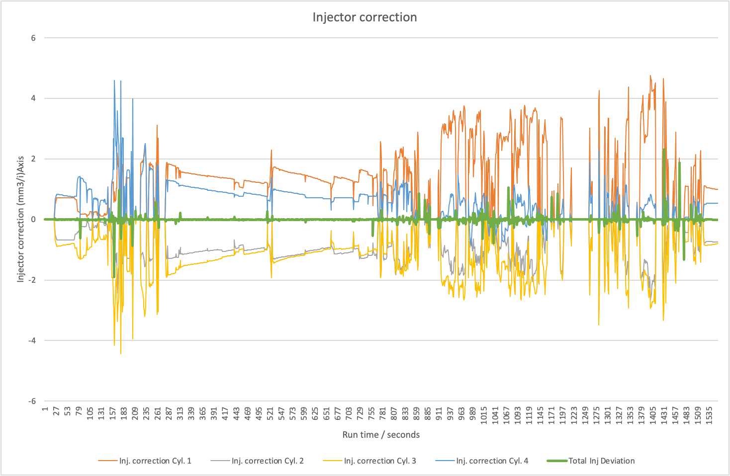

Below are some plots of some engine data from a run I did a couple of days ago looking at some of the important parameters mentioned in this thread. First the journey and engine revs:

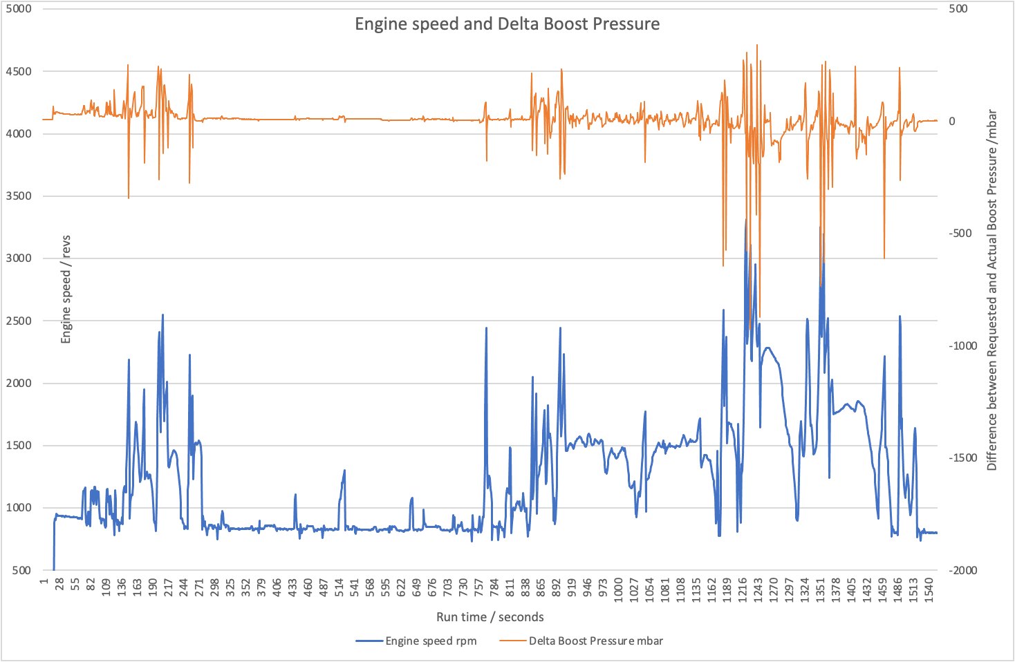

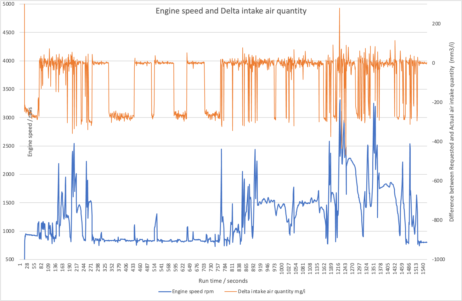

Then some charts of various engine parameters:
So my assessment of this data is:
  • There seems to be an injector problem as evidenced by the fault code and some correction values being on the high side.
  • The LPEGR position seems to, on the whole, match the target position and has a maximum value of about 4.2 mm
  • The LPEGR temperature reached a maximum of 110 C.
I’d be interested to hear the opinions of others here on the data. In particular is there anything in the data that suggests I have a developing problem. Also, do people recommend that I should get my software updated to the lasted 0032 version.

First comment
well done Father christmas, Multiecuscan a good choice
Good choices of initial data.
The LPEGR valve can open upto a max of 4.7 , yours does control with values down to 2mm the LPEGR cooler temperature upto 110C is OK but I would like to see a 20min run down the Motorway at 60mph or sort of constant 2000-2500 rpm (120 happy as larry) Clean exhaust good.
Version 28 same as i'm running, ive been putting off updating for a few reasons. If it was bellow 28 i would say change now.
Injector correction values, the sum of corrections is good and bellow limmit. The individual values together with a code say something is not quite right.
The transition from a Good engine to troubles brewing is the difficult bit to judge. Ive been lucky to get access to bad engine data but Good engine has been mine.
My first suggestion is to do the test run of a warm engine then 20min run down the Motorway at 60mph. Add DPF differential sensor and cat /DPF temperatures to your list of parameters
Then address injector issue,
1: use a injector cleaner in the fuel, i use Liqui Moly diesel purge.
2: Remove injectors for testing by diesel specialist and or replacement
I did 1 then continually monitor, i have one injector that gives me ? concerning variation but no codes
others may suggest jumping straight to 2
Thats enough for now

First comment
@theoneandonly Thanks for the observations and suggestions. I don't understand properly what the "injector correction is" - is the ECU aware by some means how much diesel each injector is actually delivering and adjusts the amount up and down to achieve some nominal amount. Looking at my csv file there are times when the correction values are all zero - what's happening at that point:
One further observation I have is that for the last few months when I lift my foot off the accelerator after reaching the crest of a hill I sense a hesitation in the engine. Quite subtle but definitely a change. I'll try and take the van out this week for the run you suggested.

@Fredastaire I confess I've always bought fuel based on price, assuming they were all the same. Paying a few more pence per L would make sense if was to avert the need for the type of expense @Smudger55 has had to bear. Can you recommend a brand and do you now how its composition values wrt supermarket types?
@Masefield , I've been going through this saga for in excess of 18 months, I've spoken with many people by email, text and telephone. It was clear early on that injectors condition is critical. I took the decision to use 'ultra' type diesel plus the millers because I'm scared of the risks of more damage. I have conversed with Fiat main dealer mechanics in other countries who know it's a dirty burning engine and say beware the injectors. I use Jet diesel 9 out of 10 times ie wherever possible. As I only do 6k miles per year the extra pence doesn't matter.
@Fredastaire, that useful to know. Cheers Smudger55
@Fredastaire , do you expect the ultra type diesel to both clean already dirty/damaged injectors and prevent them reaching that state in the further or do you need to use the additive as well to achieve this goal?
@Masefield that's a good question which I'm unable to answer as I just don't know. I'm forever keeping fingers crossed, (and frequently using MES to keep an eye on what's going on)
Regularly do a test run and monitor:
1 Injector variation
2 LPEGR Actual position
3 LPEGR cooler temperature
4 Differential DPF sensor
5 Regen history
6 Physically inspect the exhaust pipe
7 Regularly use injector cleaner.
As to fuel additives i'm agnostic. just dont put more than advertised as they can contaminate Lambda sensors.
Deciding when to test injectors I just don't know.
