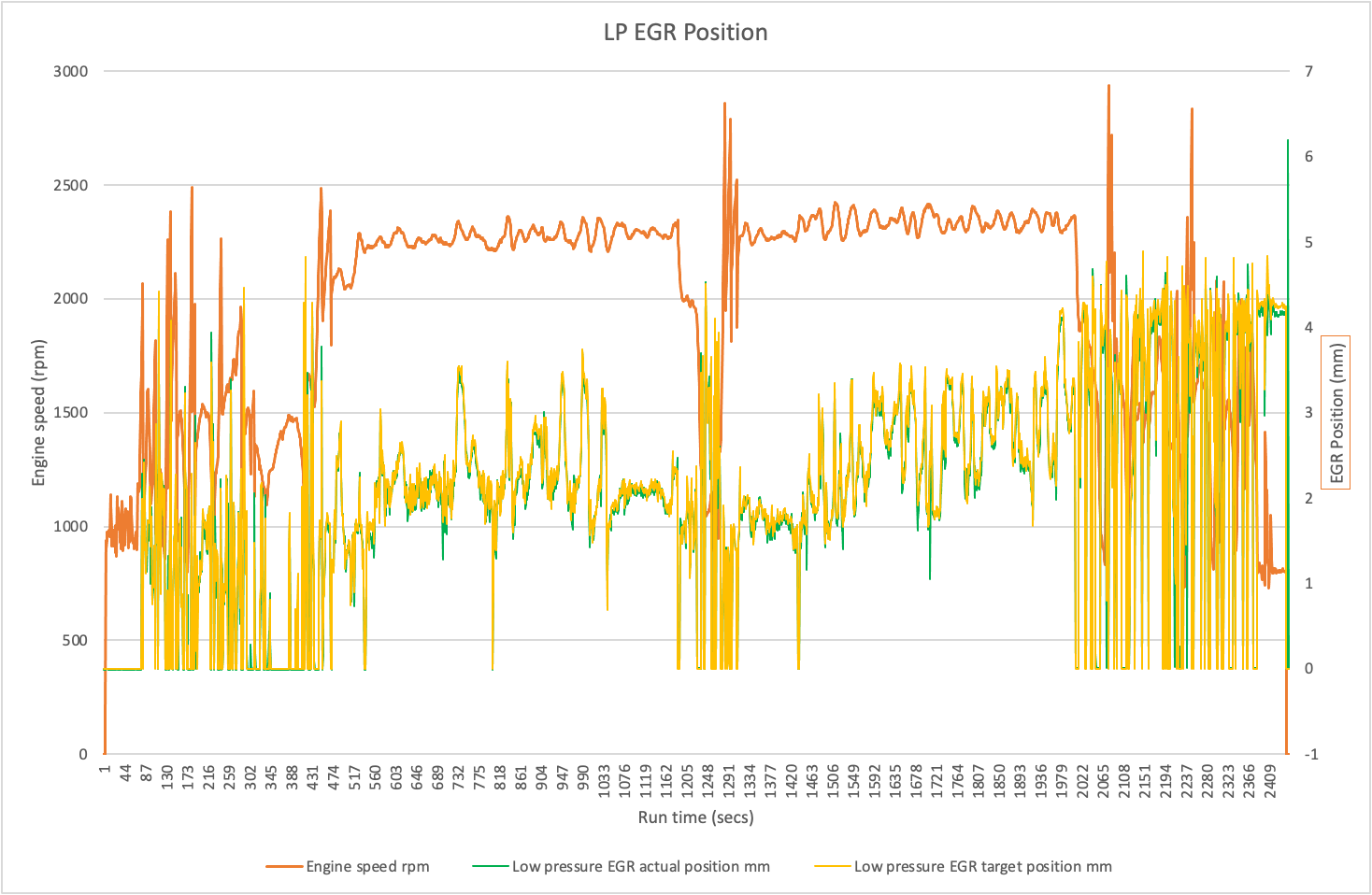

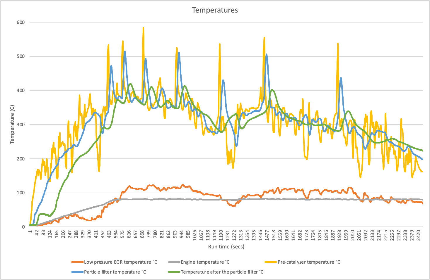

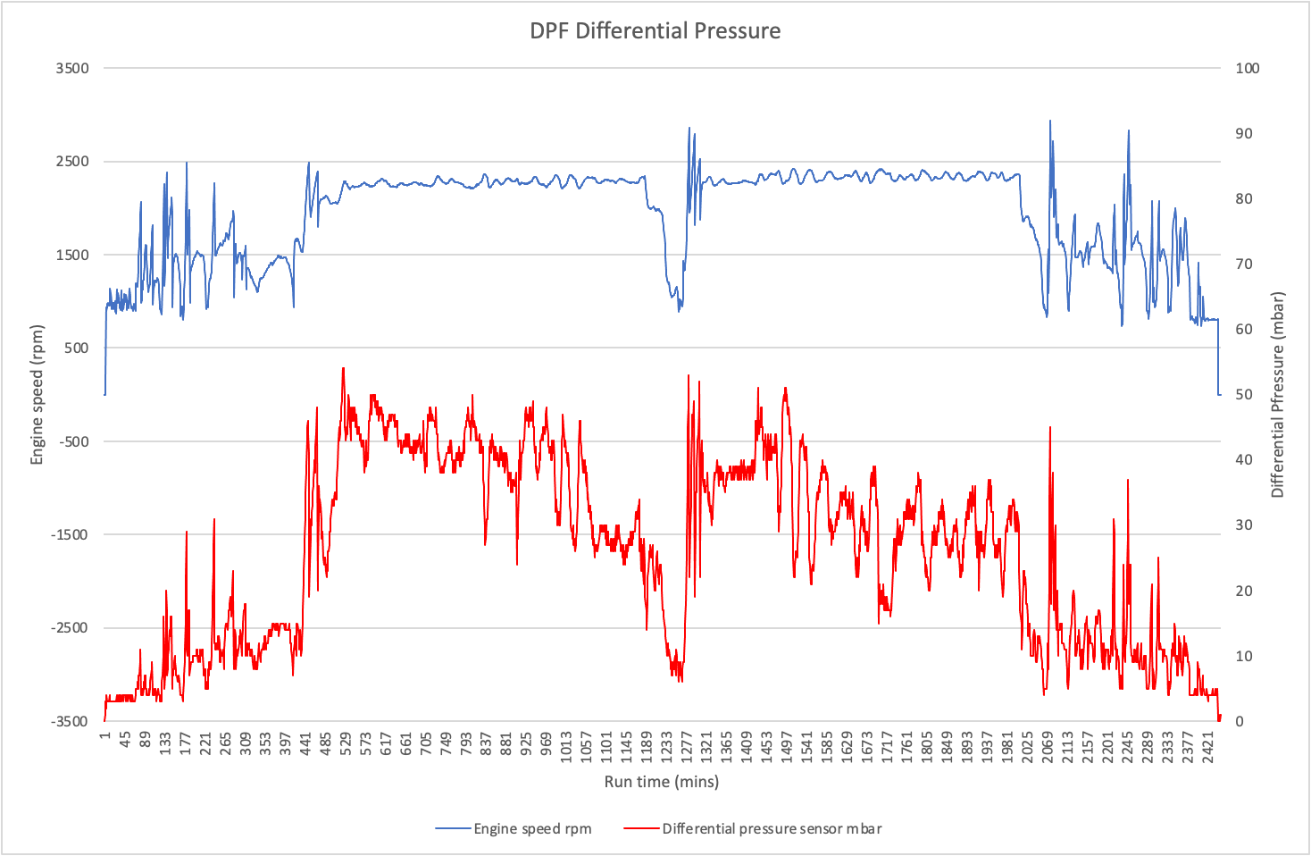

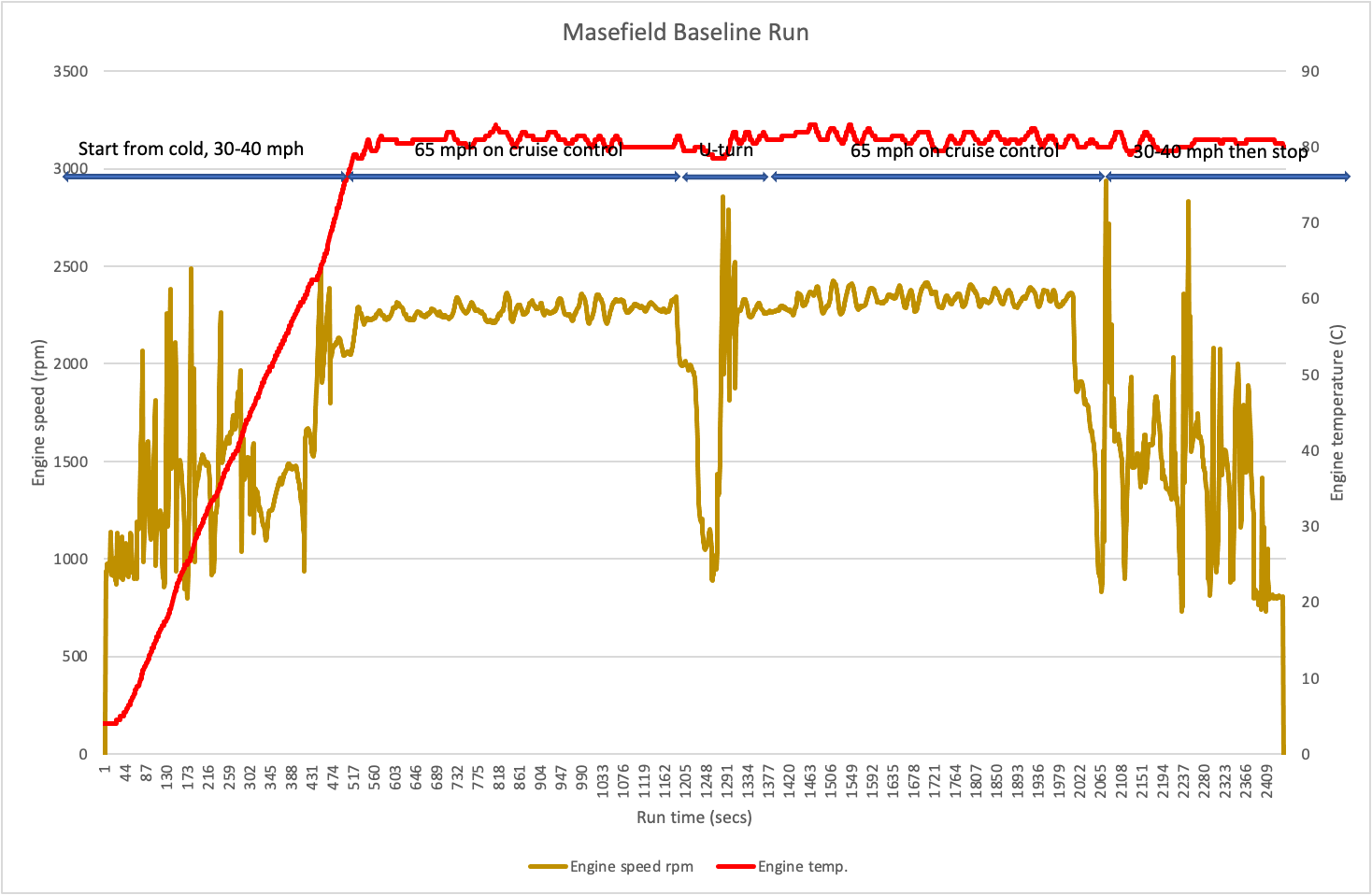

Following @theoneandonly recommendations I took my van for a longer higher speed run a couple of days ago. The run involves starting from cold then travelling a few miles to a dual carriageway, then around 12 miles at 65 mph on cruise control (nb speedo does overread so probably nearer 62 mph), then off, around an island, rejoin and reverse route home. @theoneandonly has offered to process my raw data and compare with others - I think this a useful exercise so thanks to him for undertaking that work.
I've done some processing myself so I'll show those here on this occasion. I propose to take the van on this run fairly regularly but I won't bore you with the results on future runs. I think what's important now is that have a baseline for my van and the facility to compare it with others.
First the run:
Various temperatures:
LPEGR Position:
and Delta LPEGR position:

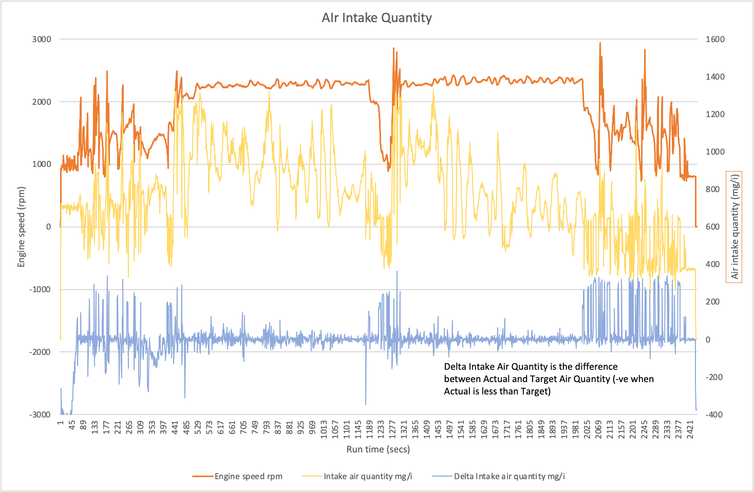

Air Intake data:
and Delta Air Intake data:
and finally the Differential DPF Pressure:
I've always bought my fuel based on price, so usually supermarkets and I usually drive the van at a relaxed (for me) 50 mph on open roads. I now see that perhaps both these approaches are flawed so I'll start using Shell diesel (as there's a garage nearby) and driving a bit faster. I also have to confess that I've regarded fuel additives as snake oil, perhaps I should change my view on this too?
Finally I really appreciate everyone whose taken an interest in my engine. The whole thing is a strange combination of an interesting problem combined with a very worrying prospect of both being let down whilst away from home and being faced with a large repair bill.

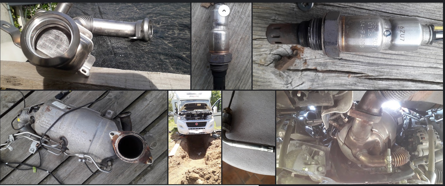

pour le diagnostic de ce tamis lp egr j avais devisser les 2 vis qui tienne le colecteur du refroidisseur a la vanne egr basse pression ceci permettais de laisser passer de l air pur a l entrée du turbo, et comme je n ai pas eu de defaut renouveler j ai su que le tamis étais bouché . on peu le désaccoupler par dessous le vehicule . j avais changer en neuf le tamis et un capteur de temperature j ai fais 14000 KM depuis et aucun probleme
FIAT n a pas souhaiter faire unne mise a jour et n avais pas voulu faire un devis j ai l impression que le forum est plus performant que nos concessionnaire bonne soirée

for the diagnosis of this lp egr sieve I had unscrewed the 2 screws which hold the collector of the cooler to the low pressure egr valve this allowed clean air to pass at the turbo inlet, and since I did not have a fault renew I knew the strainer was clogged. you can uncouple it from under the vehicle. I had changed the sieve and a temperature sensor to new, I have done 14000 KM since then and no problem
FIAT did not wish to make an update and did not want to make an estimate I have the impression that the forum is more efficient than our dealers good evening

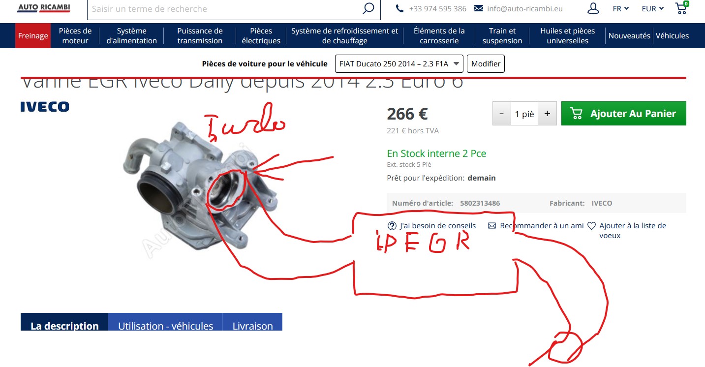

voici la vanne egr basse pression vous dévisser les 2 vis et le diagnostique sera vite fait car elle prendra de l air
de toute facon sur ces modele 2014 2019 LES VANNES HP EGR BP EGR ET PAPILLON tombe rarrement en panne il faut les demonter et netoyer je le fais tous les 2ans a chaque vidange ainsi que le collecteur admision et le cooler sous le radiateur BONNE SOIREE

GOOD EVENING here is the low pressure egr valve you unscrew the 2 screws and the diagnosis will be done quickly because it will take air anyway on these 2014 2019 models THE HP EGR BP EGR AND BUTTERFLY VALVES rarely break down they have to be disassembled and cleaned I do it every 2 years at each oil change as well as the intake manifold and the cooler under the radiator GOOD EVENING

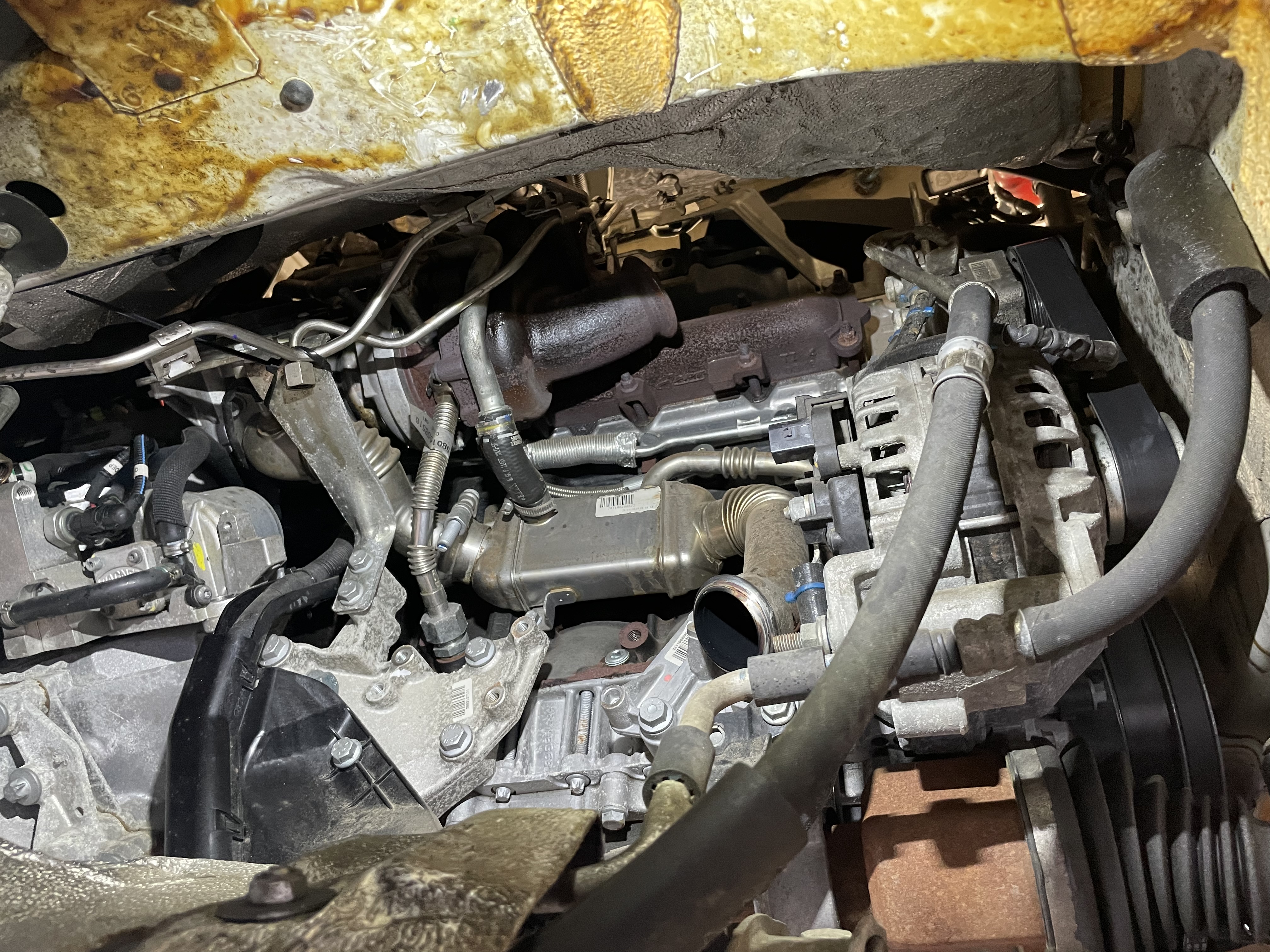

What we actually need is to mechanically stop the butterfly throttle valve that is inside the LP EGR body at the back of the engine.The problem is that it's an all day job at a garage with hoist to even reach the LP EGR as it's a subframe off job. I think we need to remove the butterfly disc from it's spindle and leave the electric motor active. But will it work?
Be interesting if somebody can answer this. From memory the bottom bracket of the cooler is secured with a bolt going into the differencial housing where the Rh driveshaft exits. At this point there is a short convoluted flex pipe to the exhaust connection T outlet. It needs a look underneath from ramps. It to snowy outside to contemplate an investigation daytime at the moment.
You would need to detach this pipe at the T piece end because of accessibility. I have read of another owner outside UK detaching at this point and capping off the exhaust, then adding a mesh filter to the flexi so the LP EGR can draw ambient clean (?) air. How clean is clean on the underside of a travelling van? Ummm
With removed sub frame it looks like this. My opinion, subframe has to be removed……

The photo shows AFTER the dpf has been removed, which proves how difficult it is to reach the cooler and it's LP EGR.
