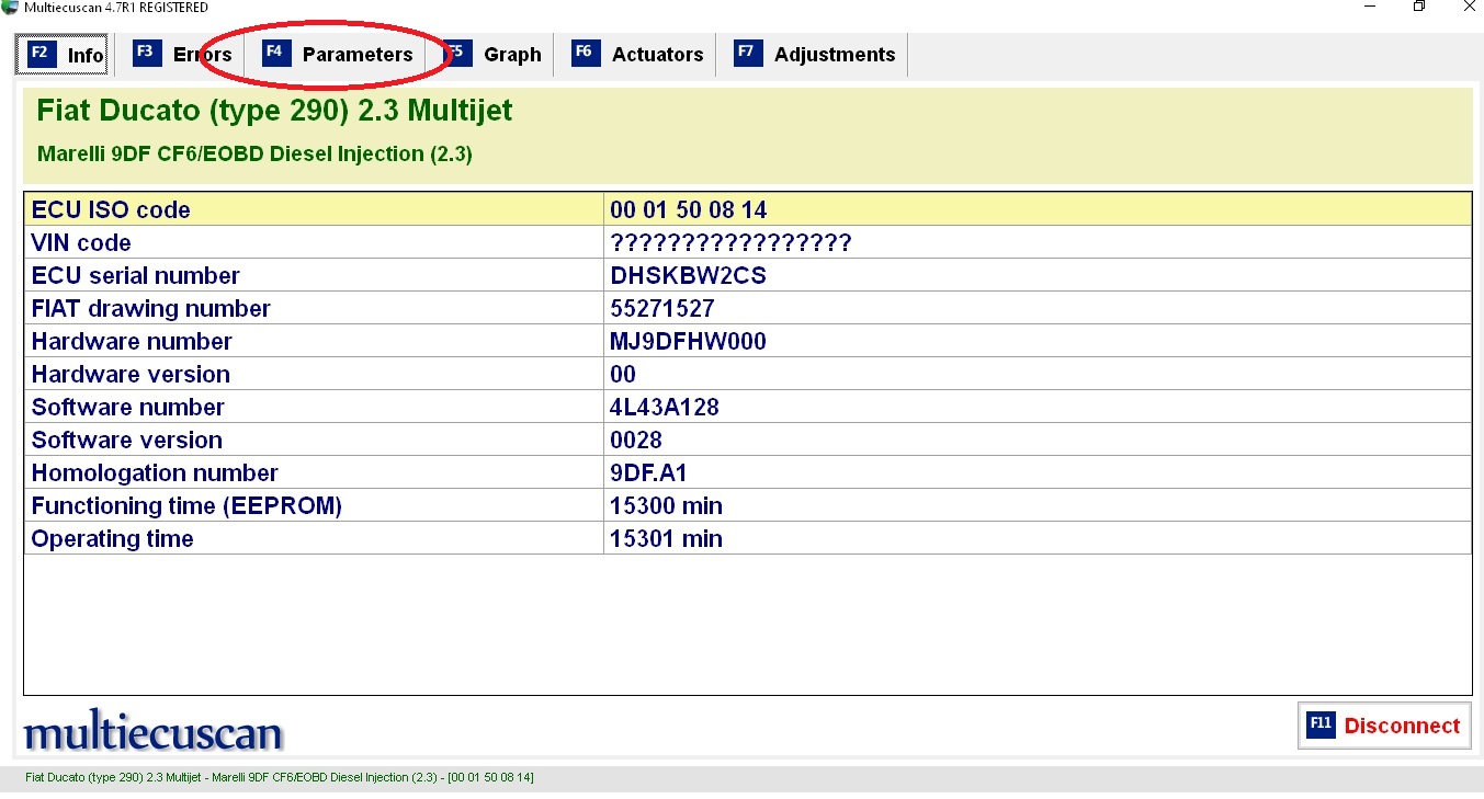

Open Multiecuscan
a page simular to this will open, this shows my preselected values. (Most examples will be from the simulated mode.)

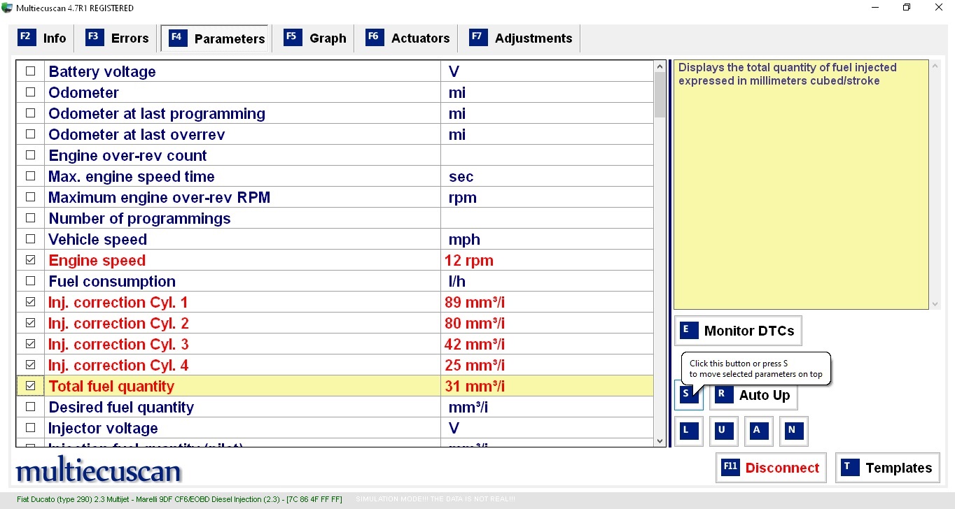

Click on S

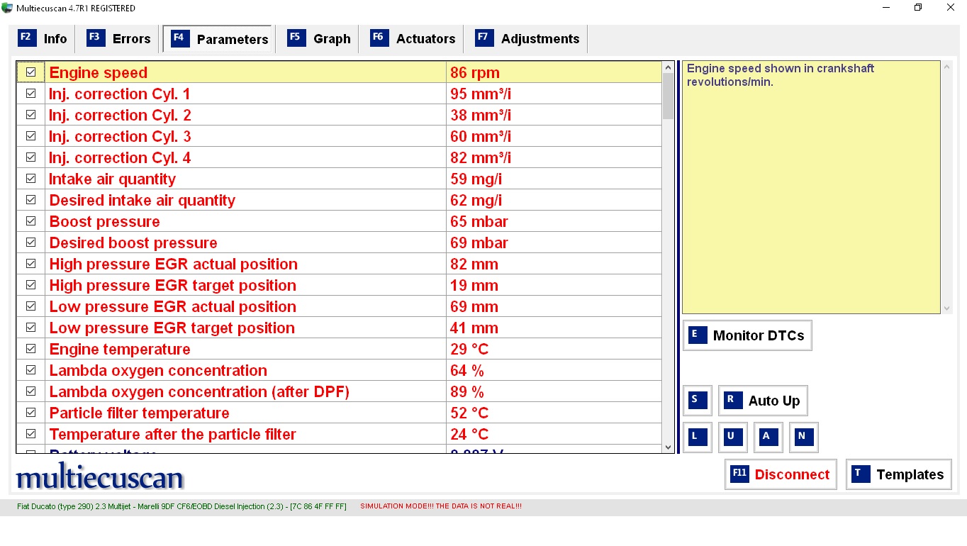

Clicking T shows a list of available templates and Parameters selected.
To create a template select parameters and press Ctrl X (x a number between 0 and 9)
to get a previously saved template press X (required number) on the keyboard.
A selected page can show 18 parameters. A USB serial device (OBDlinkSX ) can record upto 28, a Bluetooth device may be restricted to less . ALfaobd is retricted to 16 parameters.

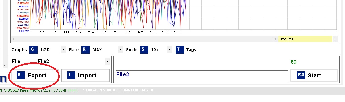

To record values measured click on or press F5. Then F10 to start recording.
F10 to start then F10 to stop.
You now get a screen to save a .csv file to your preffered name and location.
This file can be reimported to mes or any spreadsheet program, and play with to your hearts content. A file in the csv folder is also saved with following name format
FESExp_2205121243_Fiat Ducato (type 290) 2_3 Multijet_File2

Tutorial to Measure specific Engine PIDs (Parameter ID) and Save data for analysis.
Open Multiecuscan

Click on S
