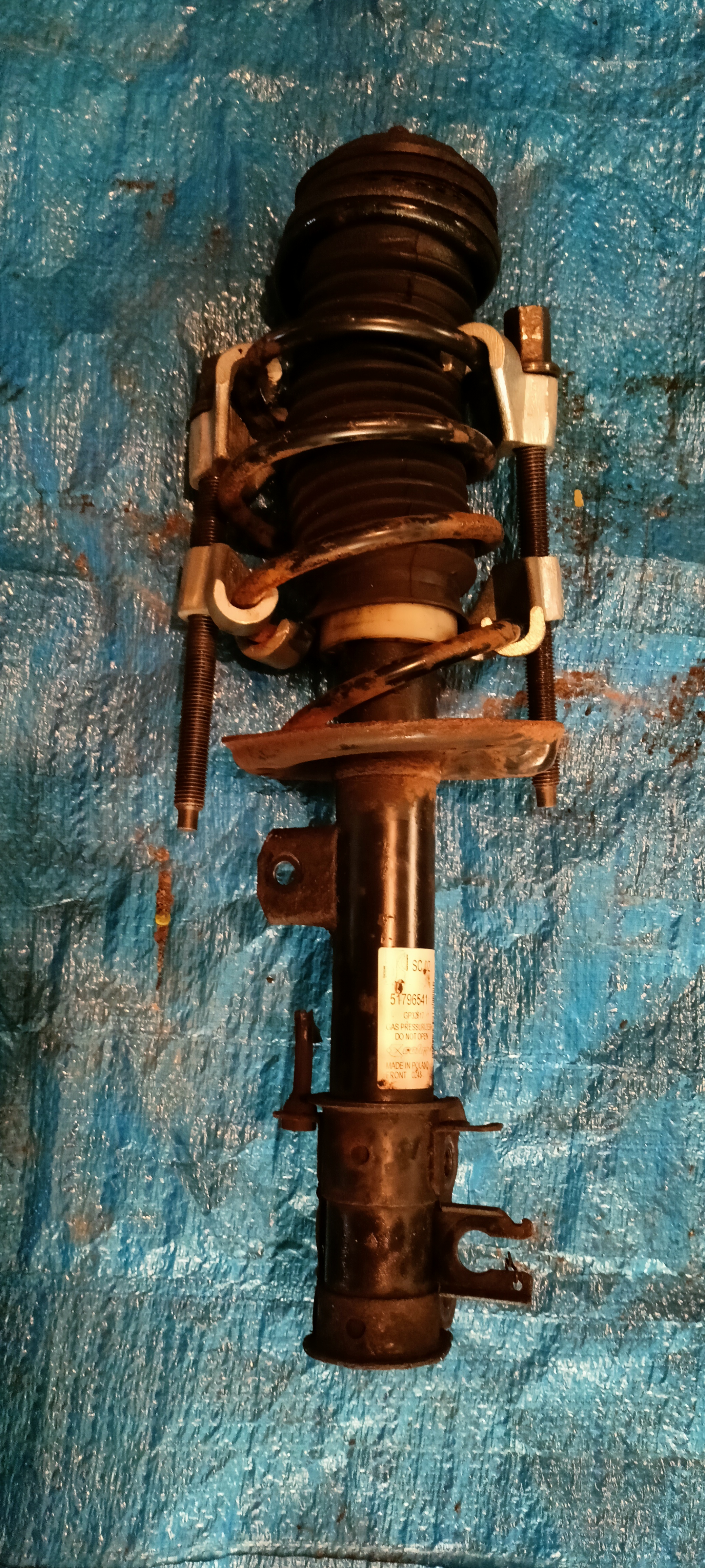

The strut is off. I'm not sure how much more to tighten the compressor nuts before I try to take off the mount? I've pictured both sides.
The straps I bought are a lot more tricky than the compressors, so I can't currently get them on.
Until there's no tension on the top, otherise it'll go ping and probably hurt.
