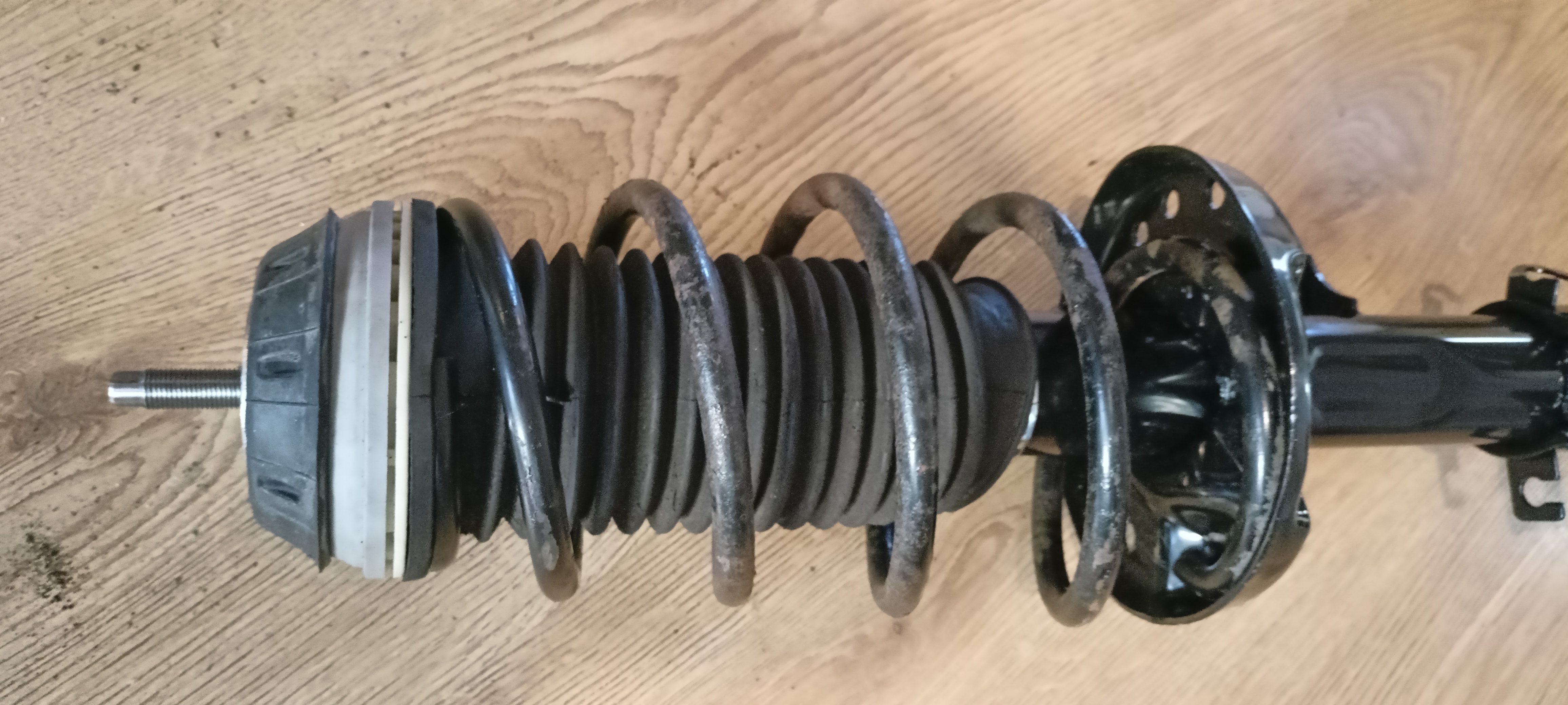

The shock absorber I bought was the very cheapest you can find on ebay, I suppose I know when I'm doing that it requires more labour. I've had to spend ages finding the exact right nut, an m12 with a 1mm thread pitch, they're very non standard in true ebay fashion and I'm going to be waiting days for the nut to arrive! Oh well tomorrow I'll try to preserve my fingers from the angle grinder lol
I think i've switched the spring over successfully. I've taken some pics and a video so you can see if it is alright. I'm not sure how stiff the mount should be, but it feels quite firm.
The old shock had completly failed, I don't know if that happened while I was getting it off, but more likely it is the original one from when the car was new. This means the other shock has probably also failed. Is there a good way of testing a shock without driving the car?
The missing nut came late last night and it took me about an hour this morning to put it all back together again. There were no problems for a change!
I took it for a test drive and the pinging had gone and it all felt fine.
The drain plug next to the strut mount was blocked, so the mount and the shock were taking a bath every time it rained. I've cleared the plug and checked the one on the other side.
I'm still undecided about doing the other front shock. As the plug next to it was clear the shock may be OK. So I'll drive it some more and decide later.

Reading the Haynes manual just now, it says springs have coloured dots on them, these dots give an indication of the length of the spring under compression. New springs might have have two green dots, one on each spring (or red dots if they are different length). If the dots are on the mounts then I'm not sure of the purpose, they've probably been added by a mechanic for an unknown purpose, because my new mount turns 360 degrees. The spring itself has a slot on the strut into which it should fit, mine wasn't in that slot.
Sorry for late reply! Iv done the left hand side yesterday- the spring looked so strange as of it was offset but after sitting the cars weight on it it straightens out…. The spring is seated correctly and a new top mount- feels much stiffer now and no spring twanging noises. Passed the mot yesterday so pleased I did it.
I noticed that too, I was a little unverved until it was back on 4 wheels and could see it looked OK.
