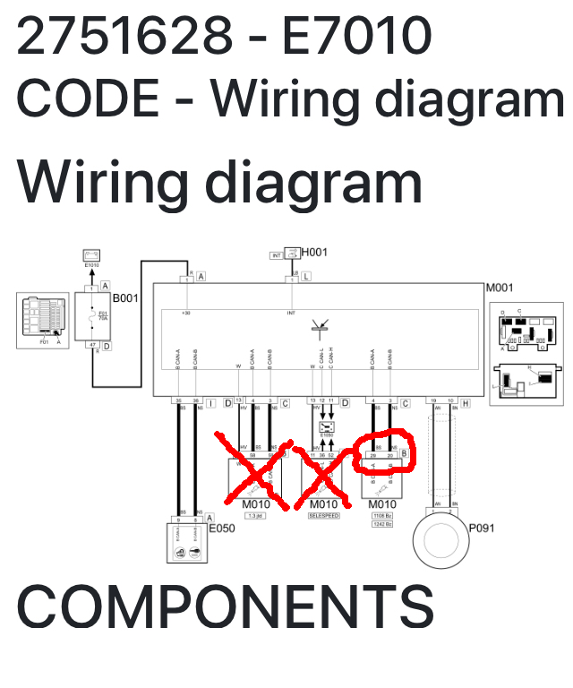

Changing the engine
These are the only two wire that should have been disturbed that have anything to do with the code system
Both on the ECU
You may have to explain the wiring diagram to me here - what am I looking at?
