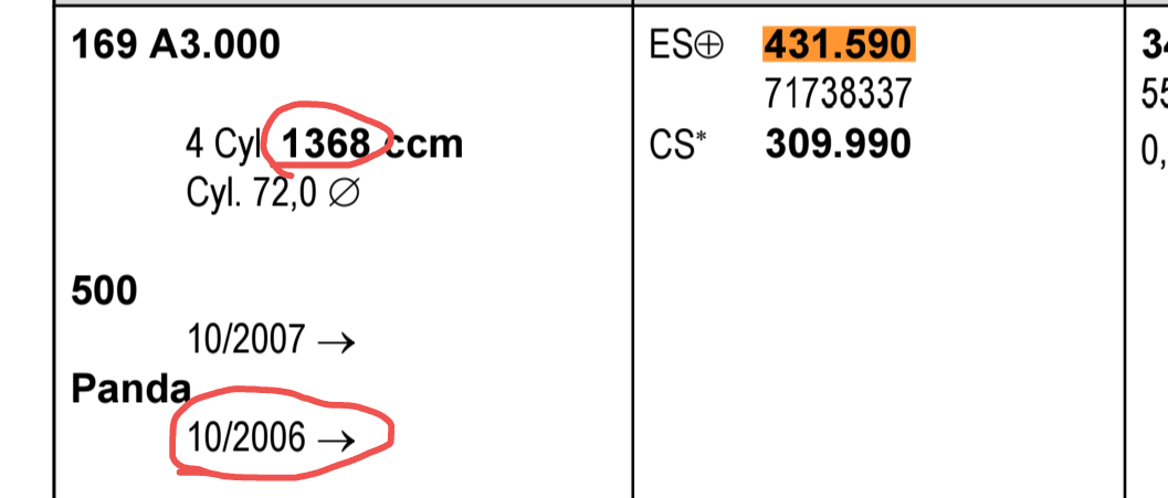

According to elring catalogue it looks to me like there's only one gasket used in the 100hp
Which lists the OEM as 71738337 if you want to try and find a cheaper brand
I have fitted a elring without issue onto a block and head that wasn't in great condition, no doubt other brand will be as good, but not having used them I can't say for sure
