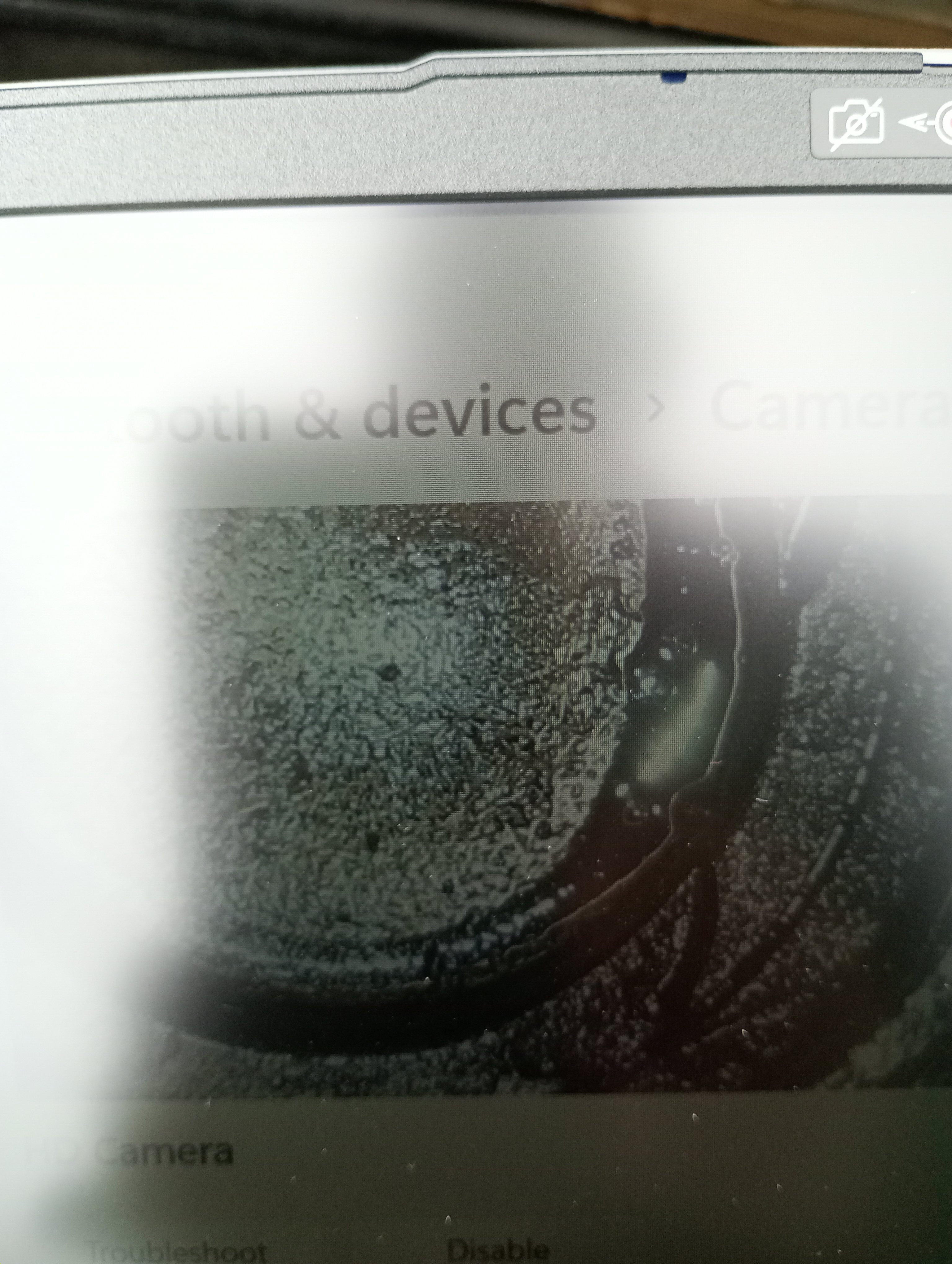

Got the endoscope working. This is what it sees in cylinder 2 where there is zero compression. Not a great image but it's the best I could get.

You are right thats a rubbish pic!! But it looks as if its looking at a valve? If so it does not look healthy. If its running black and it is a valve and there is no compresion it may be a valve burned out. See if you can get any other / better photos to improve the undestanding. Valve does fit with the symptoms (not the water use though) DO you have access to MES? Other sonsor readings may help to narrow things down further. I had these codes on our 169 1.2 60 and it was nothing more than dirty MAP, fouled inlet manifold and dirty throttle body. All is not necessarily lost.
I put the endoscope down the spark plug hole so it is looking at the piston crown. It can't be looking at a valve. I'll have another shot at getting a better photo.
It is very difficult to get any good images. The four above must be showing the piston crown which appears to be intact. So the complete lack of any compression must be a valve problem?
Looking back at my first photo in this thread it looked like there was some sort of catastrophic damage to the piston but moving the endoscope around it now looks ok!

Tops of the pistons look fine in post 7
