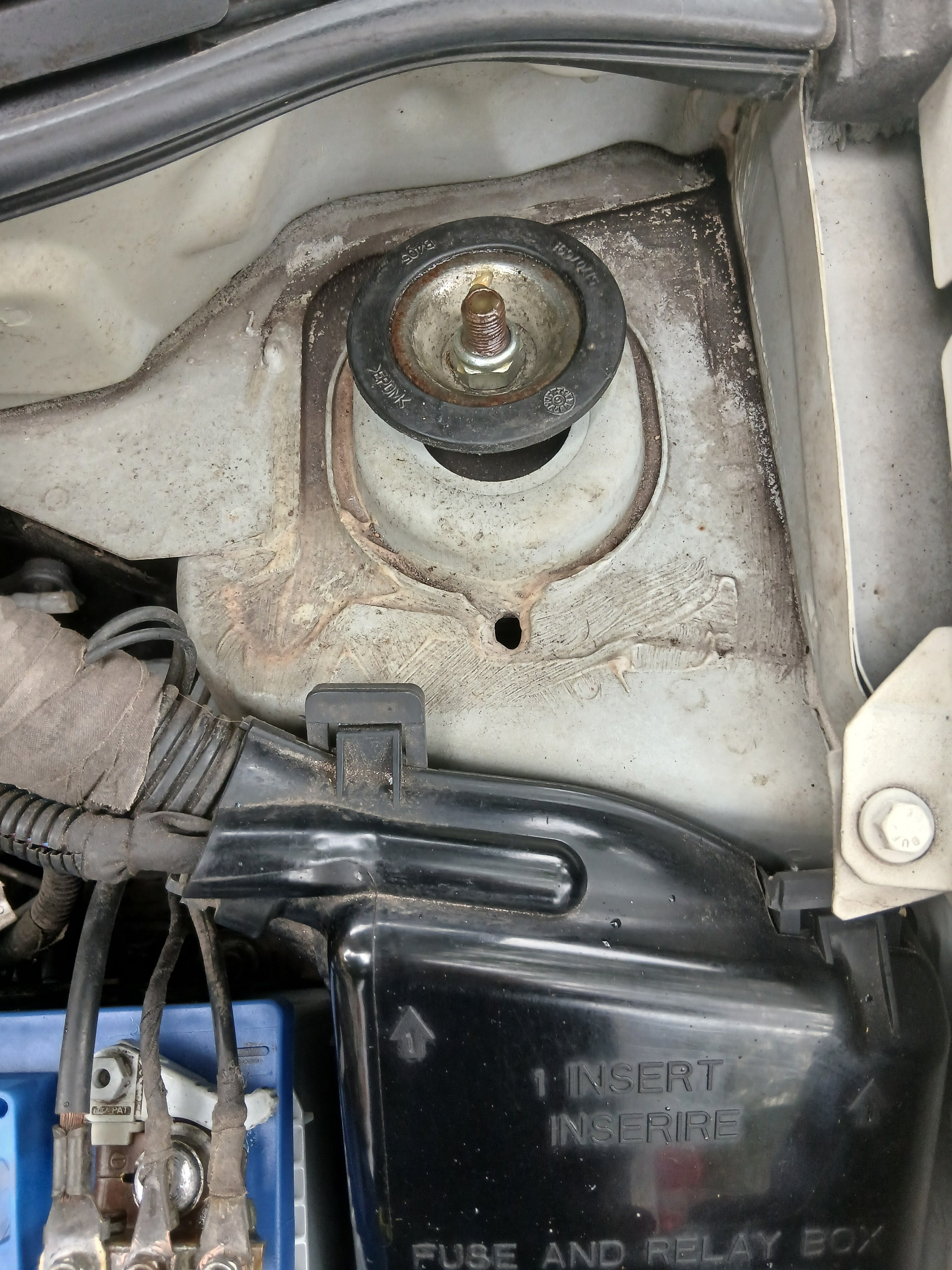

The brakes were replaced not so long ago according to the previous owner, but there may be something wrong here and I will report this to the garage but when locating that squeeking sound I see that top mount do have some room to put forward or backwards when installed (see image)? Normally those things are installed fixed with two, three or fout bolts but not at a Panda? And regarding these images, are they installed properly or are they a bit out of line?

The photos of the gap on the top hat is in fact normal, the top hat only stops the struts falling out when you jack the car or the car it airborne
It's only the weight of the car that holds the struts at the top
As said , normal

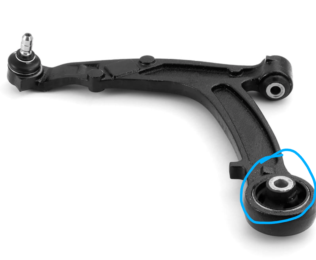

You need to get a jemmy in the appropriate place on all the bushes of the lower arms to see where the play (knock) is , and look carefully for play/movement where there shouldn't be
Pay particular attention to the rear rubber bush on the front suspension arms. The rubber can crack/split/detach and allow the metal of the arm to rattle/knock against the structure of the car.
The gap on the top mounts is normal - as koalar said above - Nice to see someone has put grease on the threads of the shock absorber damper rod nut. These tend to corrode in place and make removal difficult. Again, as koalar says above, this top mount is a "floating" design and relies on the weight of the car to locate the mount. When you jack the car up and the weight is no longer there, the "top hat" is all that stops the strut dropping out of the inner wing. There are no other fixing nuts/bolts like in many other designs. Actually this design is now used by a number of other manufacturers too.

the one in the picture of the swinging arm not highlighted in Koalar's last post was pretty rough, that's the one I mentioned it could be better.
You mean the slightly smaller bush? that's what I'd call the "front" bush. It's much less common to find that one worn out before the rear one (the one koalar circled) so I think you need to take a good look at the rear one. One thought that does occur to me is that, when a new arm is fitted, the bolt which goes through the front bush should only be fully tightened with the weight of the vehicle on the suspension - so it's not wound up when in it's "resting" normal position - If it's tightened with the suspension in "droop" ie when jacked off the ground, then the bush is "wound up" when the vehicle is back on the ground and this causes early failure. If your rear bush is in reasonable condition but the front one is poor, it might be that it was tightened before the vehicle was put back on it's wheels?
Turn the steering wheel so you can see ithe rear bush (blue circle)
Put a torch on it and get someone to quickly move the steering left to right
9 times out of 10 this is all you need to do
If that passes
Put a screw driver, or plank if wood anything, between the subframe and arm and lever it a bit, it will move a bit its mounted in rubber, but it should spring back to its original position instantly,
