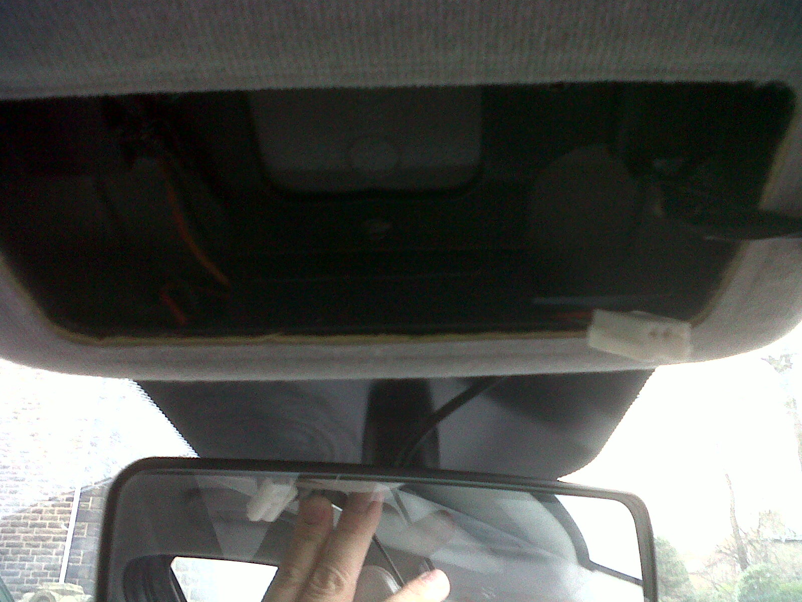

OK I have just finished fitting mine as mentioned above.
One of the cheap £15-20 cameras, but it works.
I bought a 12vDC to 5V DC module of the bay, I ordered one with an integral USB plug but it came as one with just wires, so I actually got it for free after the refund. :)
Soldered a lead onto it, added the compulsory insulation tape too lol.
Took the light unit out and tested a few leads for power.

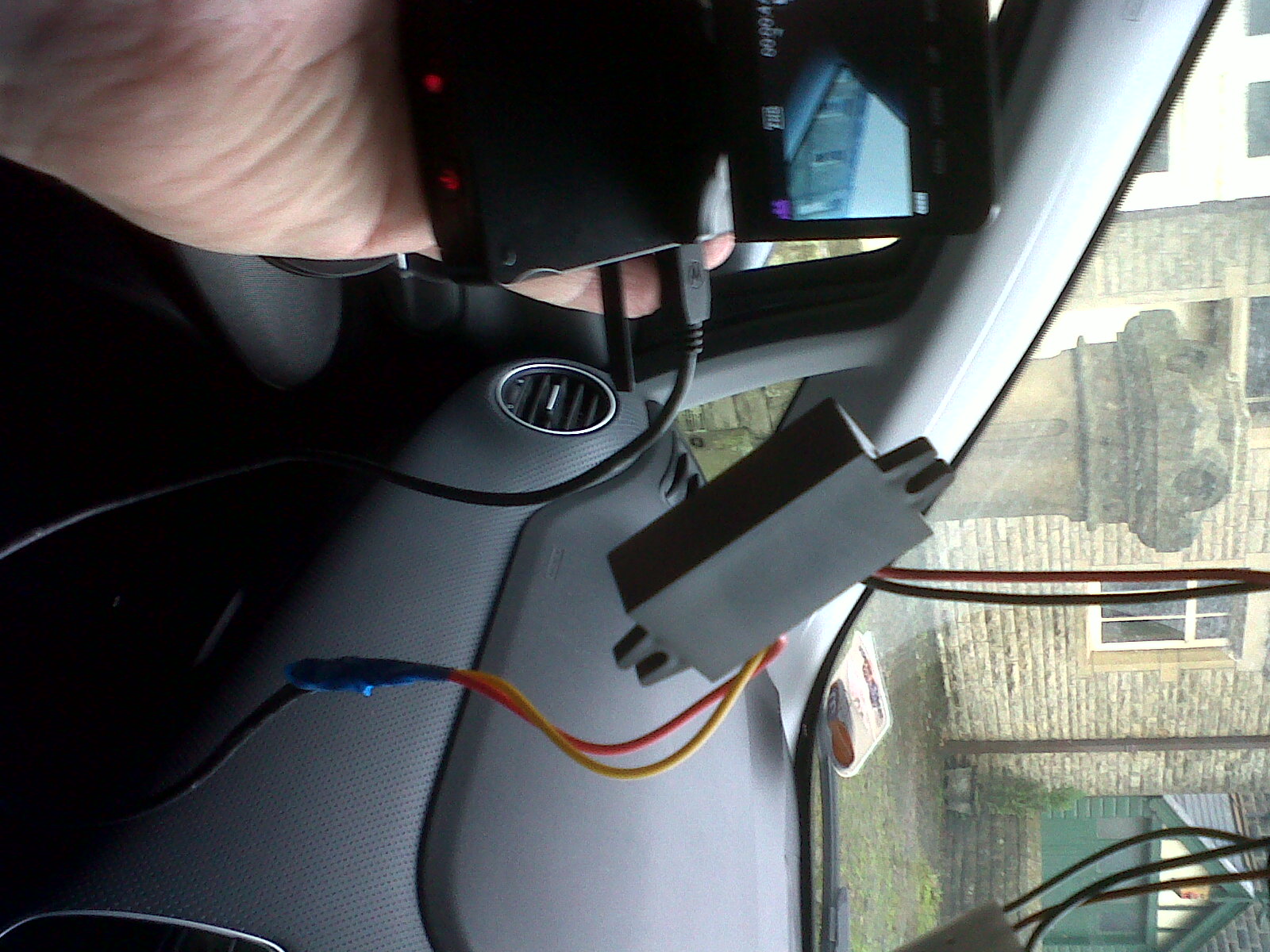

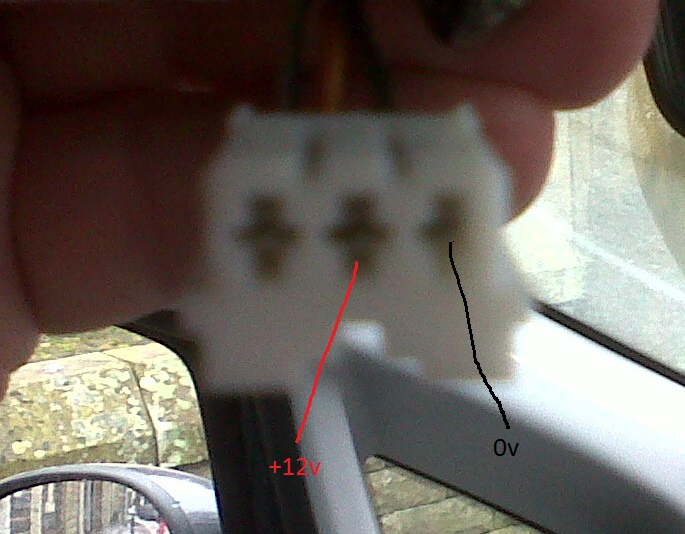

The first pic shows the power connections on the three way connector, used a couple of clamp on connectors a few inch above the connector (mistake - should have been directly at it or a lot further away), so pushed it all up into the space above (2nd pic).
Third pic shows the whole lot dangling.
The camera gets fitted behind the mirror (you can just about see the circle of a previous fitting behind the mirror in the 2nd pic).
Works now, constantly on and picking up passers by with motion detection so constantly filming. Might do something about that - but I can always turn it off with the button on the back.
