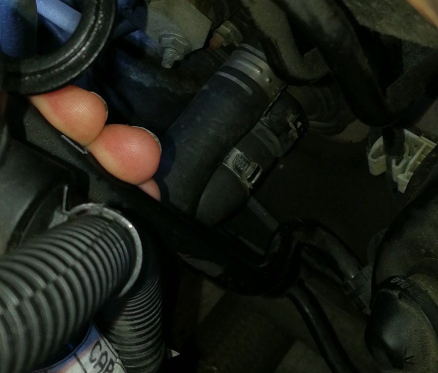

Still no luck in bleeding/draining the heater core. Cant seem to get the hoses off.
I assume the clamps and one-use wonders but the bottom looks like a quick release. Hard to get the right squeeze on it, any pointers?
I'm not convinced you have an air bubble problem. If you did the head gasket would be complaining.
Some OEM clips are crimped and have to be cut off. Other types need special pliers but they also need space alongside to attach the pliers. If access is bad you can cut them with a Dremel disc but be (very) careful to not catch the hose. Also make sure you will be able get a screwdriver (or 1/4" ratchet) in there to turn the screw on a worm drive hose clip.

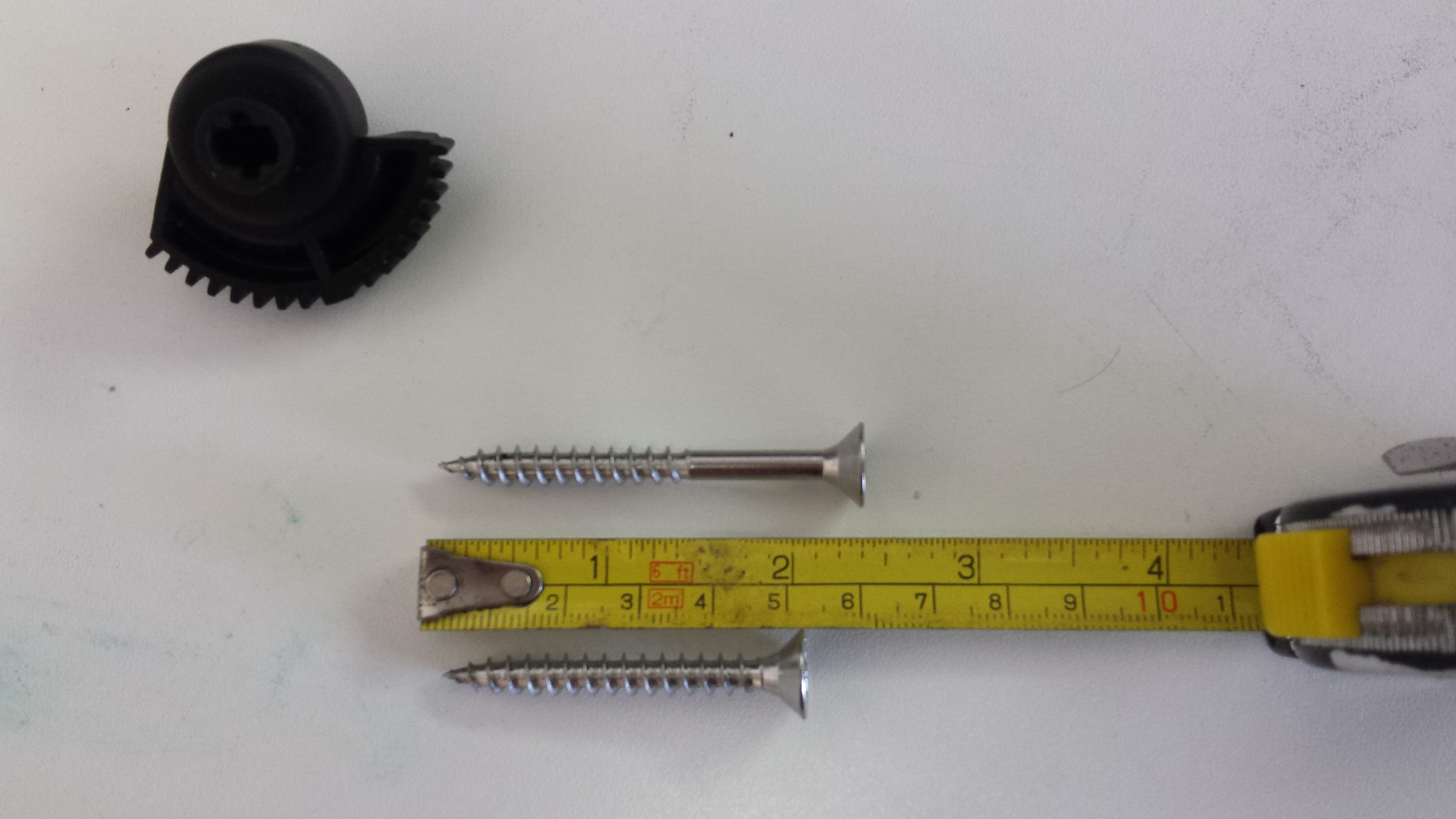

This is a fix for an 04+ panda with climate where the heater flap pin has snapped off.
note 1. there is no need to either get or look inside the heater box.
2. avoiding turning on the ignition while the cog wheel is disconnected from the flap motor may keep the motor in sync and obviate the need to reset the climate system.
3. apart from the pin this is a robust and strong flap and takes the self tapper very well.
4. the teeth on the cog wheel perform no function whatsoever.
5. with practice, before removing anything, it is possible to reach carefully over the top of the flap motor and feel if the cog wheel is anticlockwise against the top stop when it should be blowing hot air. if it is and you are getting cold air the pin is almost certainly snapped. You can also check the movement of the cog wheel by changing the temp. setting just remember it doesn't react very quickly.
6. do not force the cog to turn in the motor, it contains a double worm reduction drive and won't accept reverse torque, if you have disregarded 2 above and need to turn the motor socket to realign the cog wheel it can be done with a 9v battery connected to the pair of pins in its electrical connector, be careful not to short anything.
7. The flap only has an operational arc of only 70 degrees or so and is also limited by the gearwheel stops on the heater box and the stop on the outside of the flap motor. Internally the motor will go around all day hence 2 above.
8. The self tapper/chipboard screw I used was 50mm by 6mm max thread diameter with a 12 mm head.
Here goes, remove fuse box cover(2 philips), steering column lower cover(3 philips), gear lever gator(prise upwards), gear lever surround(2 pozi and prise upwards), RHS footwell panel(2x 5mm allen), lwr. gear selector panel(2 pozi + 2 allen). Then remove dash bolts from inside fuse cover, under dash panel by left shin and in front of gear lever. strap dash panel back to seat frame and you should have enough access.

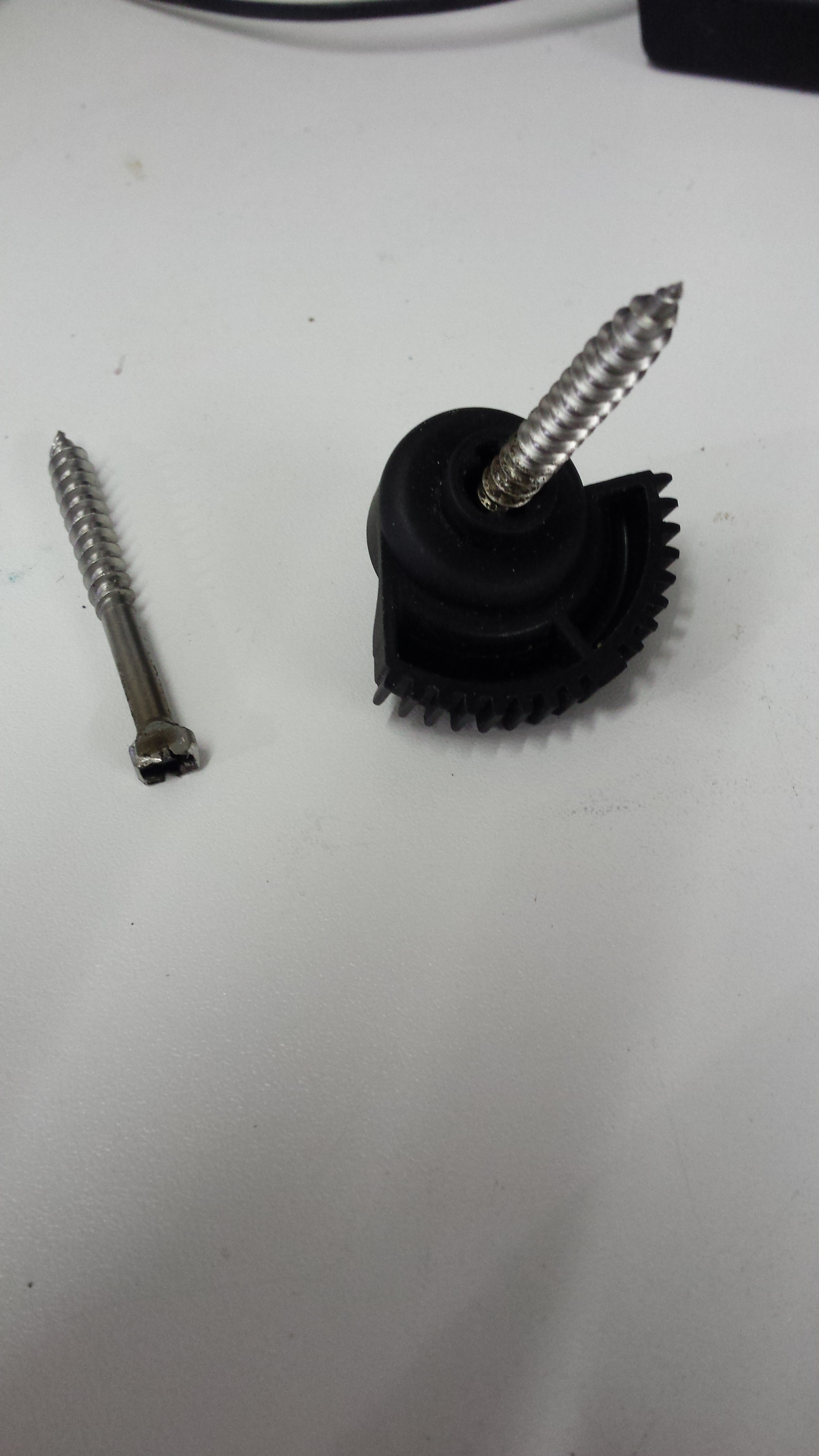

Remove the flap motor, a square box held by 3 very small hex bolts. The cog wheel is held between the motor and the flap pin by friction only. If the cog wheel has a small piece of plastic stuck in it you have found the problem(Google “panda owner loses cool”).Remove the remains of the pin.
File or grind the head of a suitably large self tapper to fit the socket of the gear wheel. Drill small (maybe 1.5 mm) pilot hole straight and square into the flap through the hole where the gearwheel fits, drill hole a little low as the flap is centered by the pin and gearwheel. Insert self tapper, the philips head on mine worked well until he last few turns when I used a pliers.
Test with cog wheel and adjust screw rotation until cog wheel can rotate fully between both stops. Mechanically this is very strong, the tricky bit is getting the pilot hole straight and not too large and synchronizing the rotating parts, once again see point 2 above.
Straying outside my area of expertise, the climate reset procedure involves pressing auto and windscreen defrost buttons together soon after switching on the ignition, possibly with temp on lo first, holding until temp reading stops changing and waiting while it self tests.
Good luck.

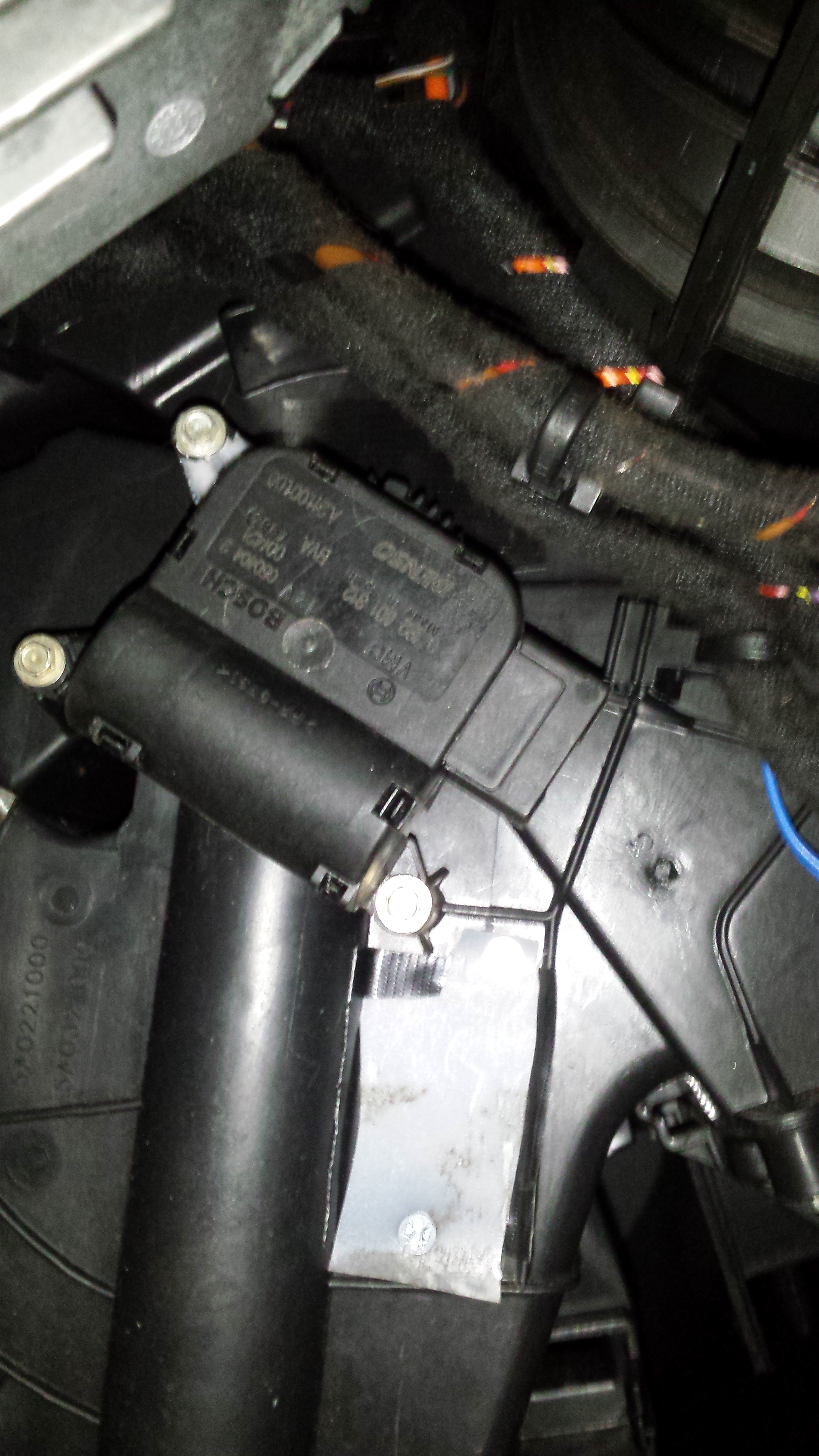

Just to add a note to my photos posted above,
1, Inspection hole cut in side of heater box, that's the heater core in the long bulge to the left of the hole so watch it! Aircon condenser just visible upper right, flap in up position so air is directed down to the heater core.
2. I used the shorter screw for the fix.
3. The screw fitted into the back of the cog wheel.
4. Filed screw in place, hole covered with tape and plastic patch
5. Everything back in place except the motor connector.

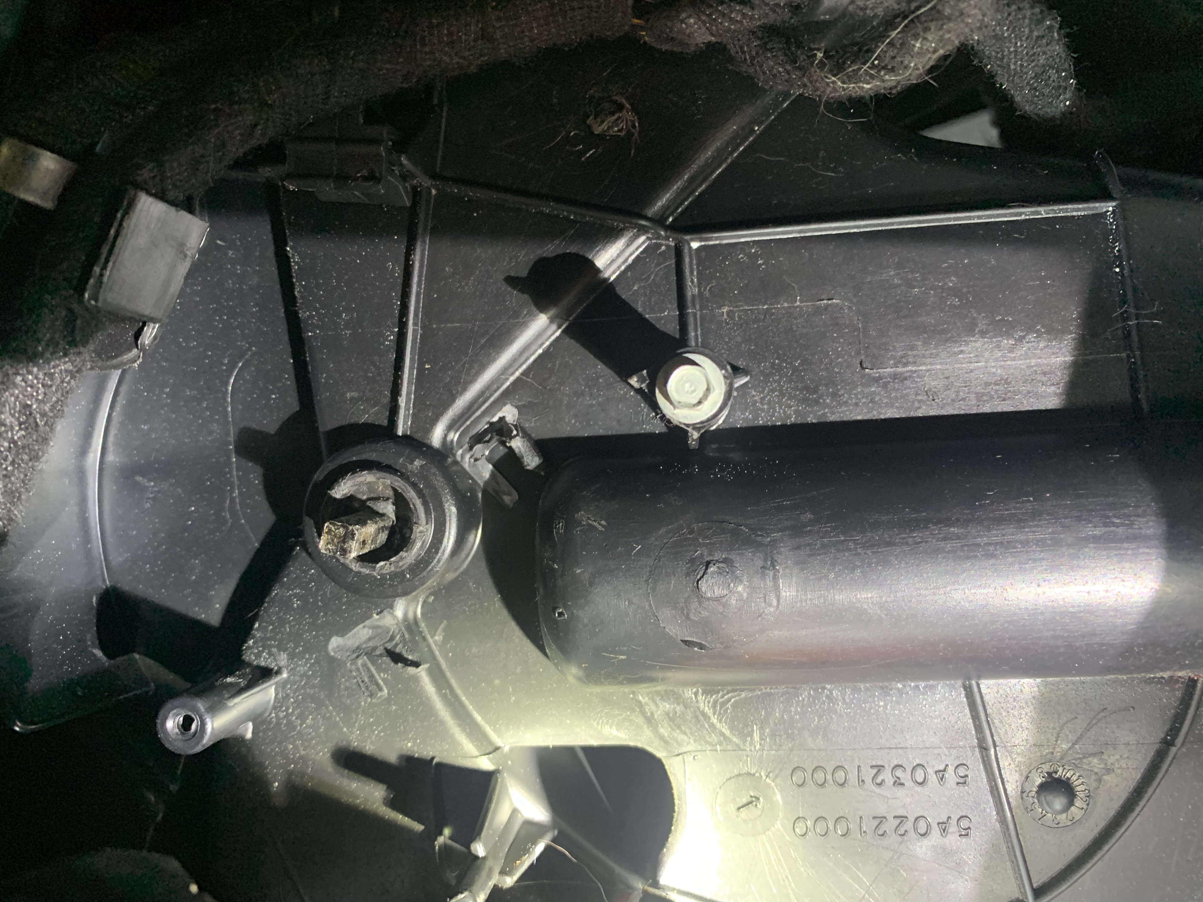

Hi pal
Been reading your thread and think I have a similar issue but think someone has attempted repair previous the pin is metal but doesn’t look central to hole also when you rotate the pin is turns on an axis/arc shape
Also the motor connections are snapped don’t know if this is caused by the axis?
Maybe I’ll have to try to reposition the pin?
Any help much appreciated, also don’t know if you had this issue but cannot seem to alter direction of blowers just seem to come out of vents

The pin you show will not be a spindle it's be fitted to pin the arm to the air control flap. You will need to follow the instructions by Panhardrod to cut the box to align the flap with the lever and probably fit a new pin/screw/whatever.
Access will be a major pain but the alternative is dash out (see the Pandamime video on YT) followed by the car doors off to remove the structural frame underneath and finally get the heater out.
