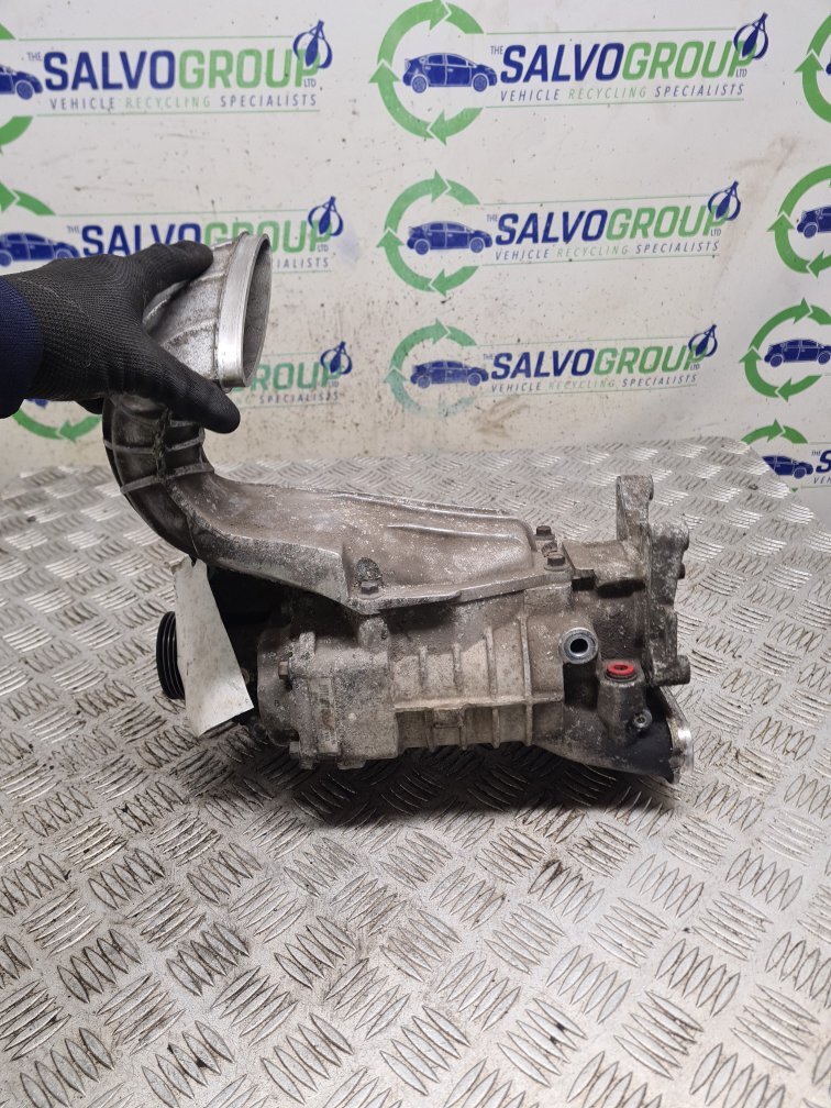

There's also the mini Supercharger that could be adapted!?:censored:
Thats not even a bar my T4 goes to 12 psi and thats a Diesel. I dont really know anything about Superchargers apart from they work better low down.
