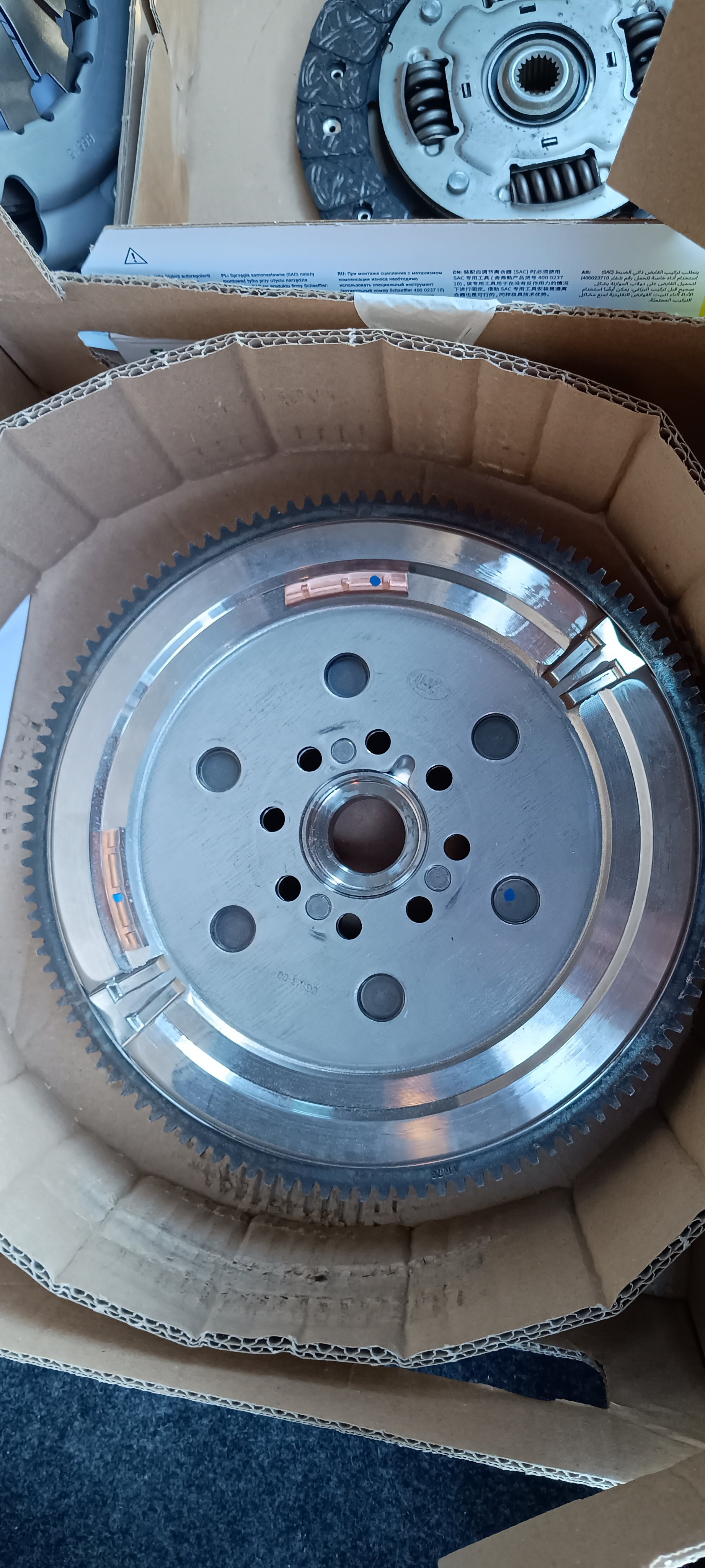

Picked up the non DMF clutch kit then booked car in. They said i need both kits before they would start the job and I can return any unused bits.
Went back to buy the dmf clutch kit and explained the situation. The parts guy was a bit confused as the dmf clutch kit was no longer in stock. Then he replied he had solid it to me already lol
So he sold me the DMF and mounting bolt kit for slightly under £340.
I'll ask for the bits removed before they start as im interested in the old clutch & DMF condition i(if we have a DMF.
Some pictures of my panda boot (input shaft & dif seals due Friday)...
£340 sounds like a result. This is the kit I would fit if disaster strikes Noop. LUK supplies some of the original clutch parts if not all so just as good as Fiat bits.
£340 was just dmf and mounting bolts. Clutch kit was another £120..
There is a kit that contains both dmf & clutch kit that's slightly cheaper but seems to be impossible to source (probably nla).
But had i got the full kit and then found a solid mass flywheel id not be able to get a refund on the unused bits of the kit (the DMF) so then what?
