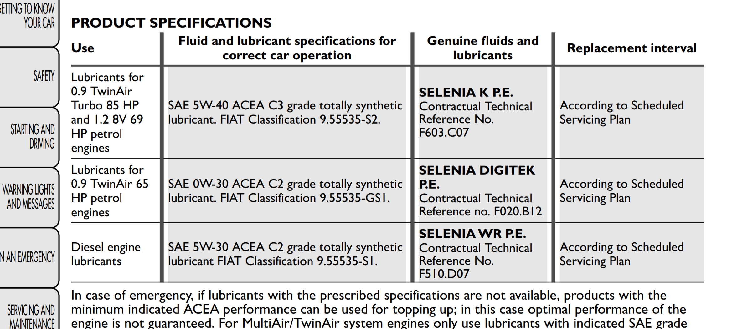

Well here are the oil specs from a 2021 owners handbook. It still says 0W-30 for the Twinair, but 0W-20 for the 1.2 8V 69HP ! Really I would just stick with what it says in the book that came with your car.

Note the warning at the bottom of the about oil in the twinair
