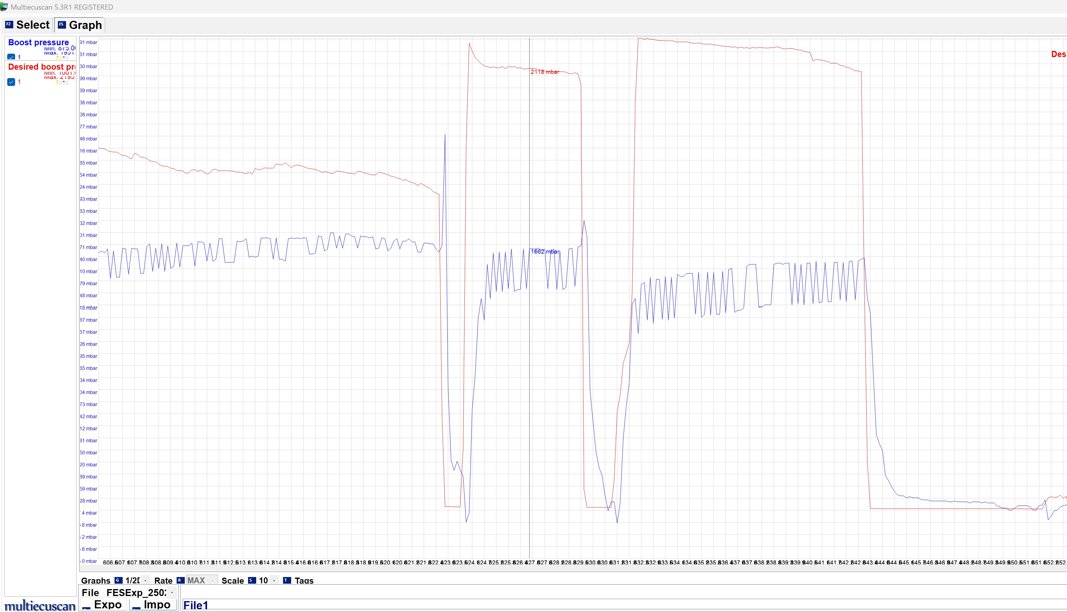

Well I've done some graphing.....
This one seemed to be quite typical where actual boost was running a long way under desired boost.

I assume (correct me if I'm wrong), I'm not getting enough boost generally? And it seems to me, the most likely explanation for that is probably that boost pipe split?
Unfortunately I cannot read the scale on the left of the screen so difficult to know what the difference is between the low and high points. The jagged nature of actual boost is wrong, should be a smooth line. Can you load check the pressure difference between the two and post values?
Annoyingly, I can find no means of dragging stuff around so I can see the full scale. I think this might relate to having this on 4k laptop. Though everything else seems to look normal. If anyone has any top tips on how I might actually go about reading that scale, I'd be most grateful!
Mmm. Should be much closer than that. You are getting about 10psi of boost and the ecu is expecting 16psi.
I will try to get a graph reading tomorrow from my Cross to compare with yours to get a baseline. In the meantime you may as well wait until you get your new hose.
Thanks. Hopefully it is just as simple as a boost leak from that pipe. I guess if that doesn't work, I'll need to look more closely at the turbo itself.
