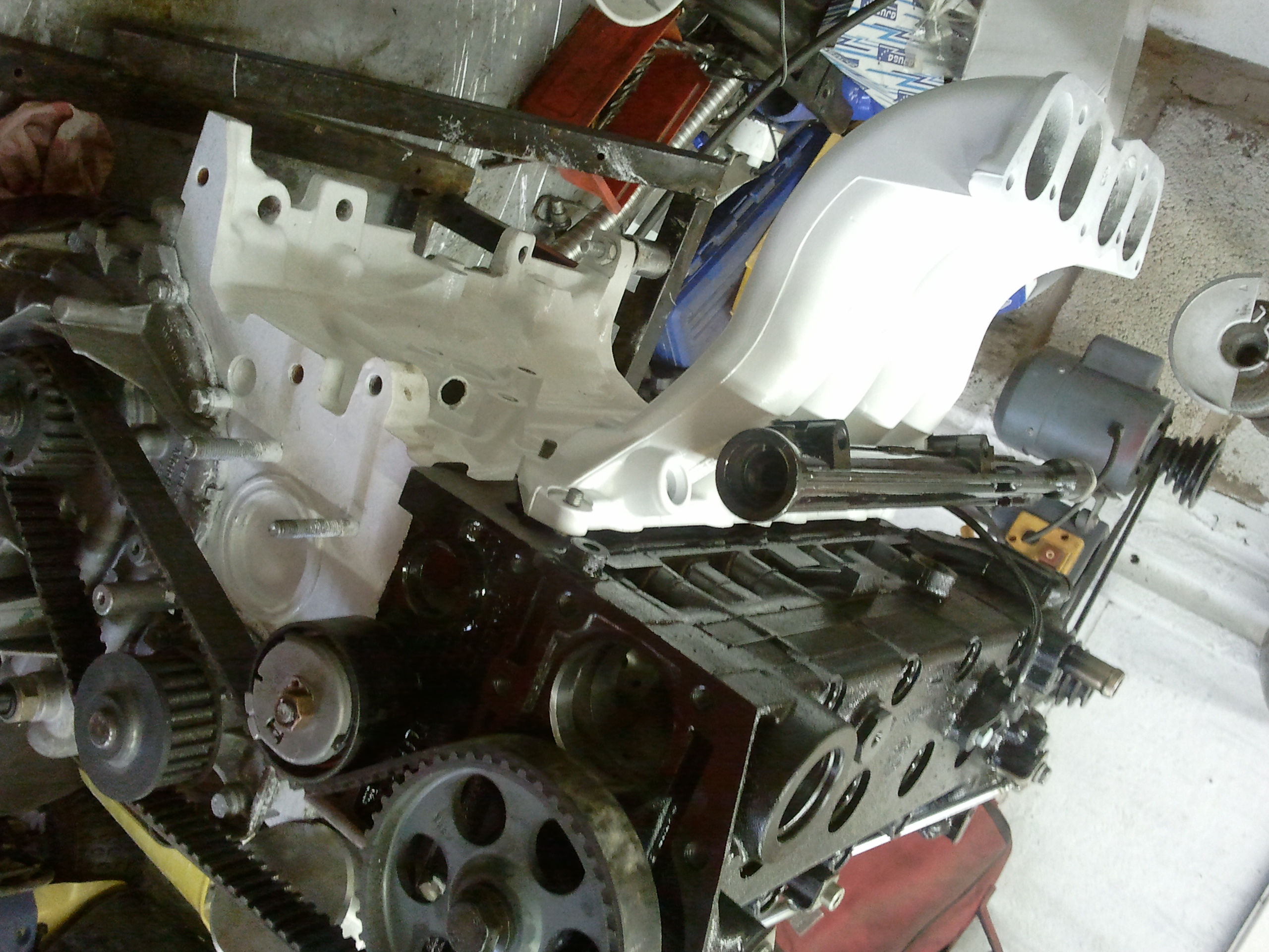

so today I got out the head and carrier ill be using jet washed the crap out of everything, used a bottle of oven cleaner to remove the gummy old oil and carbon.
then spray painting everything :cool:

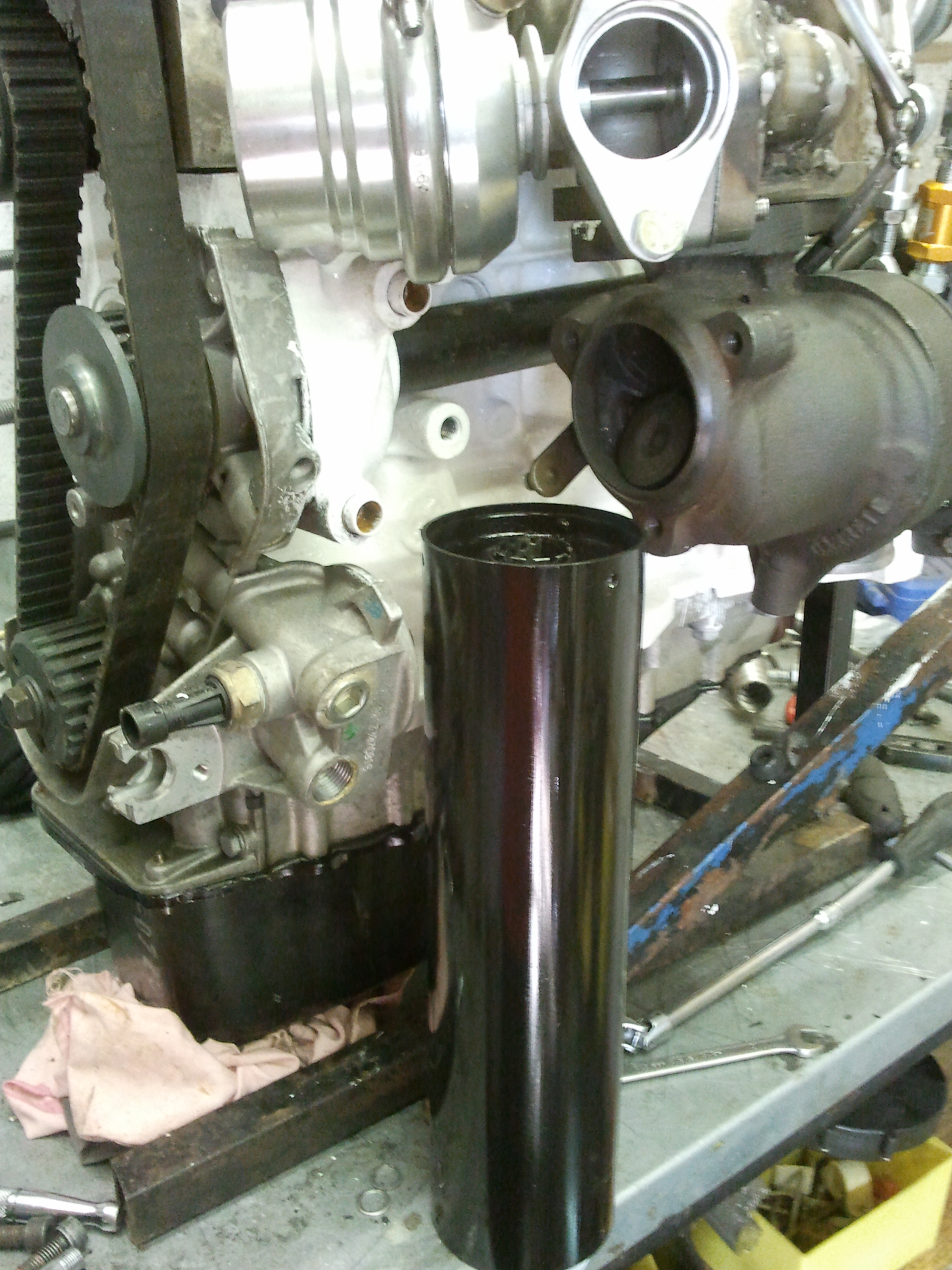

Also received a nice little silencer with a one inch bore. (y)
so gave this a quick spray.
bolted it all together with old gaskets and bolts just to check if everything fits fine (lot of close fitting bits on the manifold that i worried will hit stuff once gaskets are compressed)

I was testfitting my turbo this week to see how far it woulf stick forward from the engine.
Now I see these picture I guess my 1.2 8v with turbo must fit in my seicento.
Seems your turbo is sticking more to the front then mine.
Still I need to get my engine prepared, it's just waiting until the funds are there haha.

I would check the measurements again if I were you. This is because I am still convinced, despite what Craig said on a number of occasions, that this construction of his will not fit the Cinq engine bay :devil:
Well, that and the bumber, which might be a limiting factor too. BTW, Seis seem to have so much more space... (Envious)
come on dude have faith lol. from the measurements and eyeballing my mates 16v cinq it should fit.
there is more space at the top of the bumper then at the bottom and most of the bulk of mine is up the top.
the turbo is the same as what Jason has on hes 8valve cinq and hes fits... the turbo(flange) is a couple of mm from the water pipe that runs along the block so unless he relocated this pipe then hes should be the same distance (infact mine should/could be closer as i built it as close as i could and not limited by the chopped up cinq cast manifold he used)
time will tell but im not (to) worried. ill "make" it fit :)
