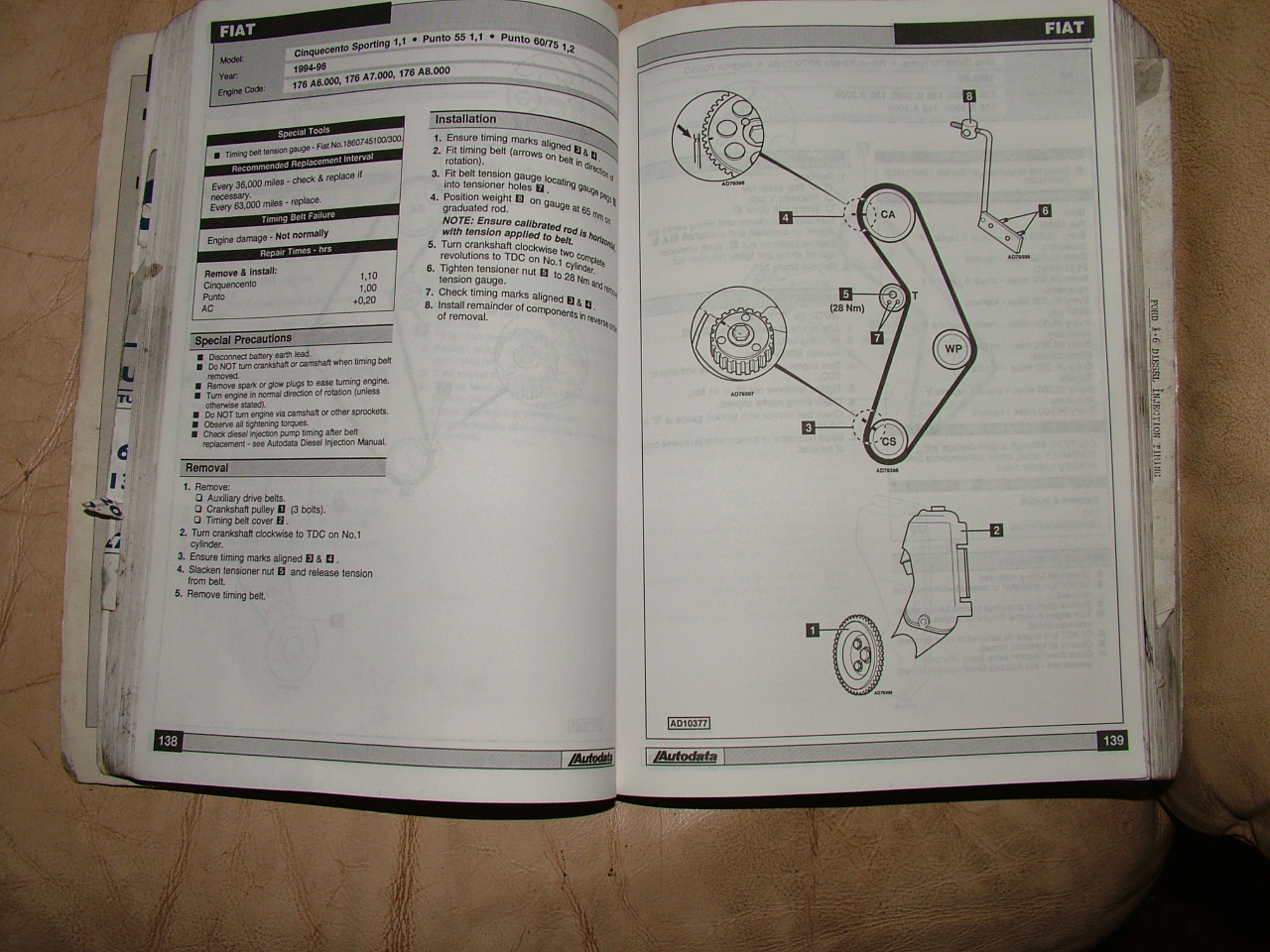

Not sure if much help , but see what you think. In my AutoData Technical Manual it lists the 187A1000 so I have included that information any way.
In my Timing Belt AutoData Book there is this about the early 1.1 FIRE engine on two seperate listings, but without your Engine Serial Number. So you will have to see if it looks relevant or not. Maybe other Forum members can confirm.
Thank you a lot bugsymike!!!
Very helpful!!!Thaks again bugsymike you are great 👍
