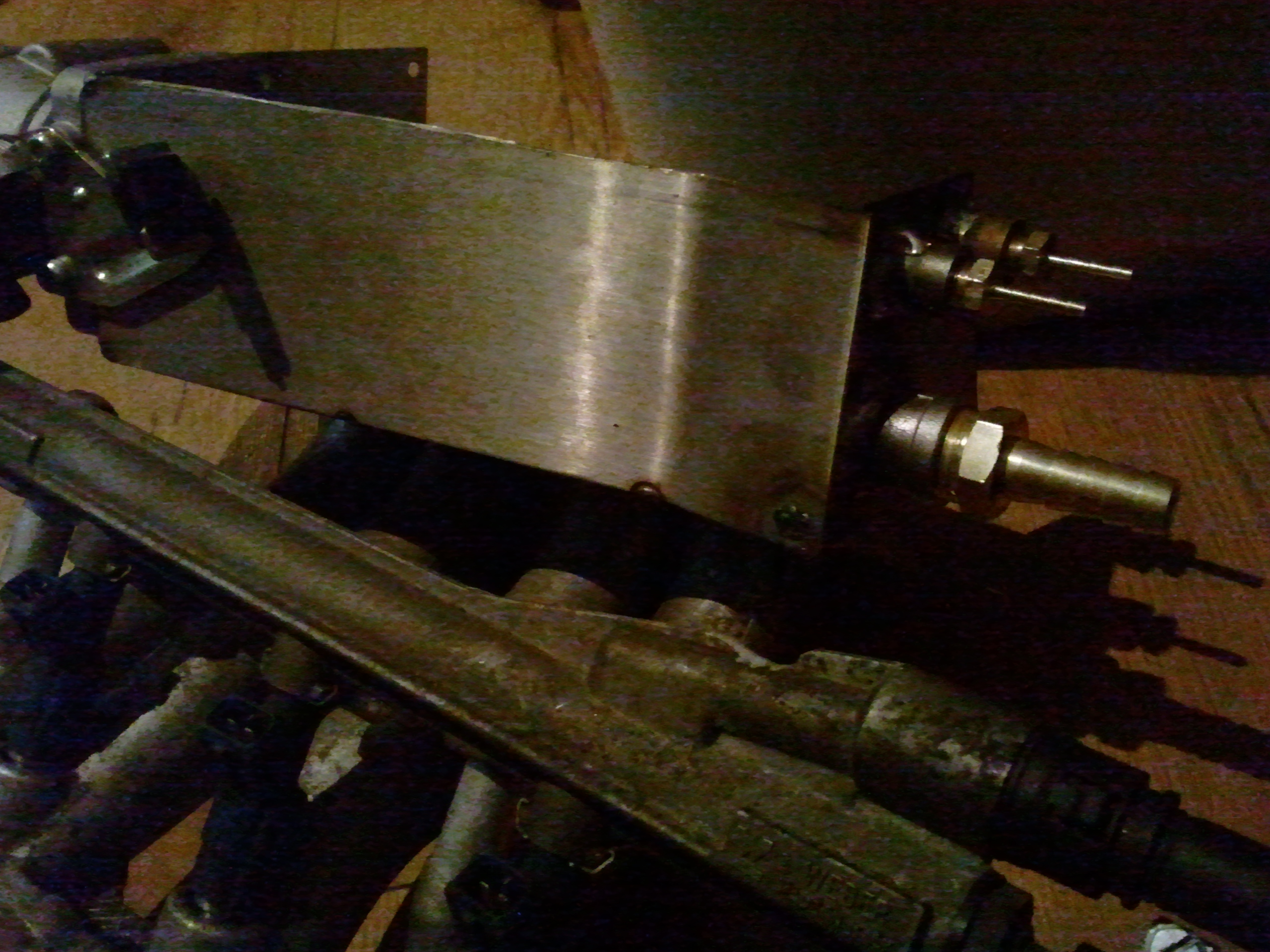

the manifold looks like its coming along nicely!
been prepping matts car for a respray tomorrow so not much progress. welded inserts for the vacume feeds and brake solenoid onto the end plate of the manifold. need to order an extra now for the antilag :(
