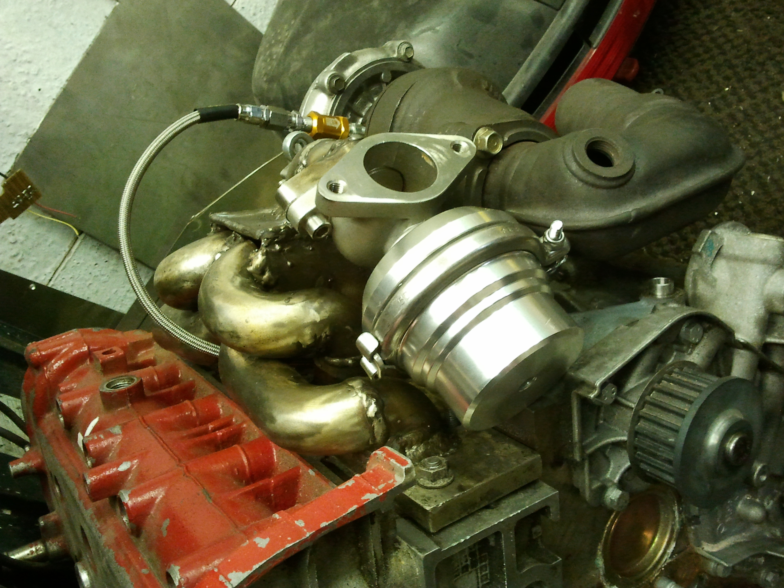

got a bench sander so fixed the warped flanges. so back to welding. man its a tight fit. have about a MM from the wastegate top to the block and about half a mm from the waterpump!

well the manifold is complete (just need to pressure test it for leaks) and ive been thinking...
the intercooler is going where the radiator is and so with the standard intake manifold the boost pipes need to go across the engine bay. meaning at least two 90s and one 180 which cant be good.
plus tubing will be twice as long as it could be and running an a cramped hot engine bay
sooo... sitting in my garage is a a large sheet of 2mm stainless and a couple of smallish sheets of 1mm stainless. nearly 1 full bottle of argon and about half a kilo of stainless wire left...... oh and a perfectly sized and shaped 54mm throttle body
