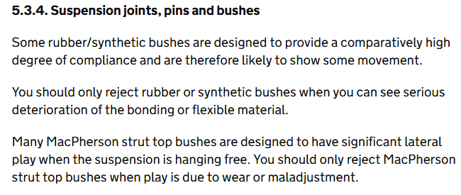

Although... I have heard of MOT testers failing cars because the suspension leg moves when it has no weight on it. This should not fail the MOT, as it is designed to do that.
You could try adding some extra grease to the next set and see it it helps.
:yeahthat:
and the MOT testers manual makes this quite clear.
