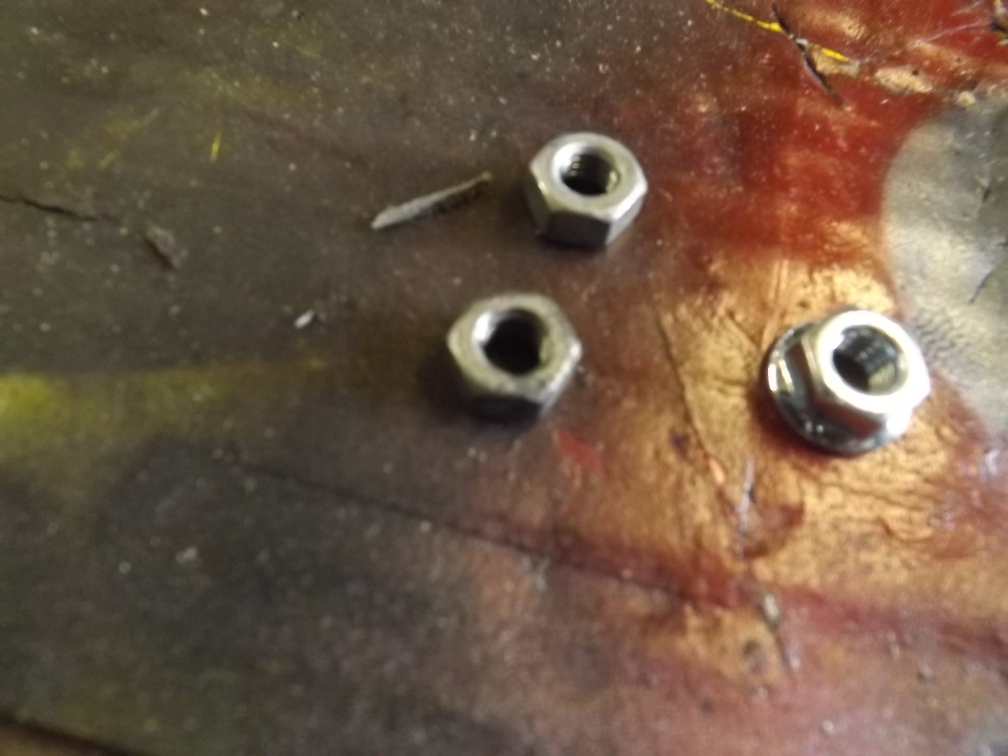

In the meantime, to facilitate easier reinstallation I have used shouldered nuts as with them it is point and shoot. lol I use them a lot on fiddly jobs like my mobility scooters for example.

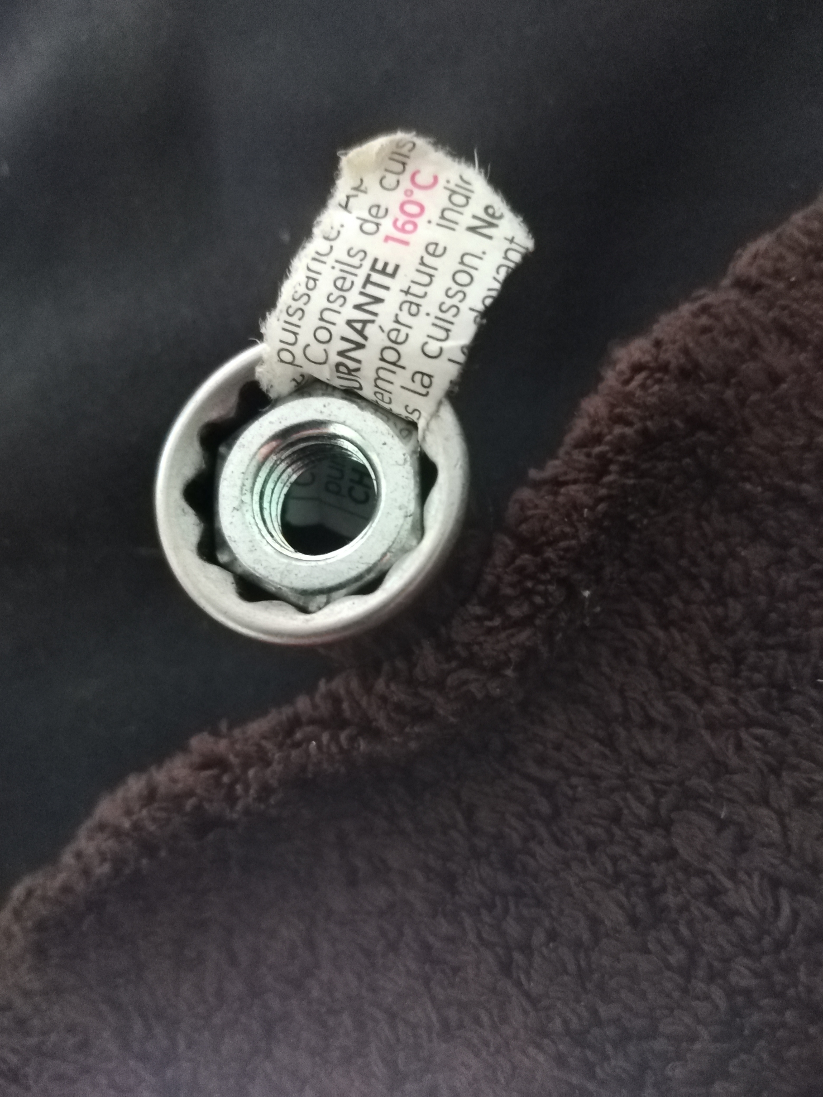

I find it helps to wedge the nuts onto the socket with carboard
Nothing worse than one dropping behind the carpet
Tried magnets, bluetac in the past, this has worked best for me
