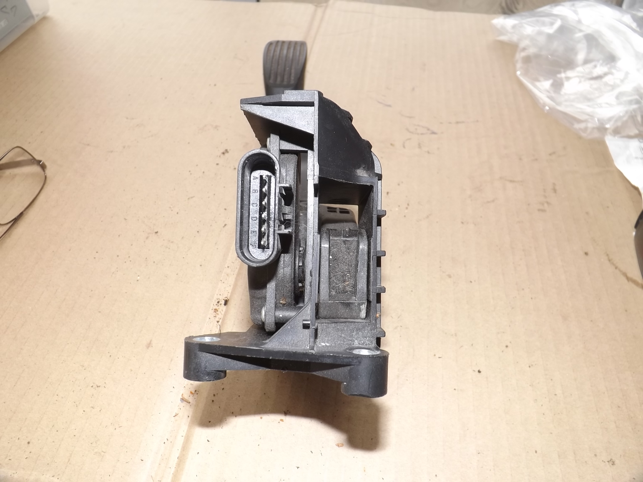

Can't see too well, I suspect it will just need cleaning here and the codes clearing
I'll take another but the pins look OK to me. Actually, close up, two pins look a bit green so a clean up is in order. I can use some electrical spray cleaner I have for jobs like this. Then I'll refit and call it a day till it goes into the shop.
Pics were no good.
Pics were no good.

The kangarooing and warning light likely to be dirty connector or dirty/damaged/dusty track/s inside the pedal
Nobody can tell you which for certain
Changing will mean if reseating does not work you don't have to go back and take the pedal off again and is a sensable option
The potentiometers inside the pedal sensor were corroded.
