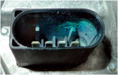

Odds are the contacts on the side have gone green and corroded with a bit of damp, I did one of my cars years ago, it would be worth disconnecting the battery negative first, I don't know if you can unplug the connector insitu as I had already removed the pedal, but can check latter for you, unplugging and plugging the connector a few times will scratch the oxides off. Some switch clean would make the repair more permanent

but you you can remove and reseat the connector without undoing anything
for me it quite an easy job, less than a minute, however i have done load of these connector before
i suspect if you haven't it might be a struggle, once your hands on the connector it blocks the view and it has to be done by feel
the connector is at the top, on the lefthand side of the connector the is a tab you have to lift a few mm, on mine it off white, grayish , this then allows that side to push in and the connector to pull off
here not a great photo not mine of the corrosion on a 500, we use to see a lot more before the problem with the scuttle drains became well known
