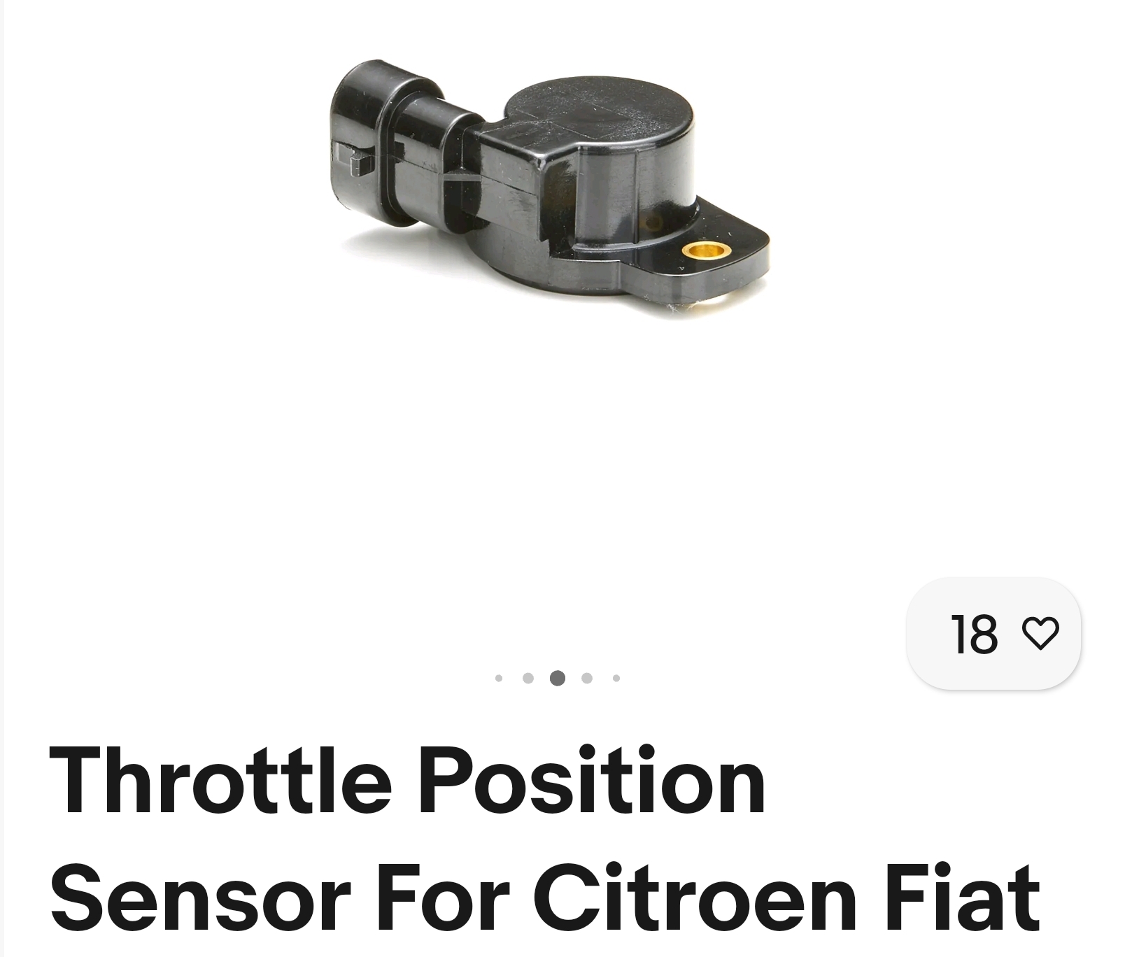

Thanks...The AA mechanic just said fault coming up and the part you need is a Gear Range Sensor said its pretty easy to do just 2 bolts and it's sat behind a metal pipe....

I am confused
First post is a Throttle sensor
Now gear Range sensor
And in the Qobo it's TPS again
They are completely different
But neither difficult to do
Gear range sensor he said but I couldn't find anything on ebay or google which said that so is the TPS Sensor different I'm lost at moment He said it was located down right side of engine the other sensor located on pedal..
