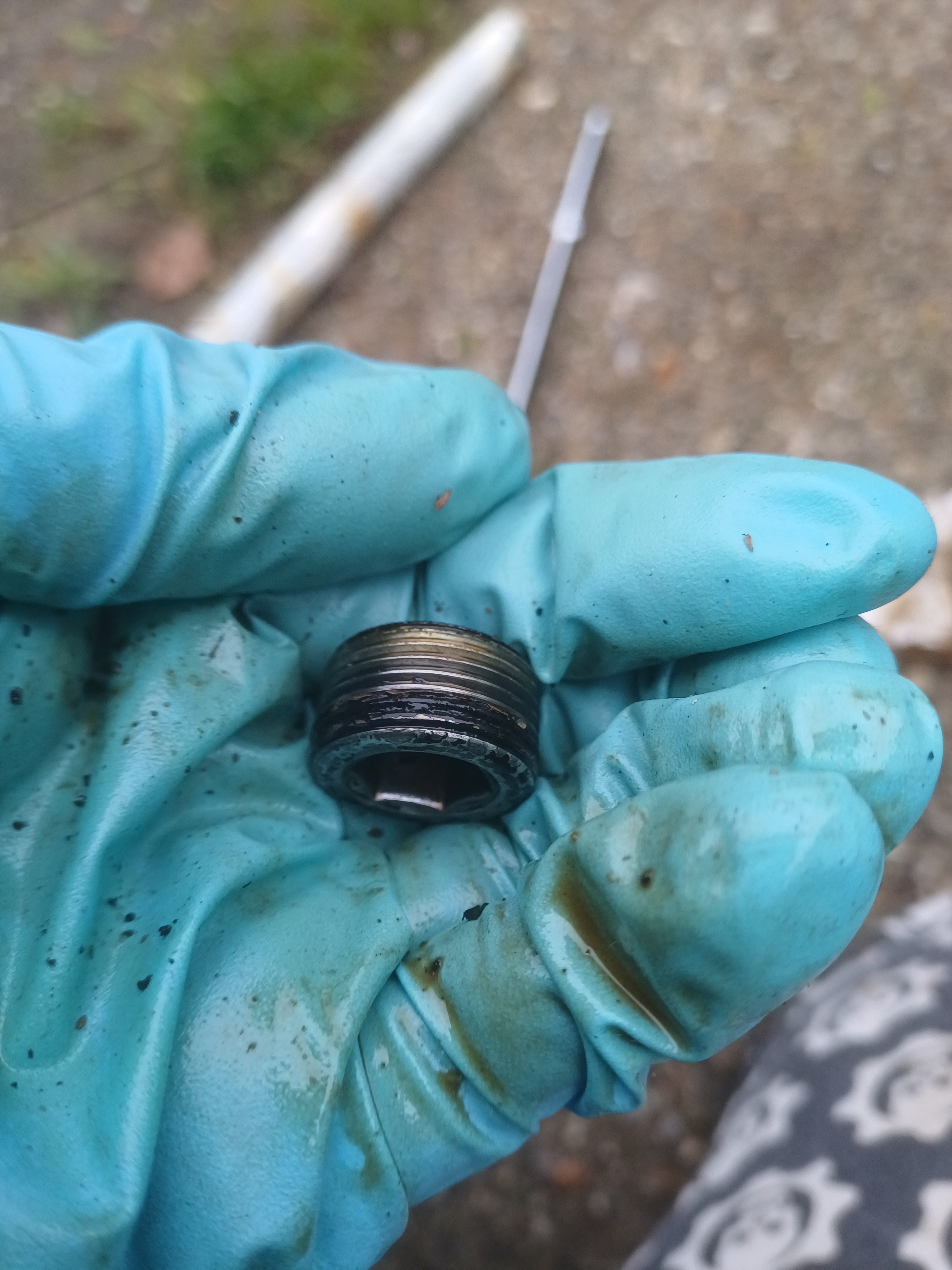

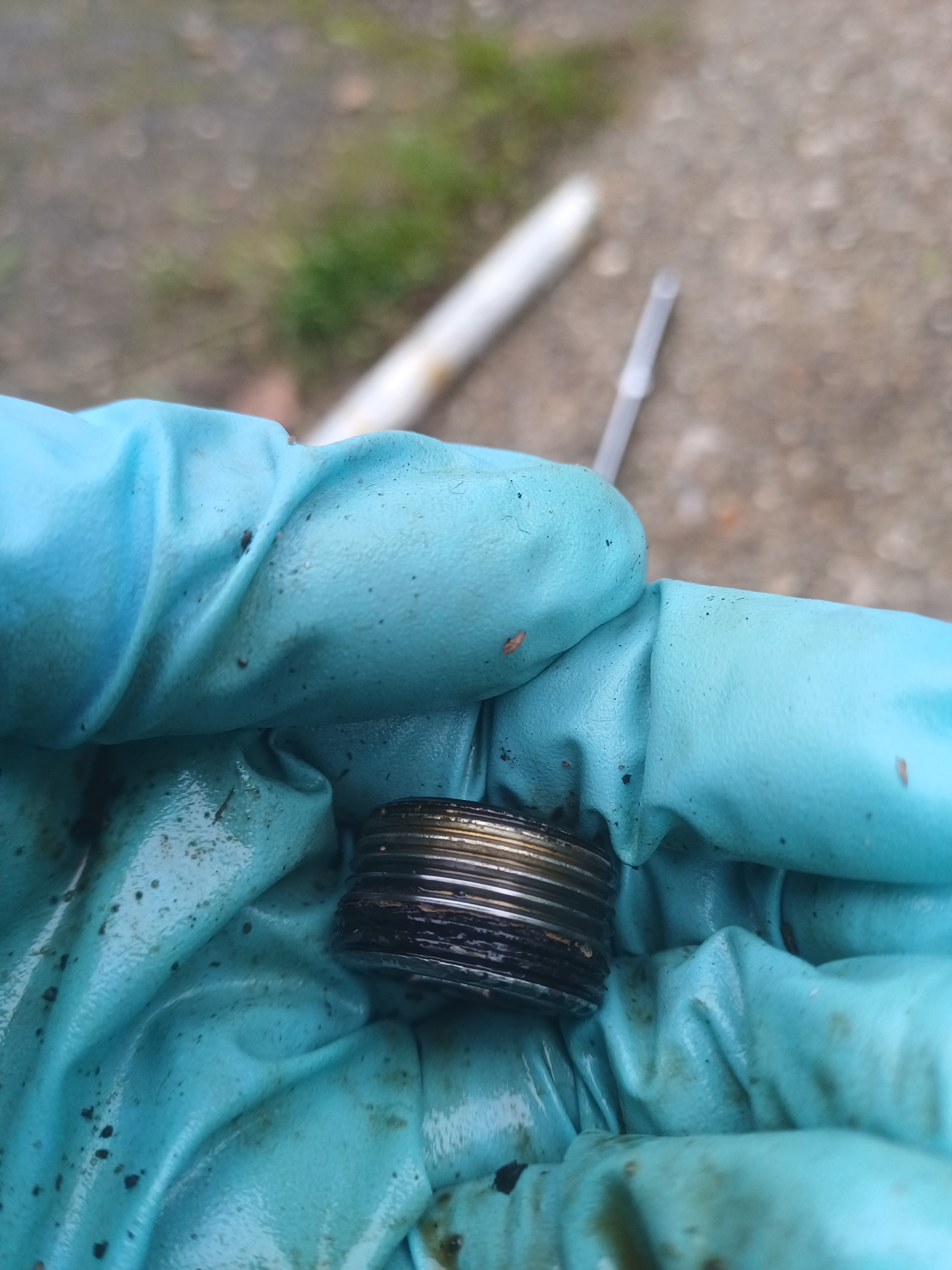

Eres pics of the sump plug. Idk what the black stuff is tbh. 🤷🏻‍♀️

On my Unos the drain plug was the same size as the level plug. So after removal of both. I used a shortened scaffold rail.
And as said here earlier, easier when warm. Or attack both with a blowtorch, or a 120v or 220v wand bolt heater.
