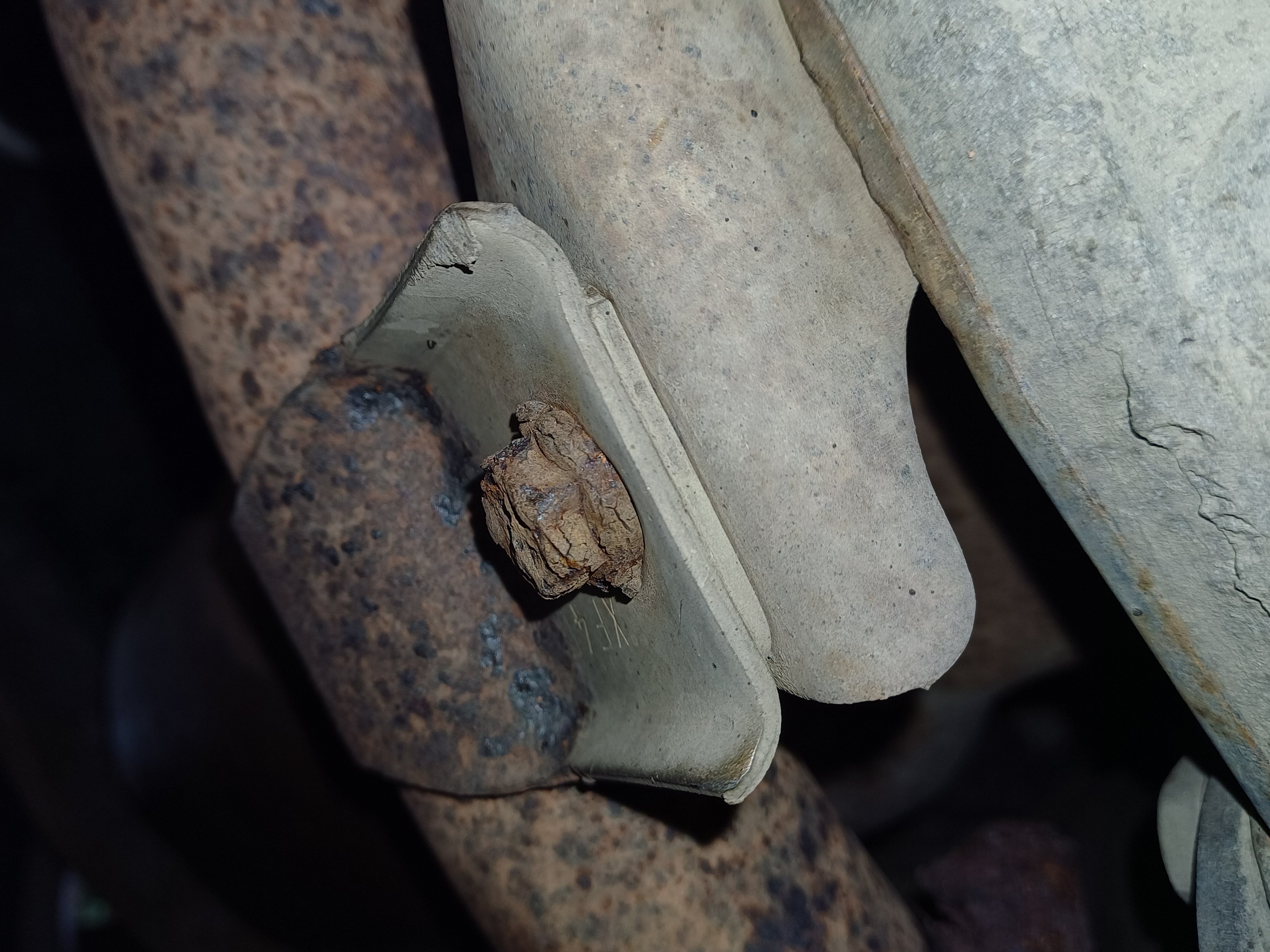

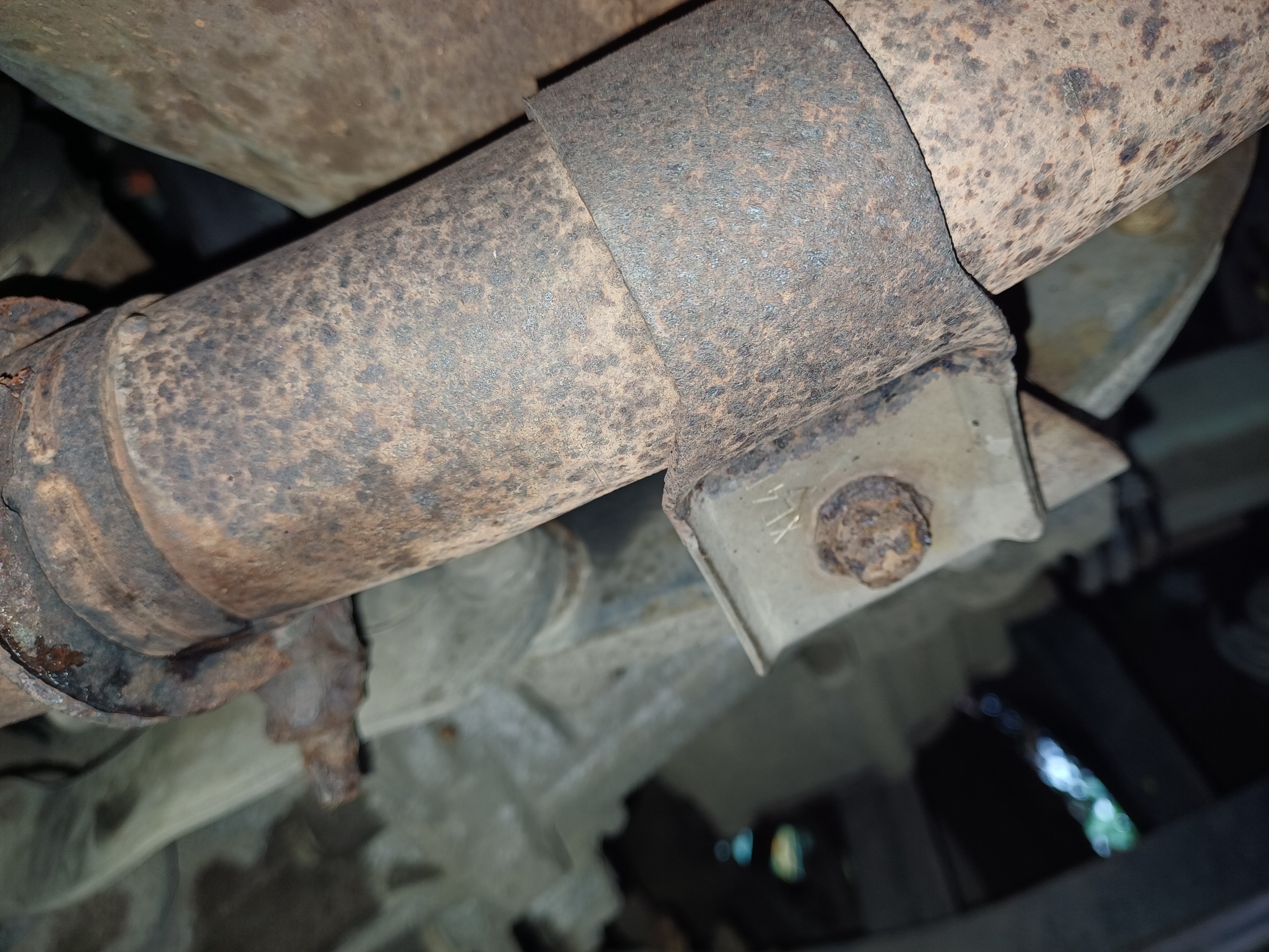

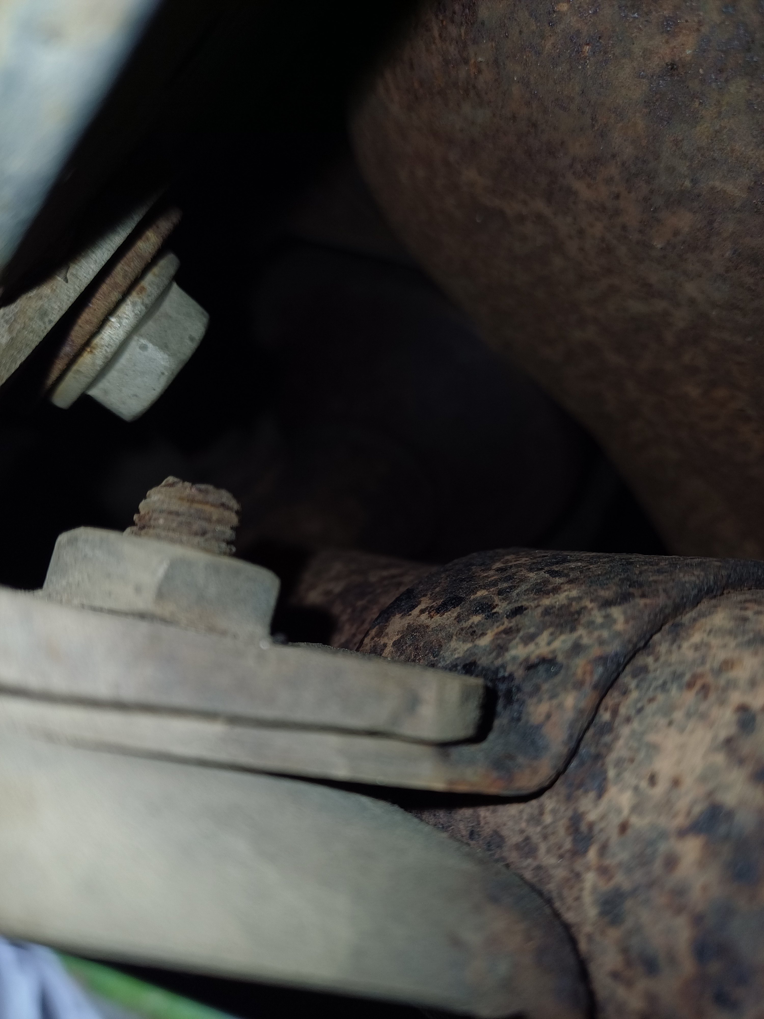

This is the front pipe clamp, note the clamp attaches to a bracket that attaches to the gearbox
This clamp is so important as it supports the weight of the system at the front so as not to stress the manifold connections and studs!- its the one part that if rusty or non-existent you should replace and or re-fit immediately!
oooooh ok, tysm. So to check, this is under the leaf in my pic?Not the same one as was in the video and pic I posted?
Should I still change the other one too, as it looks a mess? The smaller one? Or would that risk making it worse?

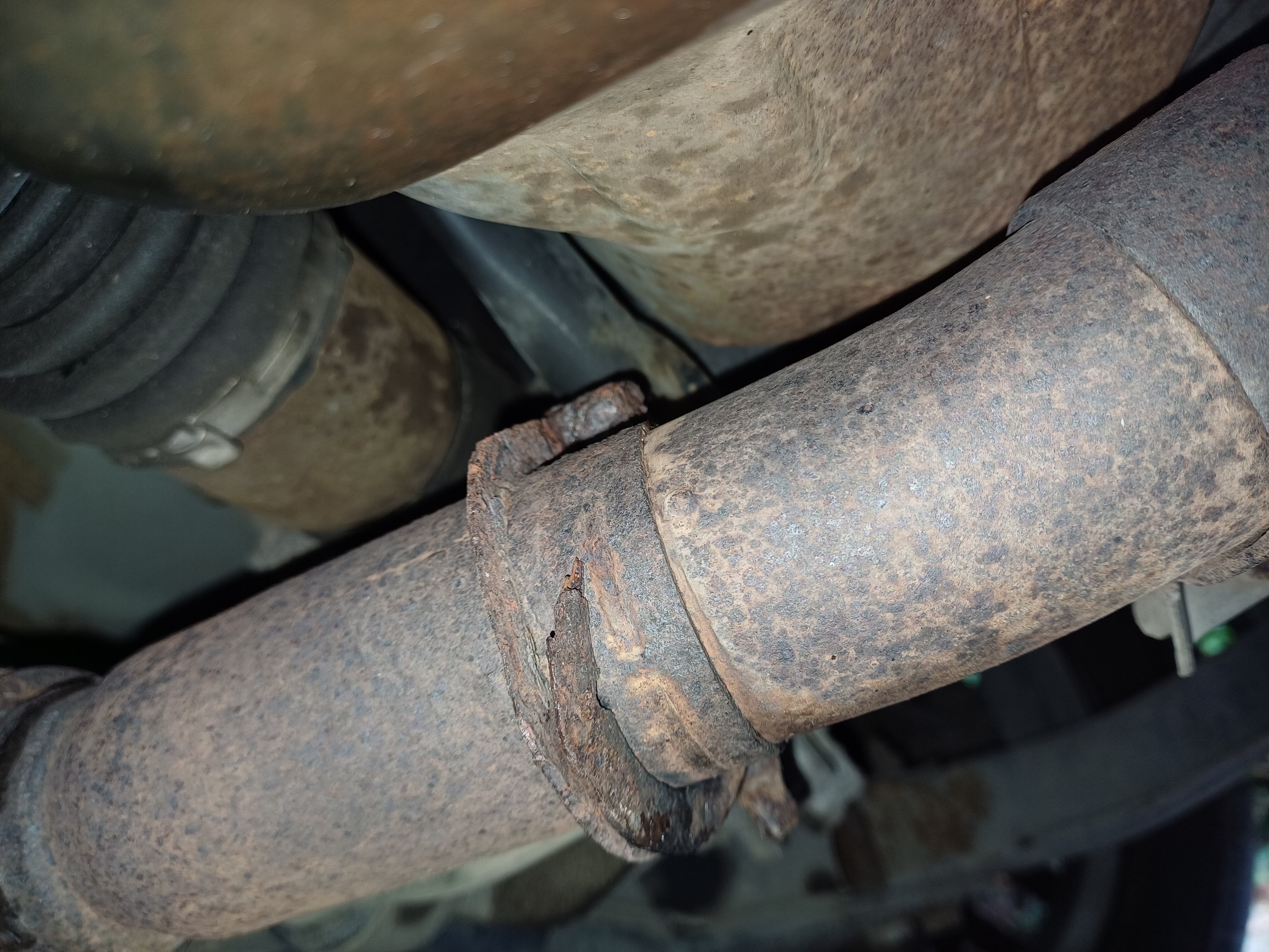

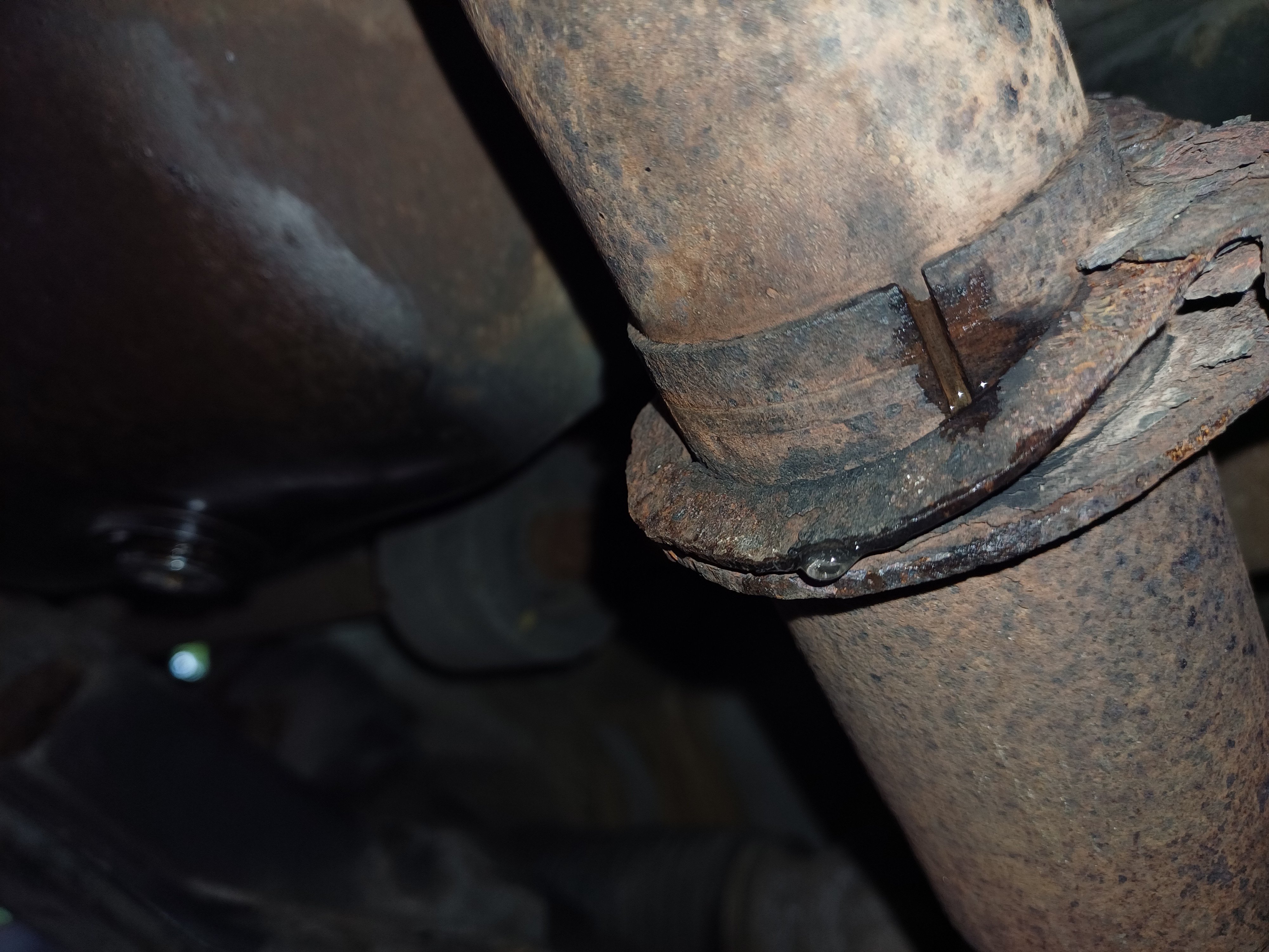

I was googling things to put on the hole, if it is a hole, there were loads of things. There's something called gun gum, that you can get all sorts for. Metal bandages to go over pipes and wotnot. Is something like that worth considering? Or leave it be.
I guess it's hard to say until I get better pics tomorrow. Thankyou all so much.

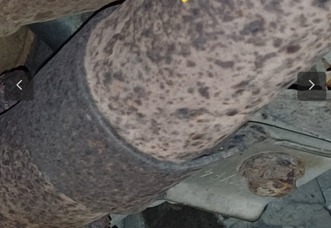

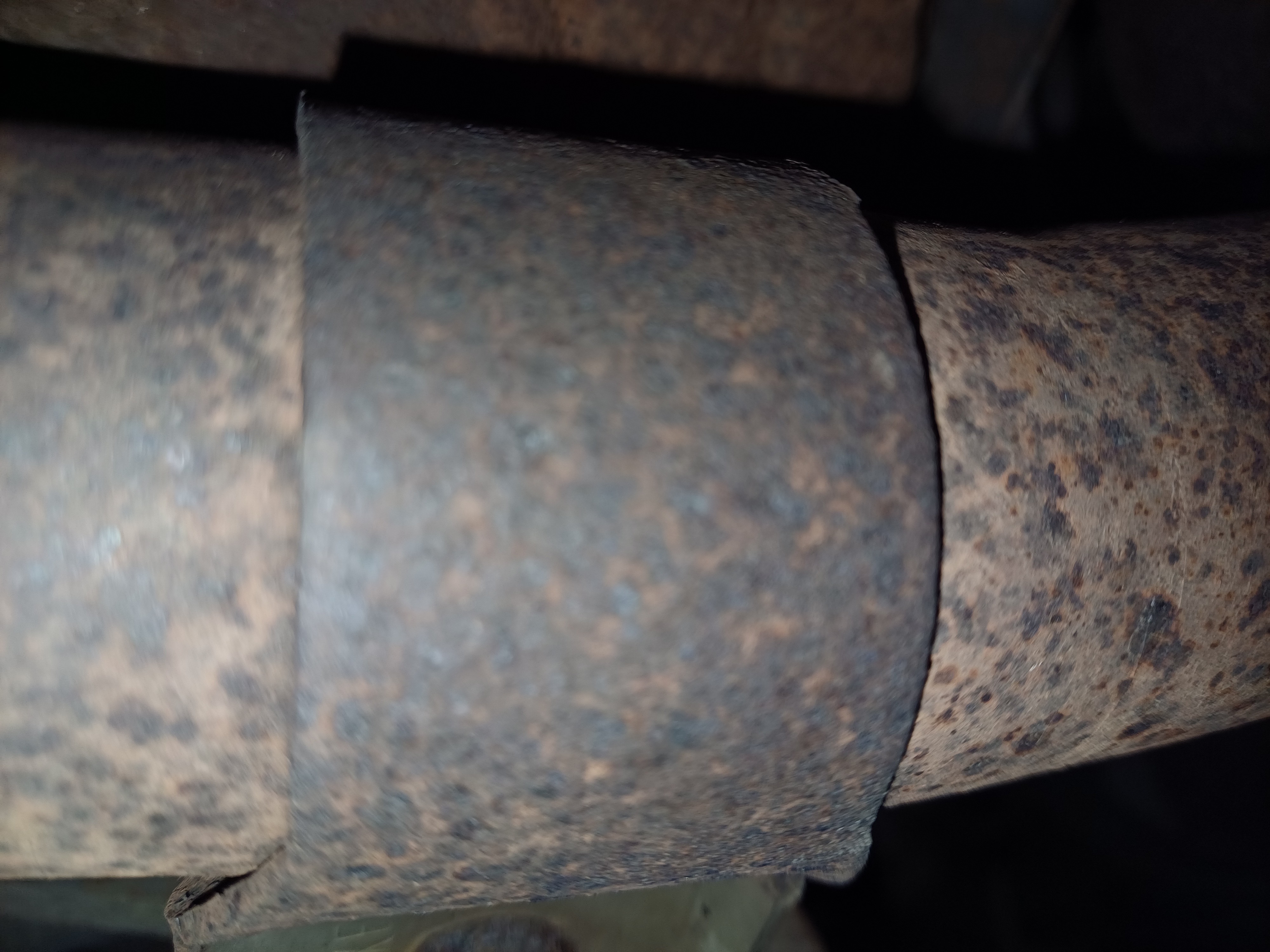

Front clamp looks fine
Or am I missing something
Although I can only see one side
Well spotted koalar! I didn't even see it, I was so used to seeing mine not being there! (I've made up my own bracket with an exhaust clamp).
It all looks fine, @sherbsville, your exhaust is nothing to worry about. Wait until the MOT mentions it, then have a think. Just keep an eye on that bracket. Now, go and worry about something else :D
In fact, I'd say the underside of your car is in remarkably good condition for its age, so you don't need to feel sorry for Bubbles. An occasional wipe with oil or grease on the sump pan and rear spring pans will keep her happy :)

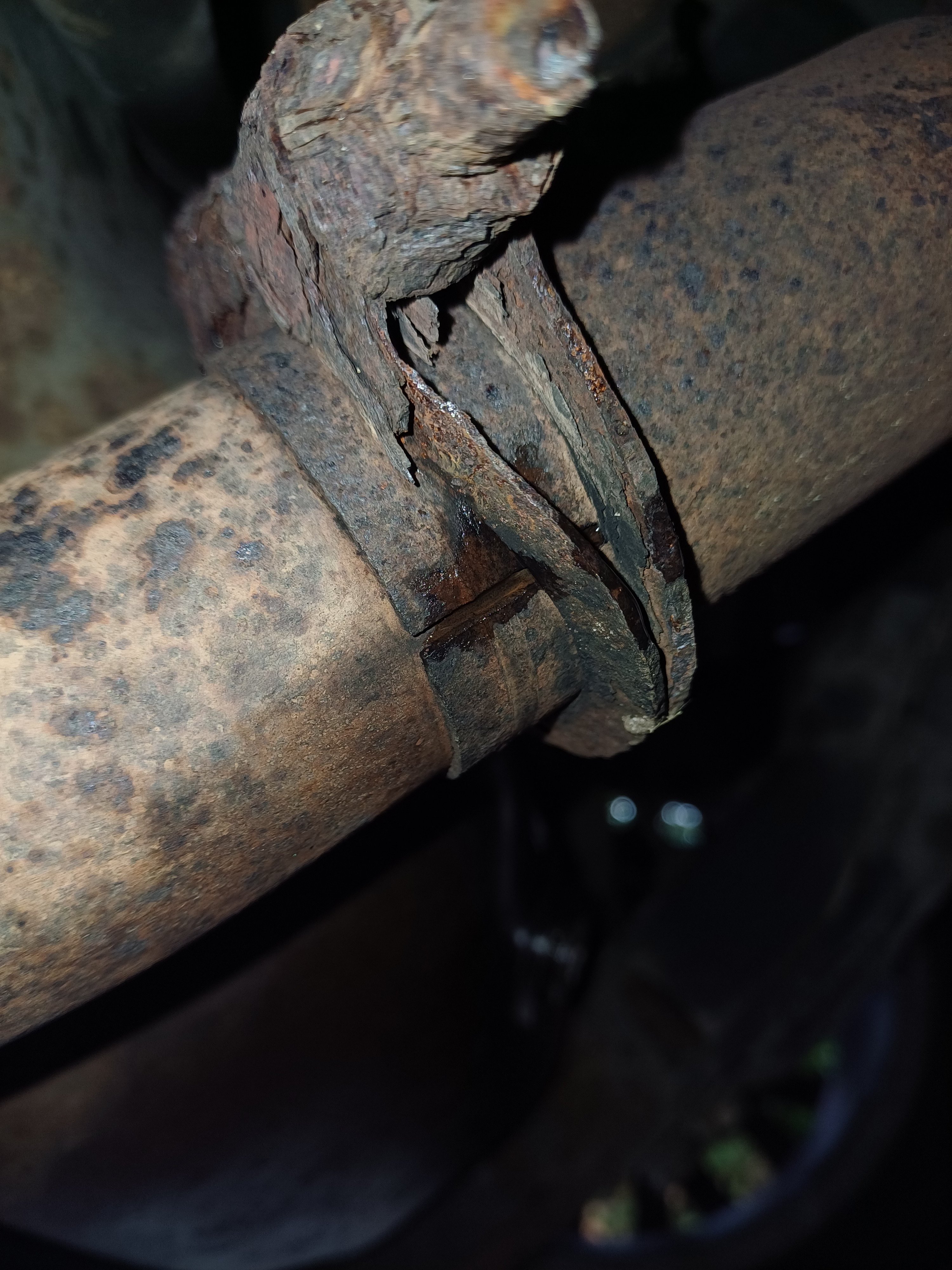

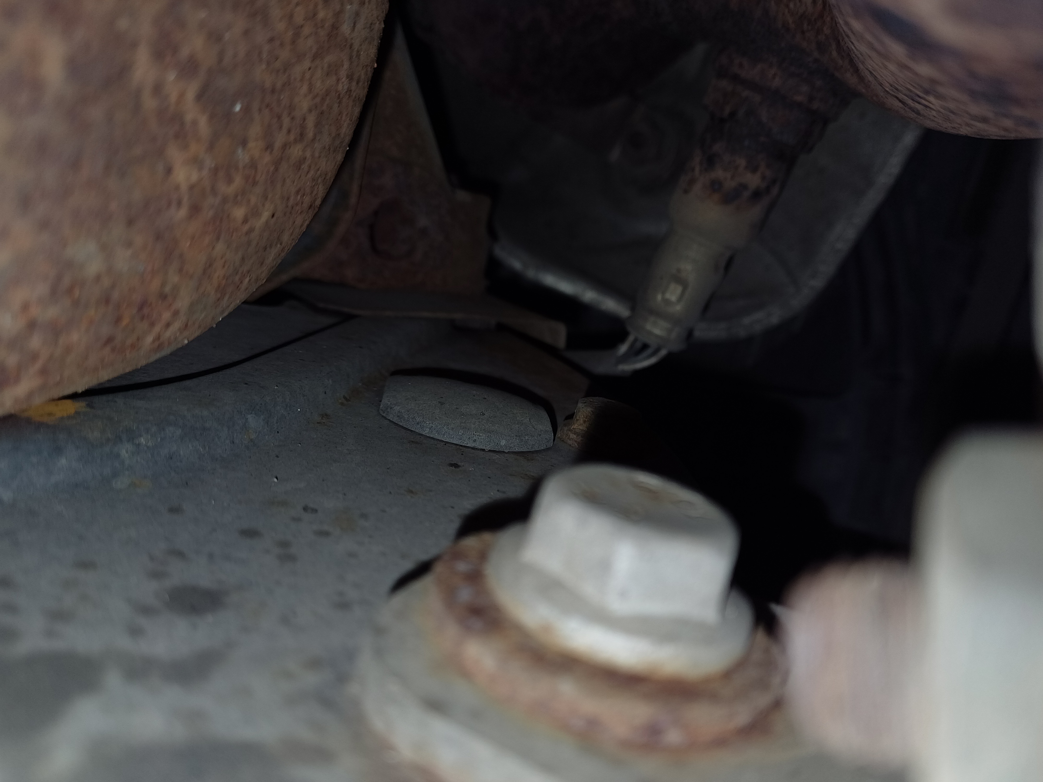

Anyway, so I'm gonna get a new exhaust clamp, as I think that's the biggest issue. The bolts on the front clamp were kinda shady, so I will add that to the checklist, and will do it at some point. The actual band felt pretty strong, but I don't wanna jinx anything.
Anyway, eres the messed up exhaust clamp, leak, and the other clamp.

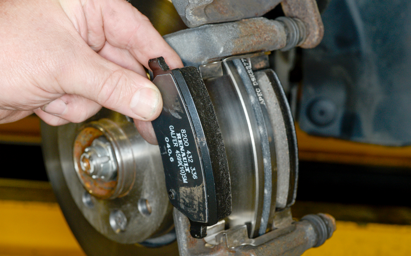

Take the wheel off and look at the thickness of the brake pads.
In the pic you can see the thickness of these new ones are about 10mm. Yours need to be no less than 3mm.
