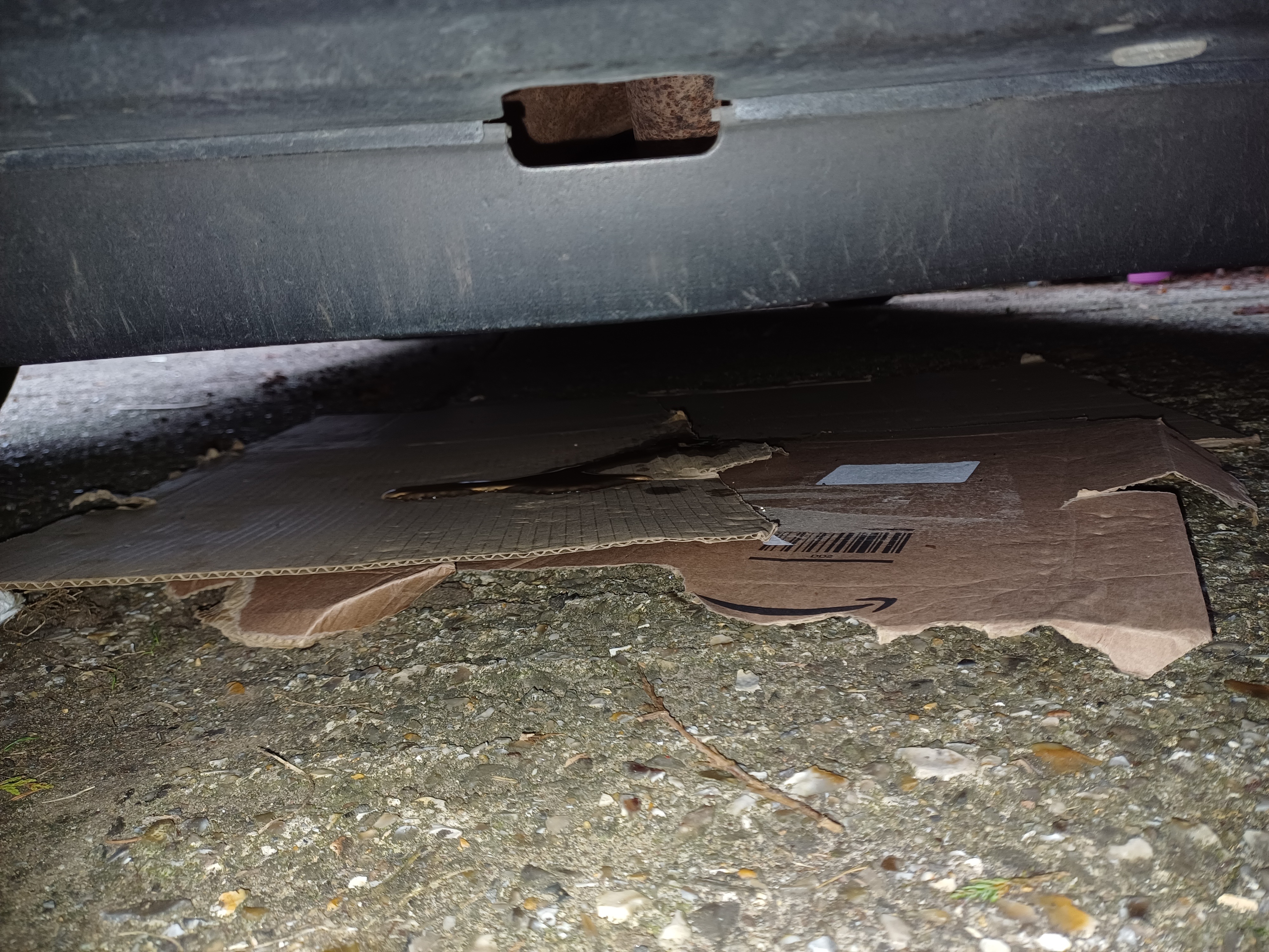

Cool, so there appears to be a tiny bit of oil on the cardboard, the water stopped quickly, and was a few drops. I've wiped around the sump plug, and will keep an eye on it. The oil was under it, and there was oil around it. Might need to tighten it up. Hopefully that black stuff wasn't there to stop leaks.

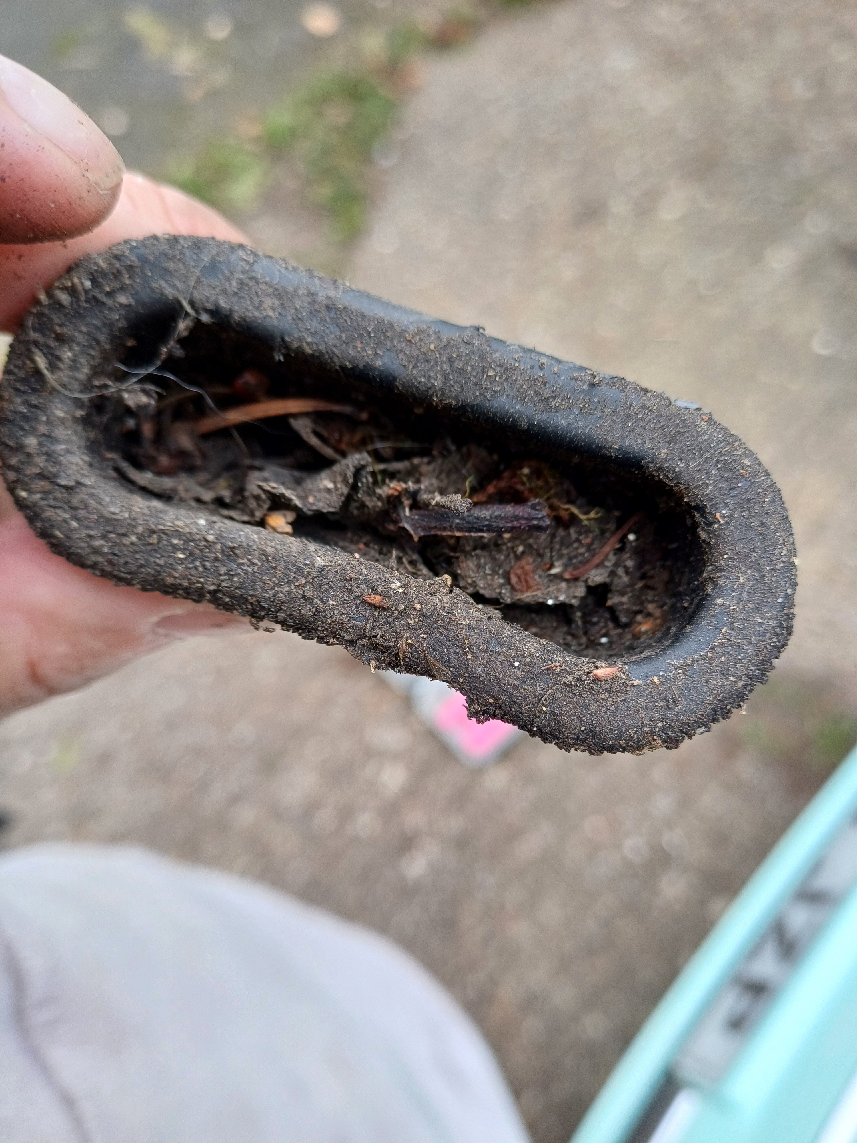

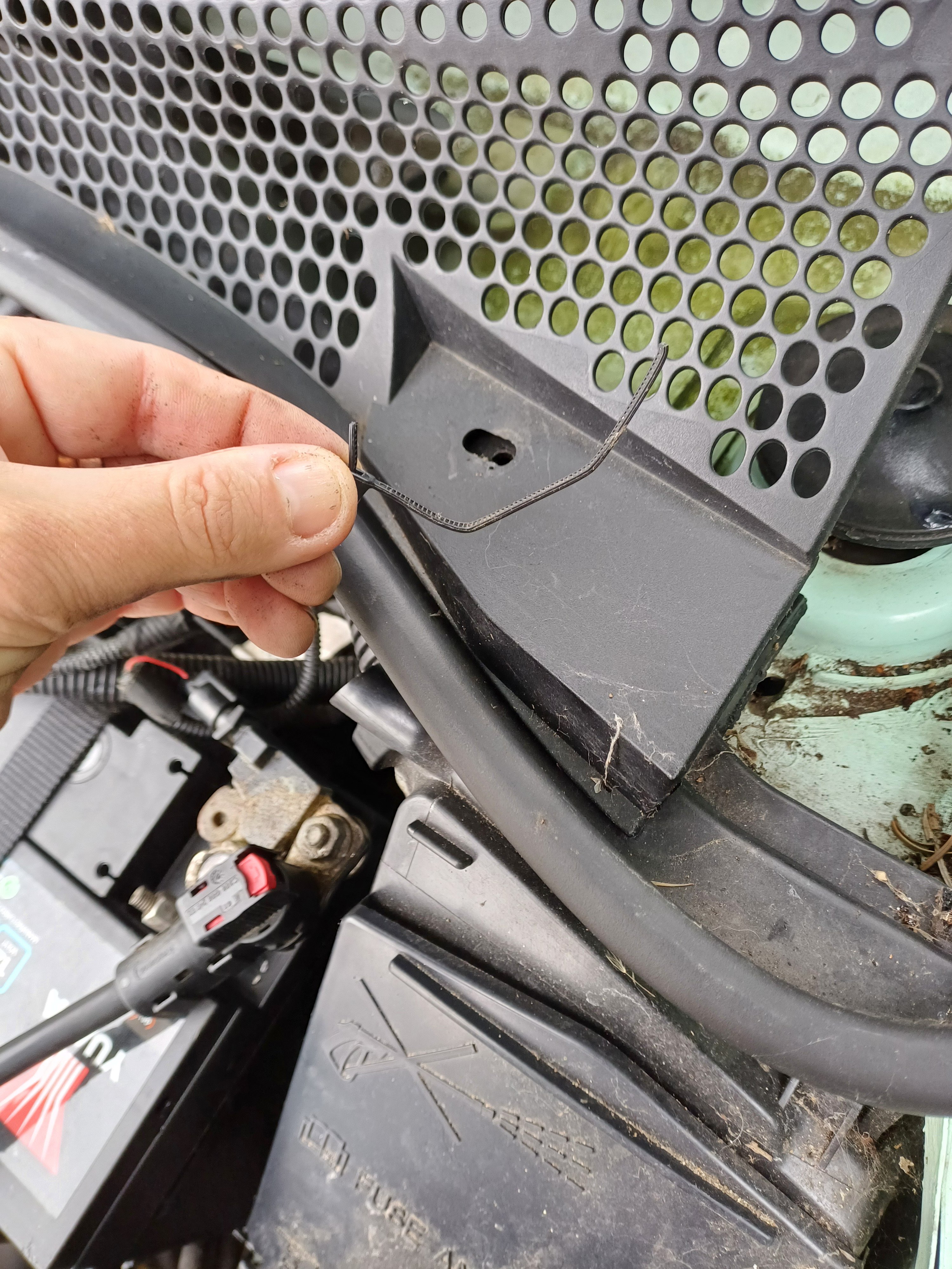

So I went to clean the duck bills. Turns out the plastic top bit had a cut zip tie holding it one one side, and a broken plastic bolt the other, I went in from underneath tho.
Soooooo, I only had one duck bill thing, and the other was half fallen out, so that's cool. 🙄 I need to buy some. Any ideas on best place please? Are they meant to attach to anything as they drain, like tubes or anything? Thankyou. Sigh.

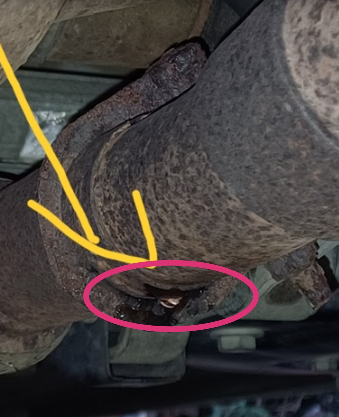

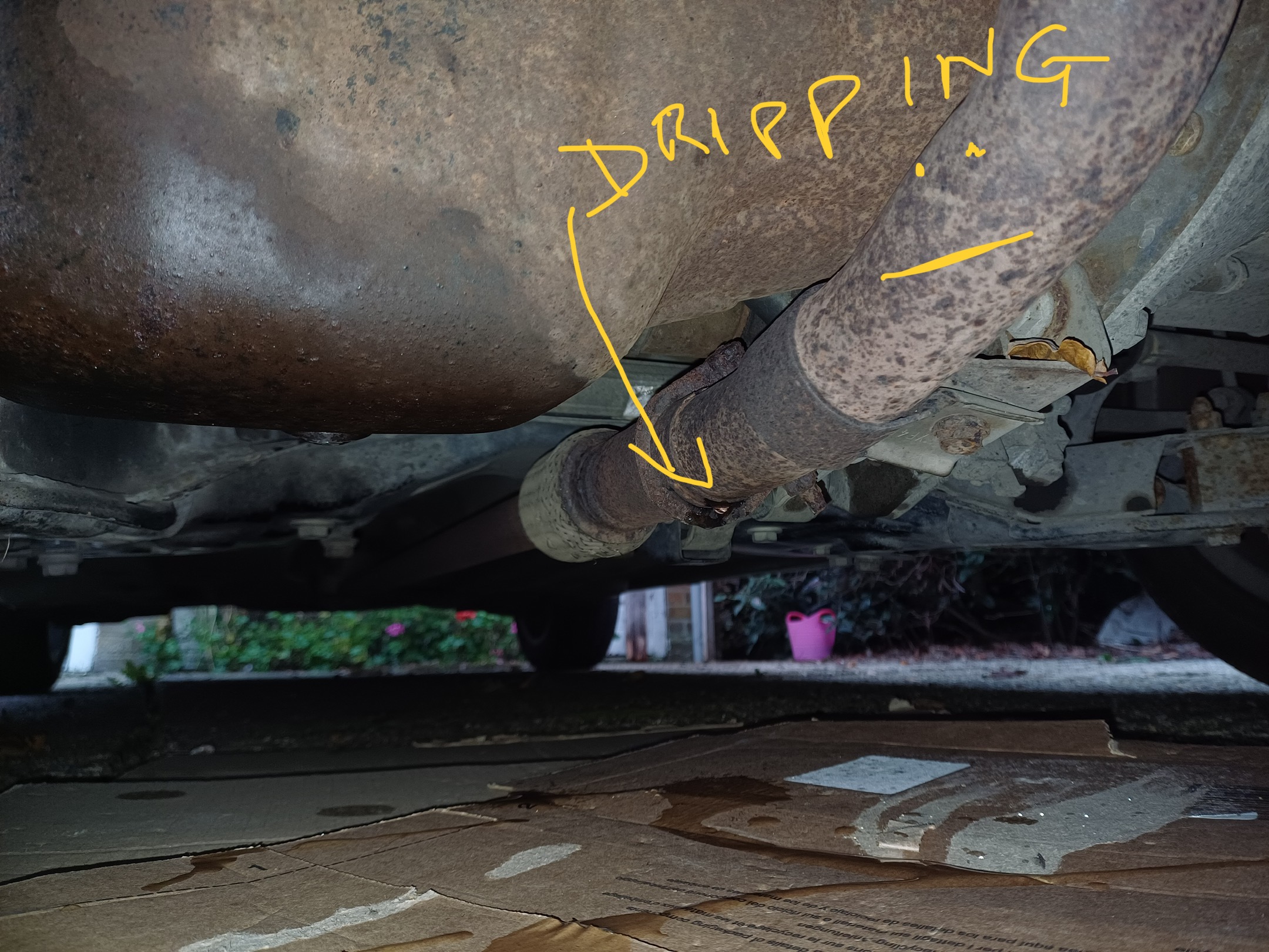

So earlier on I fiddled with the ac, and it wasn't getting colder than the normal fan, and there was no water under.
Now idk if this ac or not, but I fiddled with it, following Johns advice, and it didn't click @John202020
So I looked under after, and there was water dripping out. It stopped after a couple of minutes, but I've never seen this much. Oh no, what is this now? It doesn't happen everytime. The car had only been running about 90 mins before, and there was the tiniest of splats then. Idk how long this has been going on for, as I only noticed when I was looking for oil leaks. There has never been this much tho, to my knowledge. 😭😭😭
Thankyou.
Edit: Wait, is that the exhaust? I couldn't get under to see if the water was coming from above, or from that pipe. I will tomorrow, as it's getting dark.

It is not unusual to see water condensation drip from a cold exhaust, if you give it a run up to normal temperature and it still did it I would be more concerned.
What it is pin pointing is a slight exhaust blow, otherwise that water droplets would be at tail pipe.;)

As its not getting colder that kinda proves the system has no gas in it! which is vindicated by the compressor NOT clicking!- as john said its protecting itself( by not trying to pump nothing!).
However going by your pictures its most likely your exhaust system is full of condensation(exaggerated by the colder weather!) and thats whats dripping! a longer run out at higher speeds (60mph for 30 minutes or so should blow it through if you get the chance!).
The drains for the air con system are located at the FRONT of the car so any water from them would be at that end (under the engine!)- that being said a drip from the flexi pipe in the location in your pictures +the fact it does look a bit rusty under there suggests you might be needing a centre pipe sometime soon?
hope this reassures you a bit!.
Note also that there is a small hole in OEM backboxes (bottom front) specifically to allow condensed water to drain out, which folks sometimes mistake for a leak. This hole isn't always there on aftermarket silencers.
As has been said, this may just be condensation, but if it's happening in the location you have pictured, you've got an exhaust leak.
Also keep a close eye on the condition of the exhaust support bracket that's just in front of the leak - yours has some corrosion on it. They are known to rust away completely and if they do, the stress on the front part of the exhaust can then crack the manifold/break studs in the head; not an easy or cheap repair. These brackets are inexpensive and readily available, and can be opened up sufficiently to be replaced without removing the exhaust.
If you do replace the centre pipe or the flexible section, change this bracket as a matter of course.

It looks to me like it's weeping where the joint is with the centre pipe.
So it may not be a hole in the exhaust, just collected condensation finding its way out.
If the exhaust is blowing they'll let you know at MOT time. Until then I don't think it's anything to worry about.
As above, a good run to get it hot should evaporate the condensation, and renewing the bracket is a good idea.
