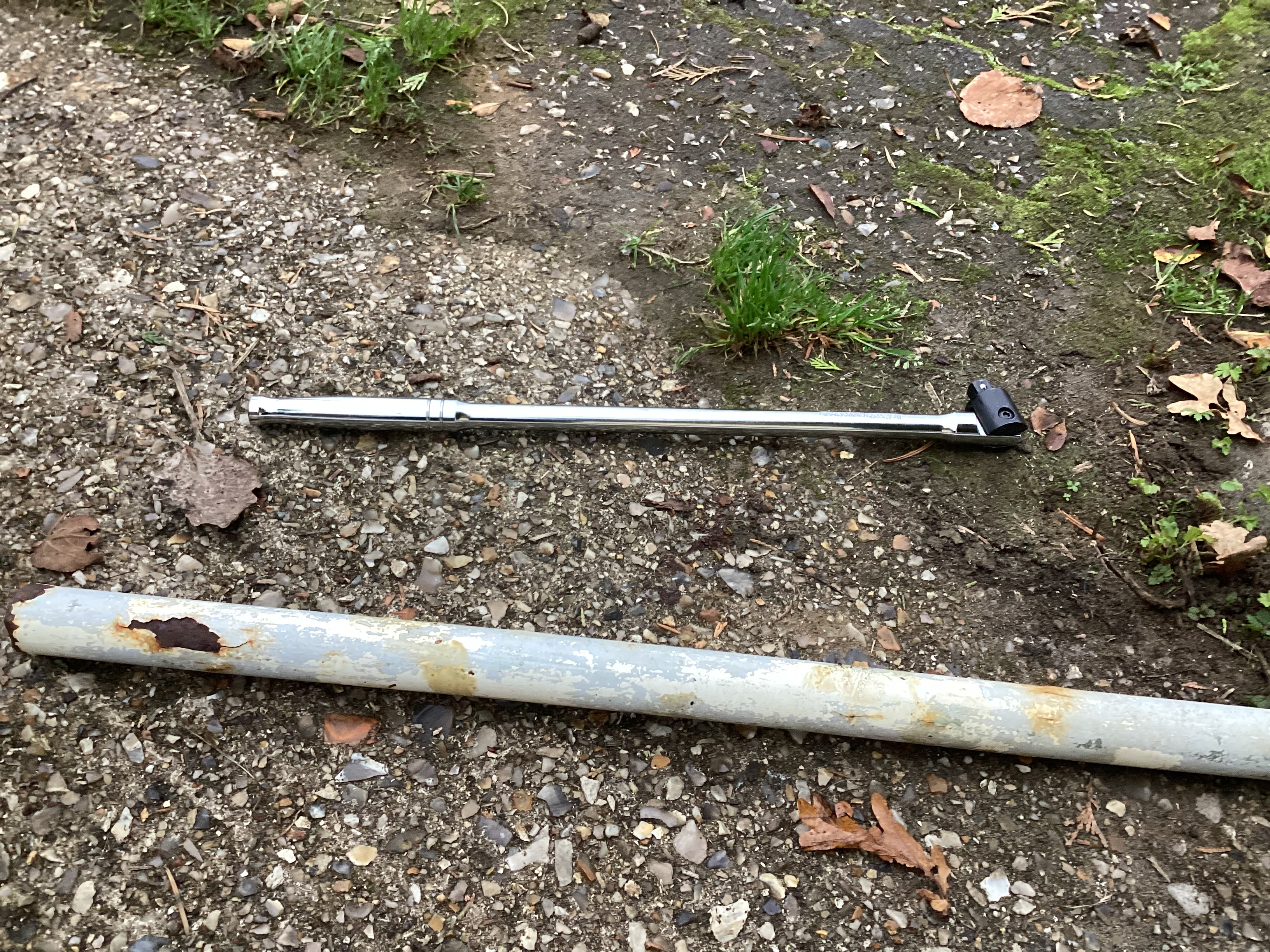

I'm gonna give it a go with the short one I bought from Halfords tomorrow, then when it doesnt work, buy a longer one. Yours looks sooo good, really sturdy. Dad has a short one that's as sturdy, but it doesn't fit. I know Dad must have had one like yours, but I've made the garage even worse. I've defo seen a metal pole in there at some point tho. I really need to send all the stuff back to mediequip as I'd have more space, but still can't face it.
Leverage is everything, so perhaps if the Halfords one is a good fit you can extend by use of a metal tube.
Mind you if Halfords "toy" breaks they are less likely to refund if they think you have added extra leverage.;)
Anyone else slightly concerned about using a nearly 2ft long wrench on a "fragile " Fiat sump pan?
It's longer than that , but does depend on the skill of the operator:)
My argument in defence is someone yanking and straining all over the place with a "toy" tool has less control than a gentle even pressure with more leverage.

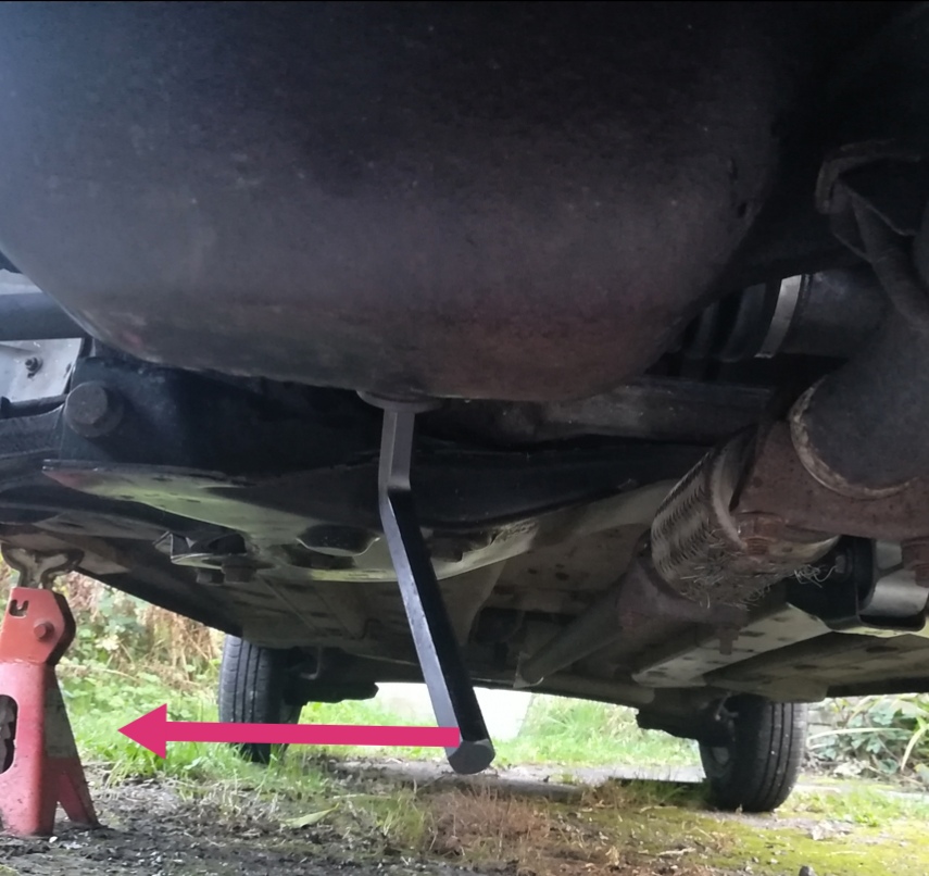

Just in case there was any doubt, this is the direction it needs to go to remove the sump plug
Ooooh thats brilliant, and omg YES! lefty loosey, righty tighty, I swear by it lol. I was laying on the drive, practicing in the air incase I was turning the wrong way. I wasn't, but the whole time I was chanting it like a spell. 🧙‍♀️

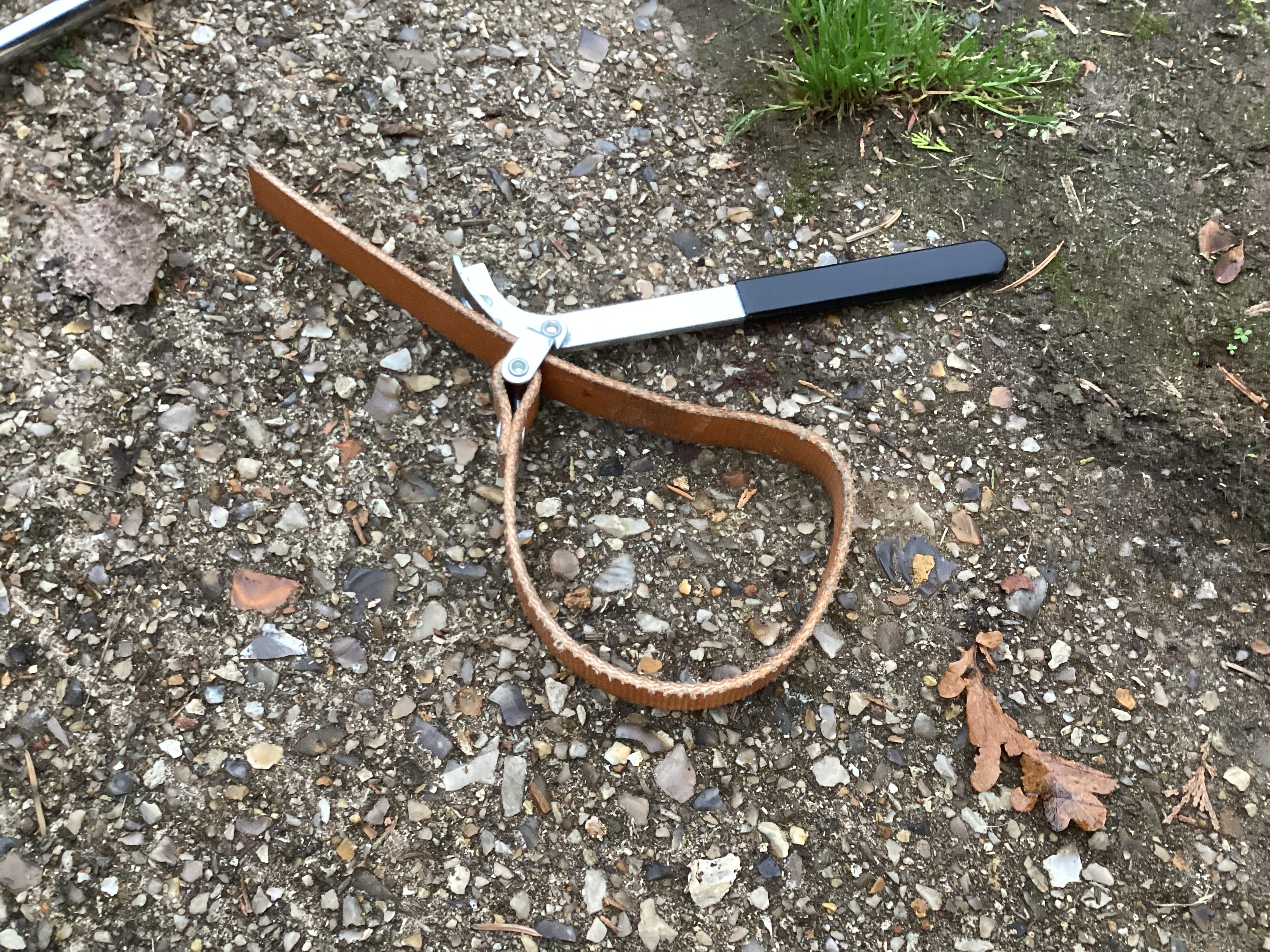

Now its been over another hour, and I cant get the oil filter off. Omg. I bought this stoopid thing off amazon that is rubbish, and keeps coming undone. I'm not 100% if im doing right. Im so cold omg.

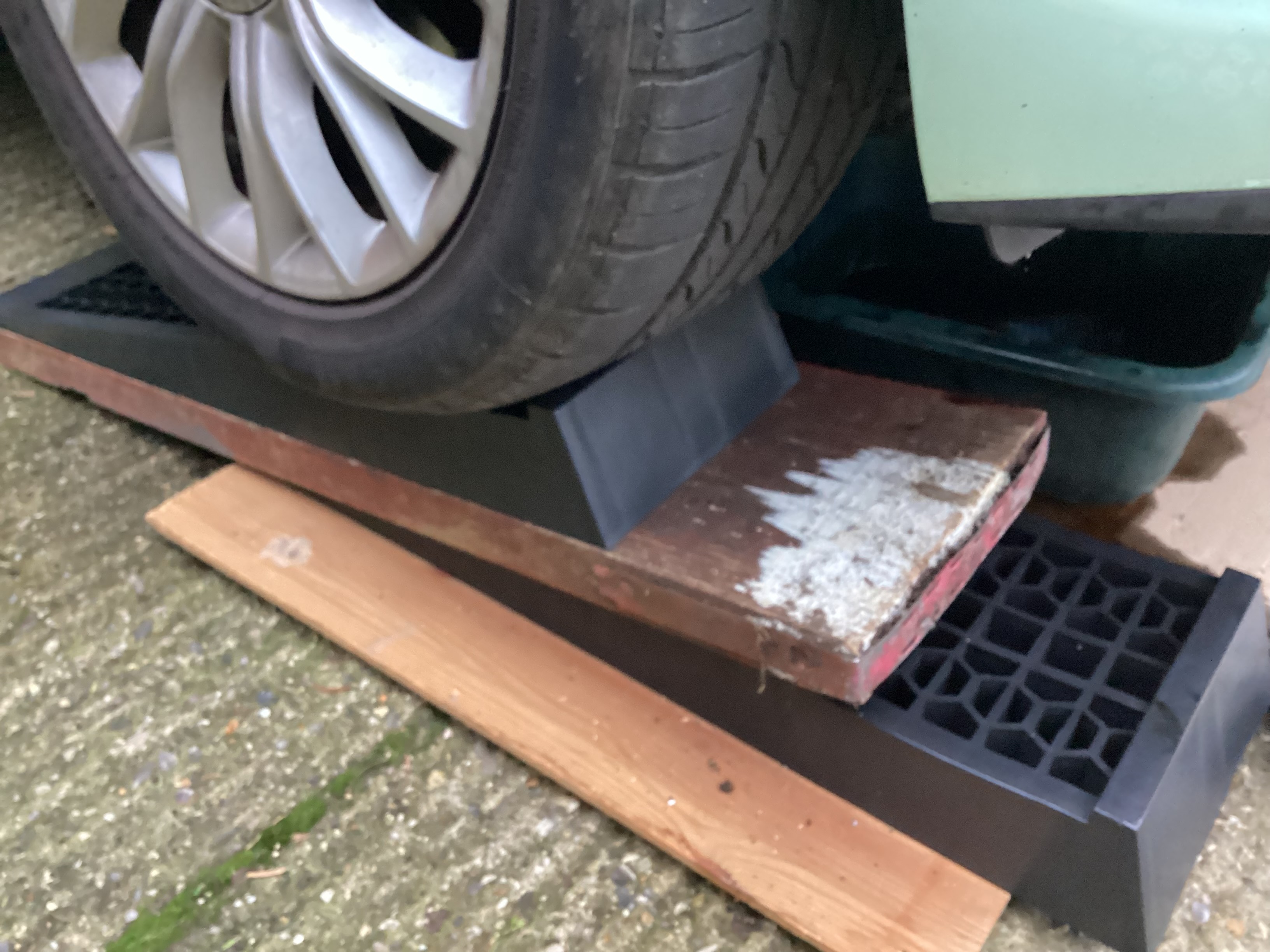

Anyway, is it safe to leave my car raised over night? If so, what can I buy that will get here by tomorrow to take the stoopid oil filter off. Omg. Its alot of swear words over ere.

Congrats on getting the sump plug out! Car will be alright raised up for the night although I'd put the sump plug back in for now in case you forget it when you come to refill!
I've had plenty of tricky oil filters in my time, I generally don't like those strap tools. If its really stuck in the past I have hammered (not too hard mind) a small flat head screwdriver into the side of the filter and then used it to spin the filter.
Isn't the 500's oil filter in a housing mind? It should have a big hex on the end if so (its made of plastic) can be tricky to access in the cramped engine bay though
EDIT: Think only TwinAirs and Abarth's have the oil filter in a separate housing, sure someone will be along to correct me shortly
