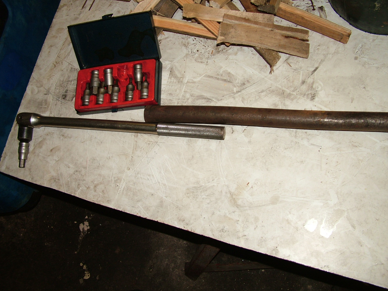

I have been following you tribulations regarding the sump plug removal and as has been mentioned a good breaker bar along with a good fitting allen socket to suit, plus if necessary for extra leverage a tube slide onto the breaker bar. Never use a flimsy ratchet as it will break or wobble.
I appreciate what you say regarding lack of space under car to make life easy, but even with a long bar such as in my photo , it should once positioned correctly only need to move a few inches to free off the plug, assuming no extra sealant or bodge by someone previously and once cracked a ratchet can finish undoing the plug.
This 3/4inch bar with or without the 1/2 adaptor and extension and an adult male on the other end has never been beaten, even up to small lorries and tractors.
One advantage of "overkill" is you have more control as you don't have to strain or yank anything.

Ooooh thats brilliant, and omg YES! lefty loosey, righty tighty, I swear by it lol. I was laying on the drive, practicing in the air incase I was turning the wrong way. I wasn't, but the whole time I was chanting it like a spell. 🧙‍♀️
I'm gonna give it a go with the short one I bought from Halfords tomorrow, then when it doesnt work, buy a longer one. Yours looks sooo good, really sturdy. Dad has a short one that's as sturdy, but it doesn't fit. I know Dad must have had one like yours, but I've made the garage even worse. I've defo seen a metal pole in there at some point tho. I really need to send all the stuff back to mediequip as I'd have more space, but still can't face it.
