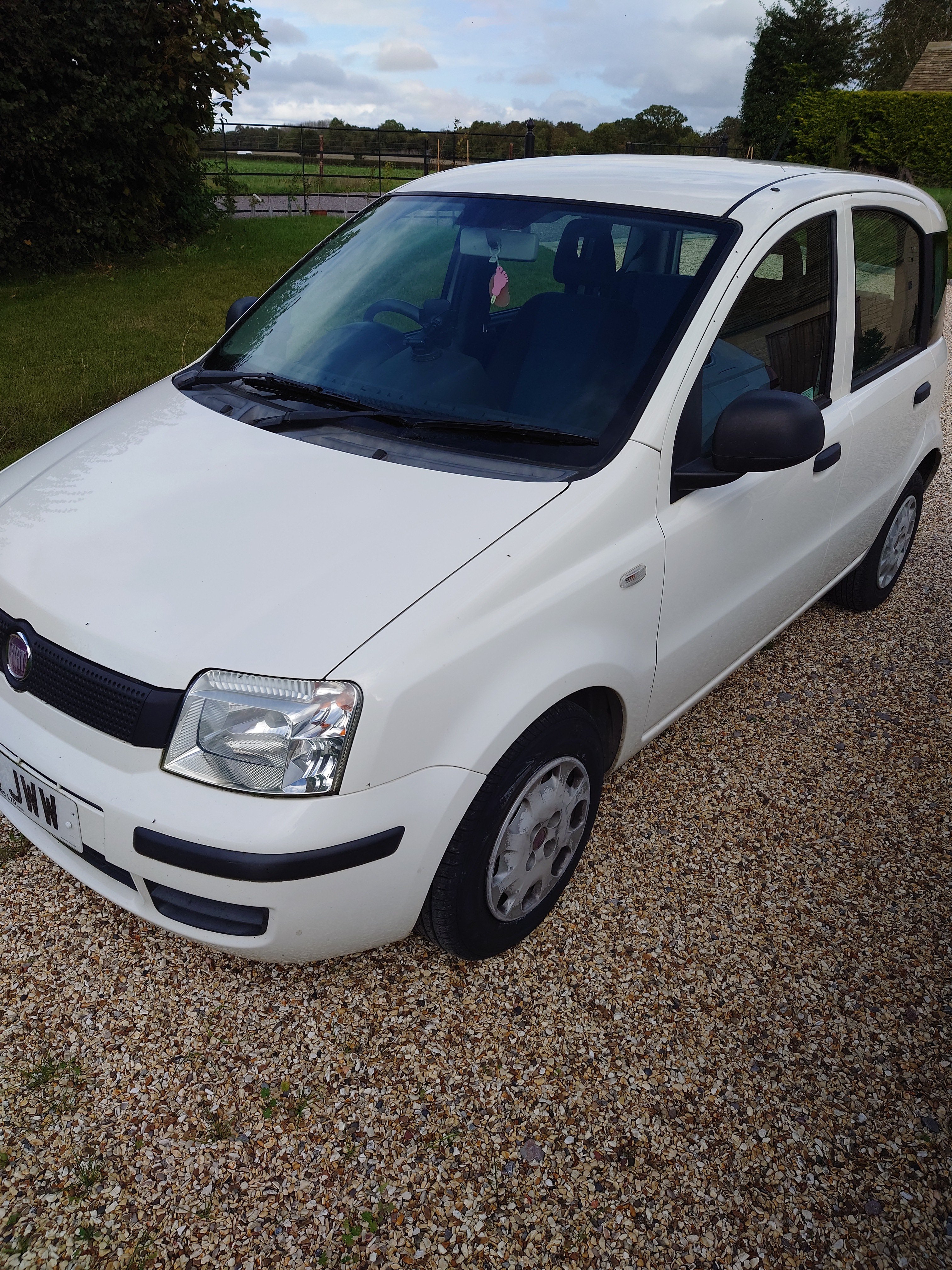

Hi, I am new here and hoping to solve a couple of issues on my daughter's Fiat Panda.
The clutch squeaks when the peddle is pressed. I have the same issue on my CRV but I can sort it by spraying some GT85 on the mechanism above the pedal in the footwell. I have tried this on the Fiat Panda but so far no joy. Any guidance on how I can solve this.
Many thanks
Tom
The photo did not attach for some reason
