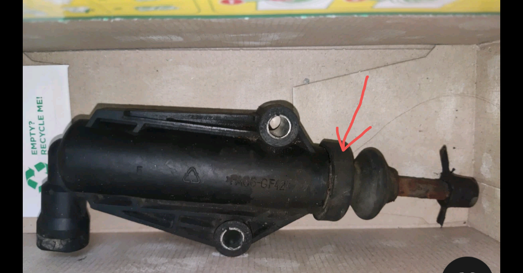

Do you have any pictures or anything to show exactly where the grease needs to go? Thankyou
Thanks.. this is the same panda you helped diagnose the faulty alternator on a couple months back by the way🤣🤣
Remove this rubber protector, and spray some silicone grease inside

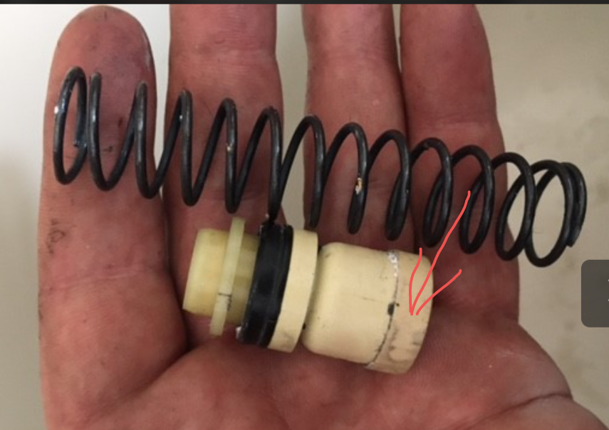

It's this part that goes dry
