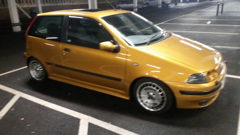

Good work with that burnt orange GT by the way it looks mint! Good effort!!!
Washed and looking a bit more respectable
nice, gotta love a set of ronal turbo's... And they are so old that not everyone has a set like they once did Only thing wrong with this car is that it is not mine lol. Drop me a line if you ever want to sell it lol
