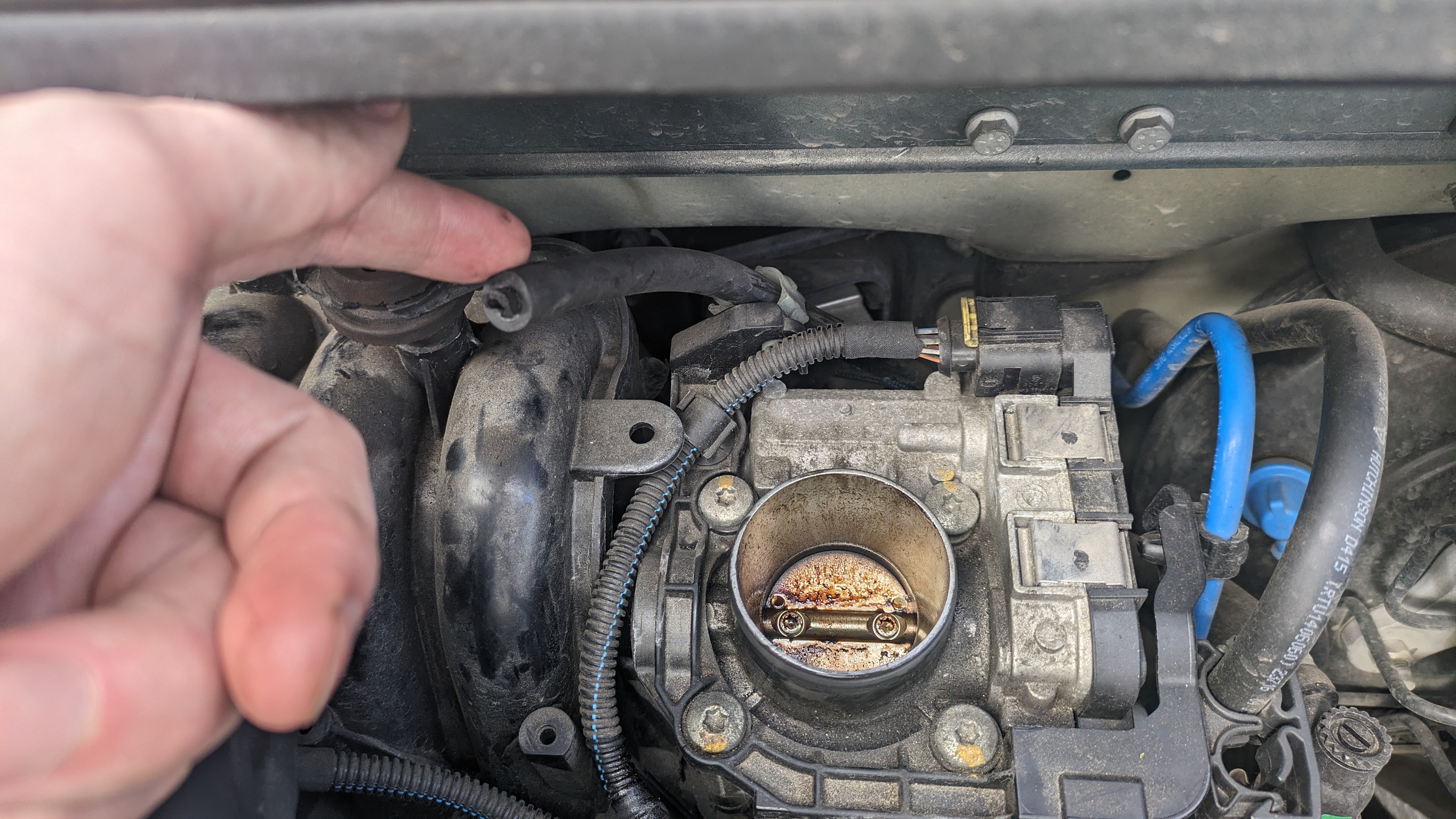

Hi guys ,
What is this broken hose? ... Should go into the airbox but snapped off.
I'm wondering if this is causing my random rough starts ?
Thank you in advance!

Its a breather hose. It won't be causing your random rough starts. But it will be causing a petrol smell inside the car if you have the air conditioning on.
There's no easy fix for this. You can't buy the airboxes for sensible money, meaning the only real option is to repair the lug on the airbox yourself. I tried to fix mine recently and it wasn't successful, so I just gave up. The occasional stinky smell isn't a major problem for me.

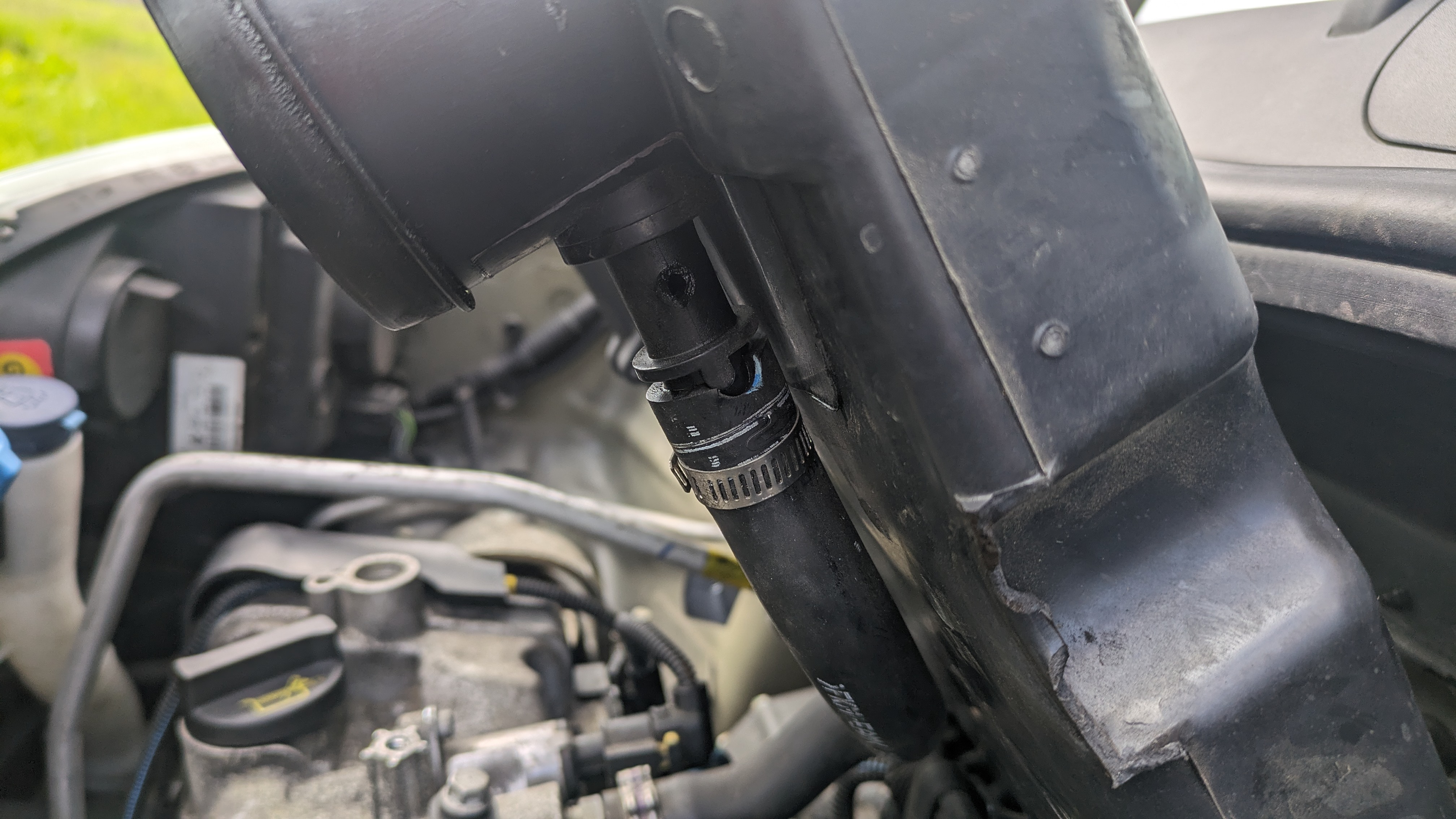

There's nothing wrong with the breather hose; it's the spigot on the airbox that's broken. You just need to pull what's left of the spigot out of the hose and repair or replace the airbox.
You might be able to find, make or modify a suitable brass spigot and tap it into the airbox, much cheaper than replacing the whole airbox.
If it is of roughly the correct diameter get a piece of 10mm copper plumbing tube (microbore), heat it with blow lamp or similar and press it into the plastic of the airbox; the softened plastic of the airbox should form a bond/seal.
This
Cur the old one of off flush and replace with a brass air line taper hose connector
Trill the Airbox out to just smaller then the diameter of the fitting and a decent silicone should hold it in place
