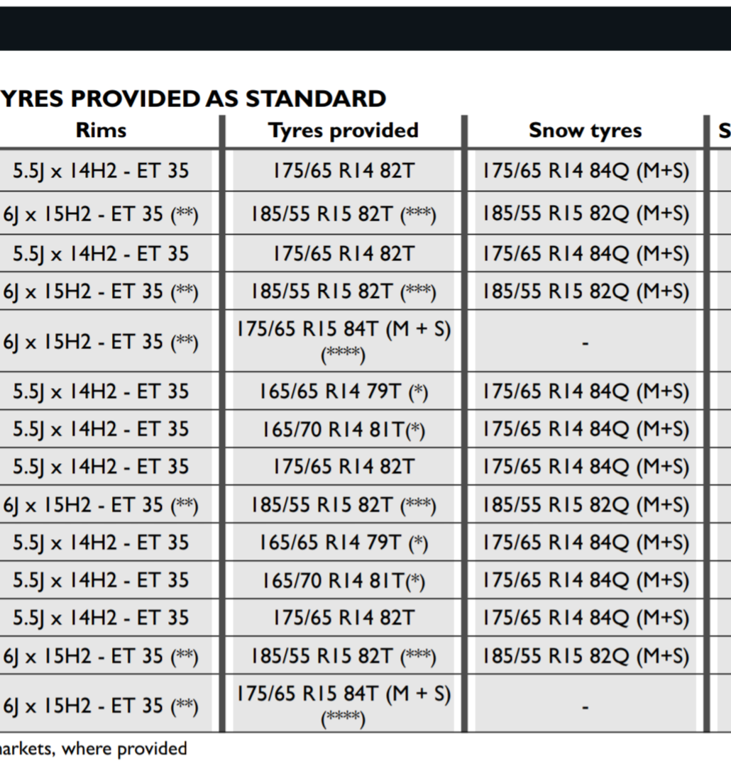

Since you do not want to listen and did not use a comparisson site as suggested, I did it for you. See picture.
As far as insurance goes; I am not familiair with how that works in the UK, but if they find a reason to not cover any damage, they most certainly will not. At least on this side of the channel.
What you do (or not do) with the info is entirely up to you.
Jeroen out.
this removes all doubt about the “under-reading” caused to the speedometer display
as an EU citizen I’m sure you already know that the EU adopted into EU law the absolute prohibition on speedometers under-reading the true speed
UK is the same
where the speedometer under-reading is caused by the owner modifying the vehicle (in this case replacing the factory wheels/tyres with different size/diameter wheels/tyres) the offence is prosecuted under the Road Vehicles (Construction and Use) Regulations 1986, and if the car insurance is voided because of the illegal modification (which it almost certainly will be) the likelihood of also being prosecuted for driving without valid insurance (a very serious offence with penalties ranging from a fixed penalty of £300 and six penalty points on your license, or an unlimited fine, or a driving ban and your car seized and destroyed if the case goes to court)
even if the driver is not stopped by the police or involved in an accident, non-compliant wheels/tyres are an automatic MoT failure - so it will be found out one way or another
Jeroen out.
