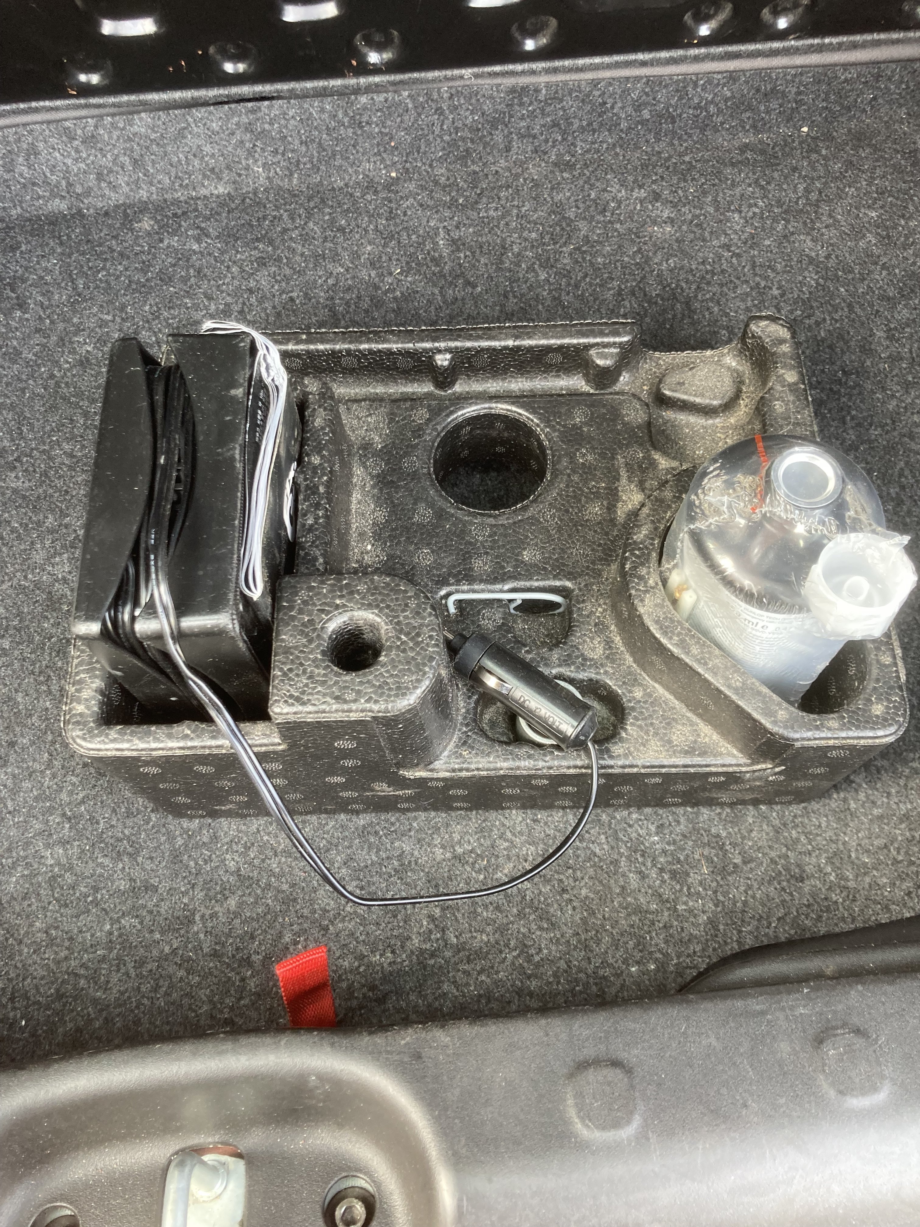

I’ve just picked up a 2016 Trekking Twinair , I’m hoping to get the spare wheel kit for it , but in the meantime it has the tyre repair kit in it .
The kit appears to have bits missing though, I had trouble working out exactly what’s missing,any insights would be greatly appreciated.

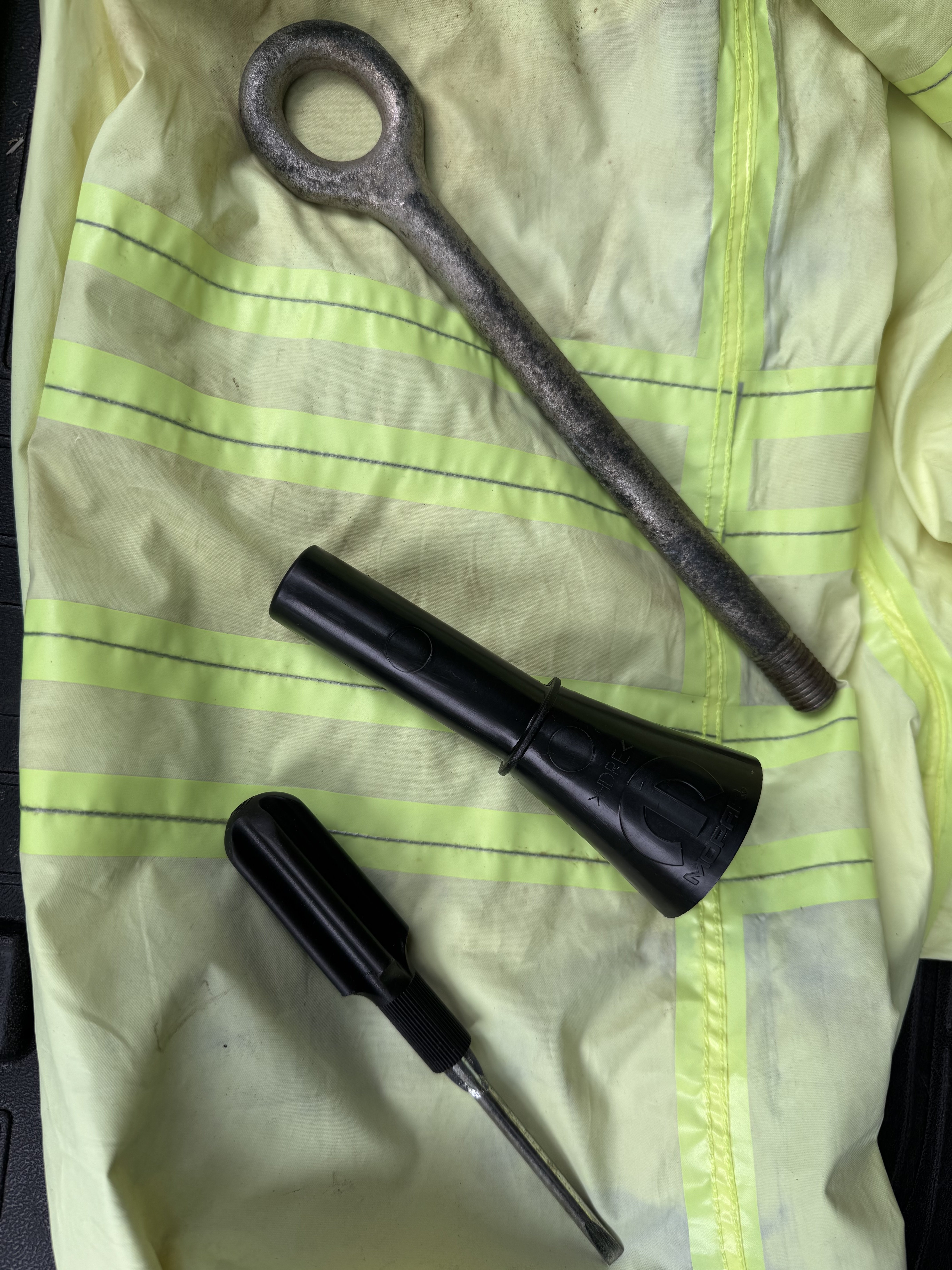

The tyre stuff is there: the bottle on the right screws into the pump on the left to inject goo which (sometimes) seals a puncture. You can use the pump without the bottle as a regular pump too.
One thing I can see missing is the metal towing eye, the ‘ring’ end of which should be over the small raised bit towards the top of your photo. And also there should be a small grey funnel (black if a diesel) that allows you to use a fuel can to fill the tank. And a black-handled screwdriver with reversible blade for slot and cross-head screws.
Oh, and the ‘key’ for any locking wheel nuts.
That polystyrene tray doesn’t look like the one an earlier Panda of mine had (current one has a spare wheel)…. The tray in mine was round, filling the wheel-shaped ‘well’ in the boot. Has the design changed, or is what you have actually from a different car (does the pump have a Fiat label on it?

I’ve just had a good look at the tray and it’s got a VW logo on the back, could well explain why there isn’t a funnel or tow hook.
looks like I can get the spare wheel with jack and most of the bits for about £100 from eBay.
Just waiting to hear if my local Fiat breakers has the bits for less .
