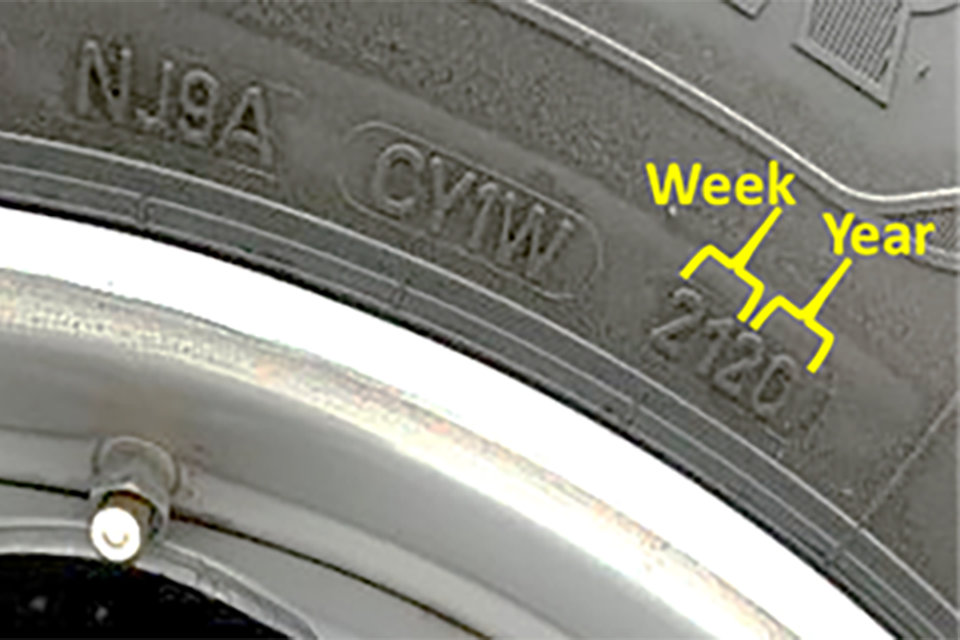

How old are the tyres ?
Check the 4 digit date code on each one ( on the side wall)
I have the brand Davanti all round.
And fronts are: 22 24, and 23 24
Backs are: 23 24 and 21 24.
