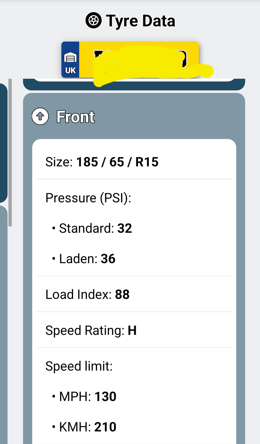

Wee Question with regards Wheels Tyres folks. I currently have a refurbished lovely looking Set of 15" wheels and tyres for my 2015 Panda. The Queery I have for all you Experts, is the Following.
The Wheels are 98pcd and pretty sure et30, they were originally on a Chrysler Ypsilon (Basically same setup???) and although they have Tyres, they are infact 185/65/15 of which 2 are brand new and 2 are borderline for being changed. Now according to the Tyre Data for my wee Twin Air, there is infact a table for 185/65 listed as well as 185/55.
My question to all you fine Panda Addicts is, will it be OK to replace the 2 Tyres that are borderline or will I have to go down to the 55series profile, bearing in mind, I understand the higher profile will probably put my speedo reading around 3mph slower than I am actually doing, and the fact that the Higher 65series profile should technically make it a wee bit softer ride than the 55series and perhaps the Height difference may also help with those flippin Speedhumps that wreck all the bottoms of our cars for sure.
I know that the GPS on my phone reads approx 4mph slower than my speedo does at the moment and that is with standard 165/65/14 tyres
Cheers Folks. (Wee) Jimbo.

Thanks for your reply ZaphodB: The tyre options I am relating too ( As shown ) is infact from the Manufacturer Data showing one of the Options in the Tyre Data. The ET stamped on the Rim is 30 (Although it doesn't have ET in front of it). I never thought of the ABS , Perhaps I should try them out on my car first and see if it throws up any errors? like I said, 2 tyres are almost new and 2 are Border line for being changed (Well in my eyes they are, unlike a lot of people , Afraid I like to change them before they get anywhere near to the minimum legal requirements) Hence the reason change 2 or change 4? lol. Cheers pal.

Like I stated earlier A3jeron, I bought this set of wheels which were newly refurbished for my Fiat 500 and just never got round to fitting them (as I already had a set of afternarket alloys on it already) and, 2 of the tyres on the refurbished alloys are brand new, the other two still have a good few miles yet for some folk, but I tend to replace my tyres perhaps a wee bit earlier than others, even though my last set I replaced almost 2 years ago and there was still a lot left in them also.
My question was , as there is a tyre data listing for my Panda, which clearly states as the attachment shows an option of 15" wheels with 185 65 15 tyres, which if giving this option, must surely have been fitted to a Panda model at sometime. Would I get away with just buying 2 new 185 65 15 tyres to match the 2 new ones fitted? or should I buy 4 x new tyres in a different size. I am assuming the higher profiled 65series must surely give a softer ride and perhaps raise the height of the suspension fractionally which would definitely help with those stupid speedbumps that don't appear to make any difference to some folk who just ignore the Speed limits , and the speed bumps, but it certainly would make a difference to all of us who drive small Pabda Sized cars. Cheers pal.....Jimbo.

I stated I am intending putting my 15"Alloys on my Panda, As some have said, it will put my speedo out.
The 14" refers to my currently fitted 14" StandardSteel wheels and my speedo reads 4mph faster than I am doing according to the GPS on my Sat-Nav.
The charts for the 185/65/15 inch alloys that I am intending to fit states , if I fit that size combination (185/65/15) my speedo will read 4 mph slower than I am actually going so therefore in theory, my speed would be 100% correct according to my GPS lol. Sorry for any confusion!!...... Jimbo.

All four tyres must be the same size as each other.
185/65r15 was fitted as standard to the Panda Cross, but with et30 wheels and (as with all the 4x4 models) a section cut away from the subframe.
If yours isn’t a 4x4 (so doesn’t have those cutouts) you will likely foul the frame on full lock.
Certainly they will foul. I run 185/65 15s on my 4x4 and had to fit 5mm spacers up front. Without cutouts, not sure how many mm they'd need to be.
