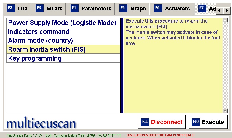

Reset is a software option in FES/MES. And CAN lines to be checked with oscilloscope (if the signals are clean, proper levels).
Despite name of the function, there is no "inertia switch" anymore from 2009 or so (it's a software thing: AirBag + BodyComputer talking via CAN).
