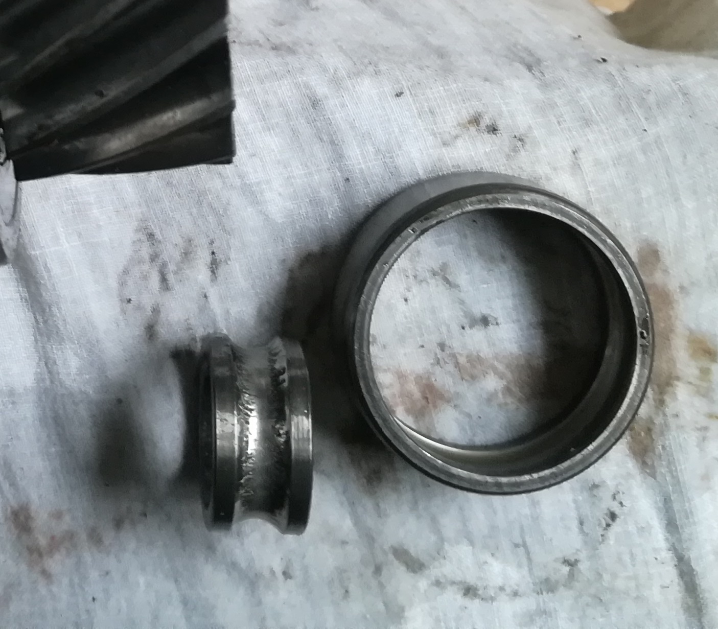

Probably fine for the expected lifespan of the car, but now that's over, I wouldn't be surprised if the plastic cage holding the bearings has collapsed or melted, causing play in the shaft which deforms the seal and results in leaks, which could contaminate a new clutch. Here's mine at 100k miles (160k km):

If it was me, I would be replacing:
  • clutch kit
  • 2x driveshaft seals (I didn't do mine when the gearbox was off the car, but I wish I had)
  • 1x input shaft bearing (I used SKF Explorer 6204 C3 bearing)
  • 1x input shaft seal (part no. 40004670)
  • Clutch cable
  • Maybe release fork bushes (mine were fine, I didn't replace them)

Looking at photos of gearbox on eBay for the punto, panda and 500. I would estimate 50% need a new input bearing
This is slightly biased as people changing a faulty gearbox then sell the faulty one as working on eBay to recoup some of the costs.
My failure rate is out of 3 gearbox’s 2 were shot and one was okay. One only had 60K mile on it. Kept topped up with clean oil and driven carefully there good for an easy 200K
