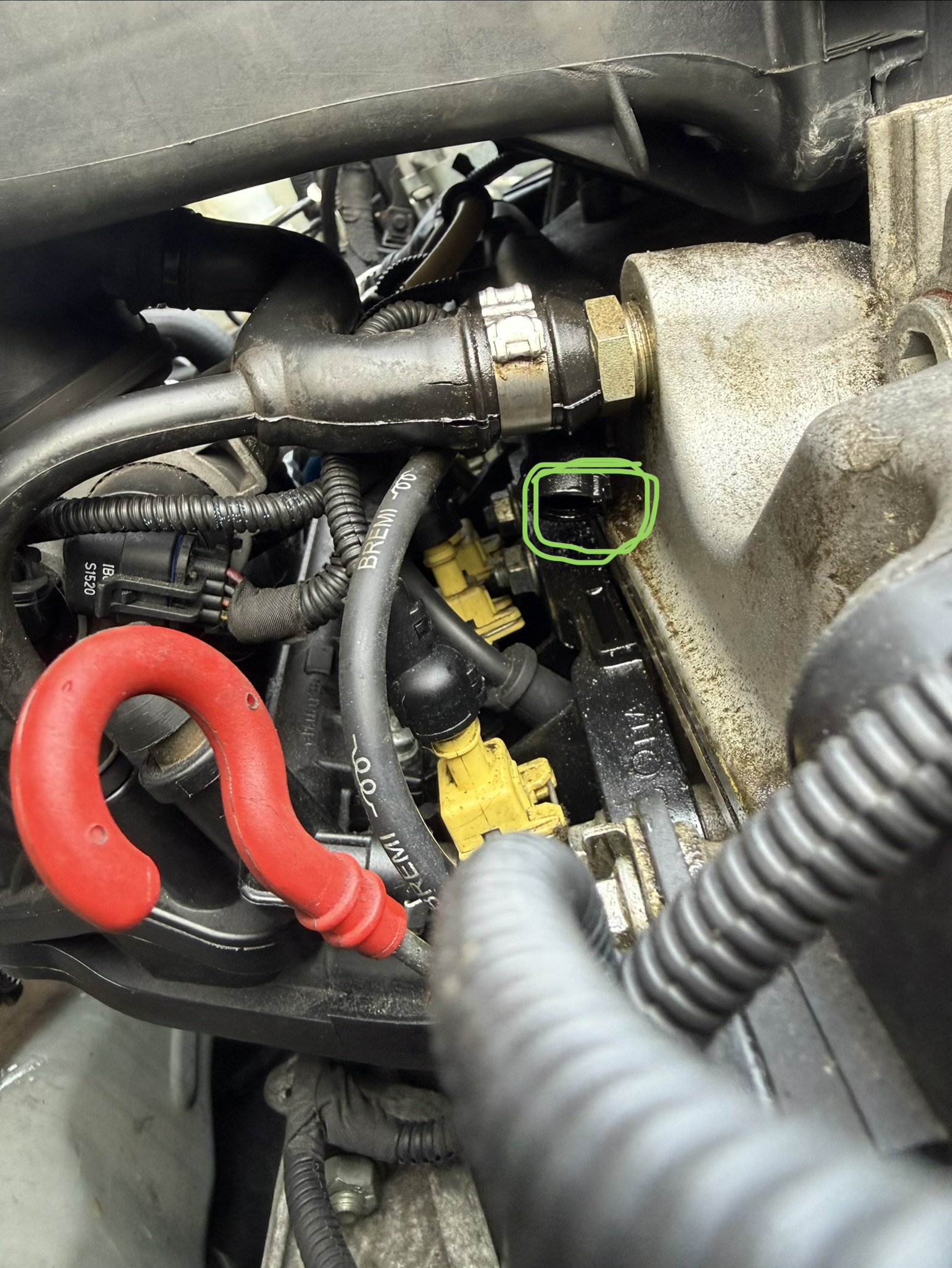

Another question for the Panda newbie household. I was having a mooch and check of oil level yesterday when I noticed this pipe (crudely circled in green). I thought it was the same one that had become detached from the airbox, but it isn’t. It has two sensors further along and is firmly attached. Should it be attached to anything?

Can you photo the other end
I thought the panda 1.1 from 2009 had two breather hoses
The breather pipe just above the green circle where that connected to

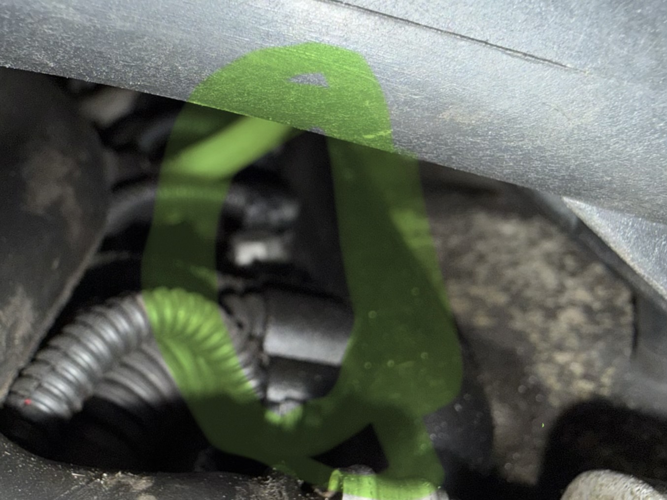

This photo is from the same side, but beyond the cam cover breather. The branches off are circled.
This pic is from the other side of the engine bay (right hand if you are looking at it from the front). I can’t see the pipe, I’m guessing it’s under the hard plastic pipe somewhere.
I thought I new these well, but don't see many 1.1
Might have to lift the air box and have a proper look and follow the pipe
Can see the little pipe from the breather hose is connected in the first photo
Brake vacuum is rigid and is connected
I can't thing of any other rubber pipes around here
@irc you work on the latter 1.1
Its the "shield", part number 55204205.
Nothing is supposed to connect to it.
(Just happened to have a 1.1 in bits, had never really noticed it before)

I noticed the split breather when I zoomed in on the photo.
The Shield sounds serious, but if it just ends that way it seems odd somehow
