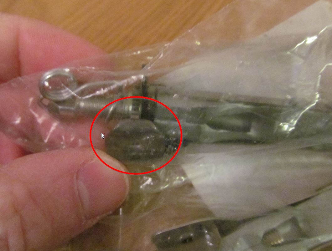

If there is too much travel on the shoe the ratchet moves to the next spline (When I let go in the vid) and when you let off the brake it rotates the adjuster out (When I push back together)... until there is no longer too much shoe travel before it makes contact with the drum. at this point the adjuster don't open out enough to trip over to the next spline.
However if handbrake cable is too tight the shoes can be held out of the proper resting point and the spline can not turn enough to let the ratchet get to the rest point (If I were to not push together enough in the vid), so it can't move any more and gets stuck.
If these little plates fall off the shoes will auto un adjust all the way back in without. they are a pain to put back while the shoes are on the car (been there done that).

If these little pointy bits get bent they won't adjust - they get stuck

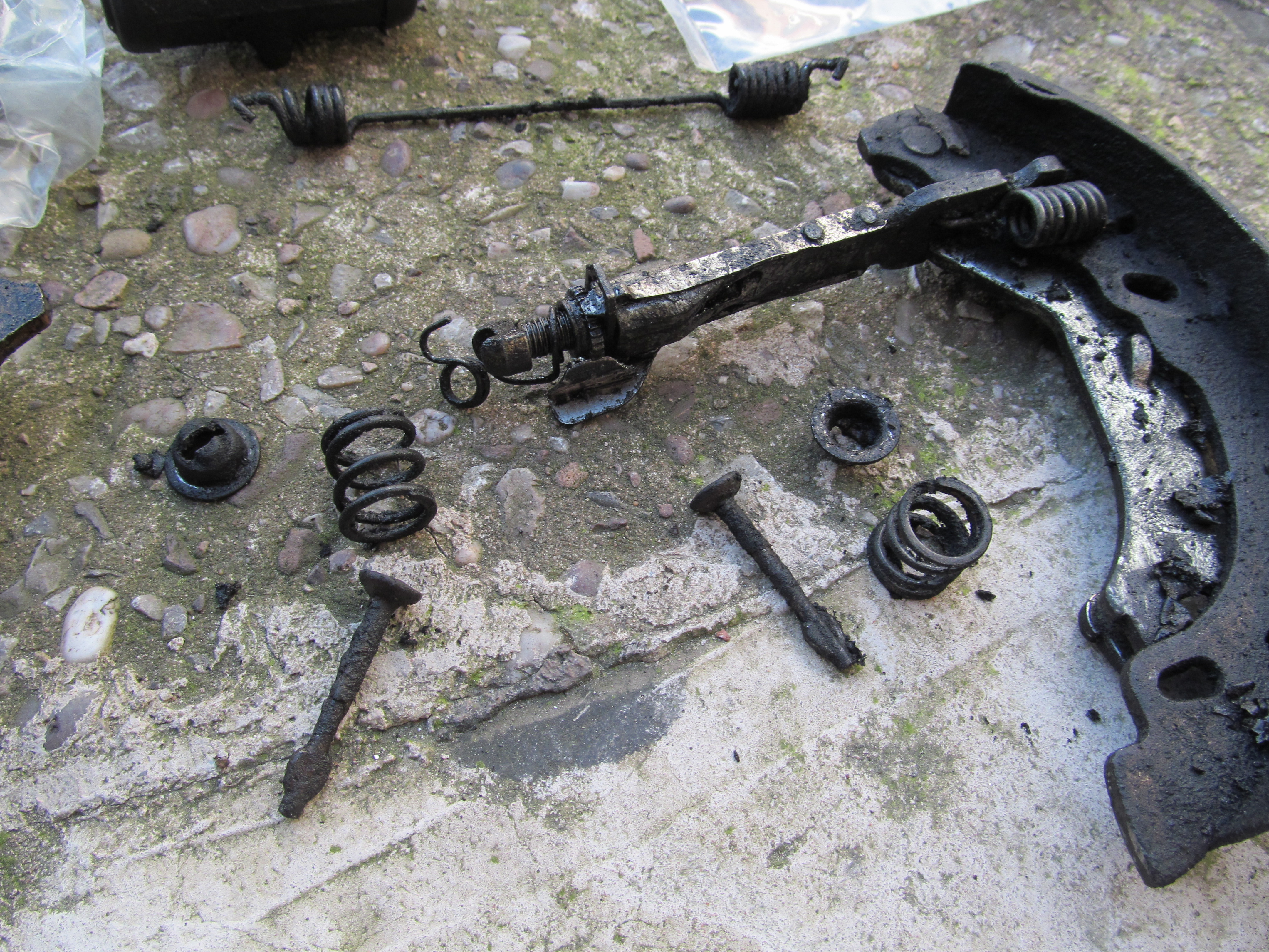

If the thread gets brake dust / croded they won't turn so won't adjust.
there seems to be a slim chance that they ever will adjust - and at the FIAT price I can see wny someone would weld these little buggers to get through an MOT and seel the car quick.

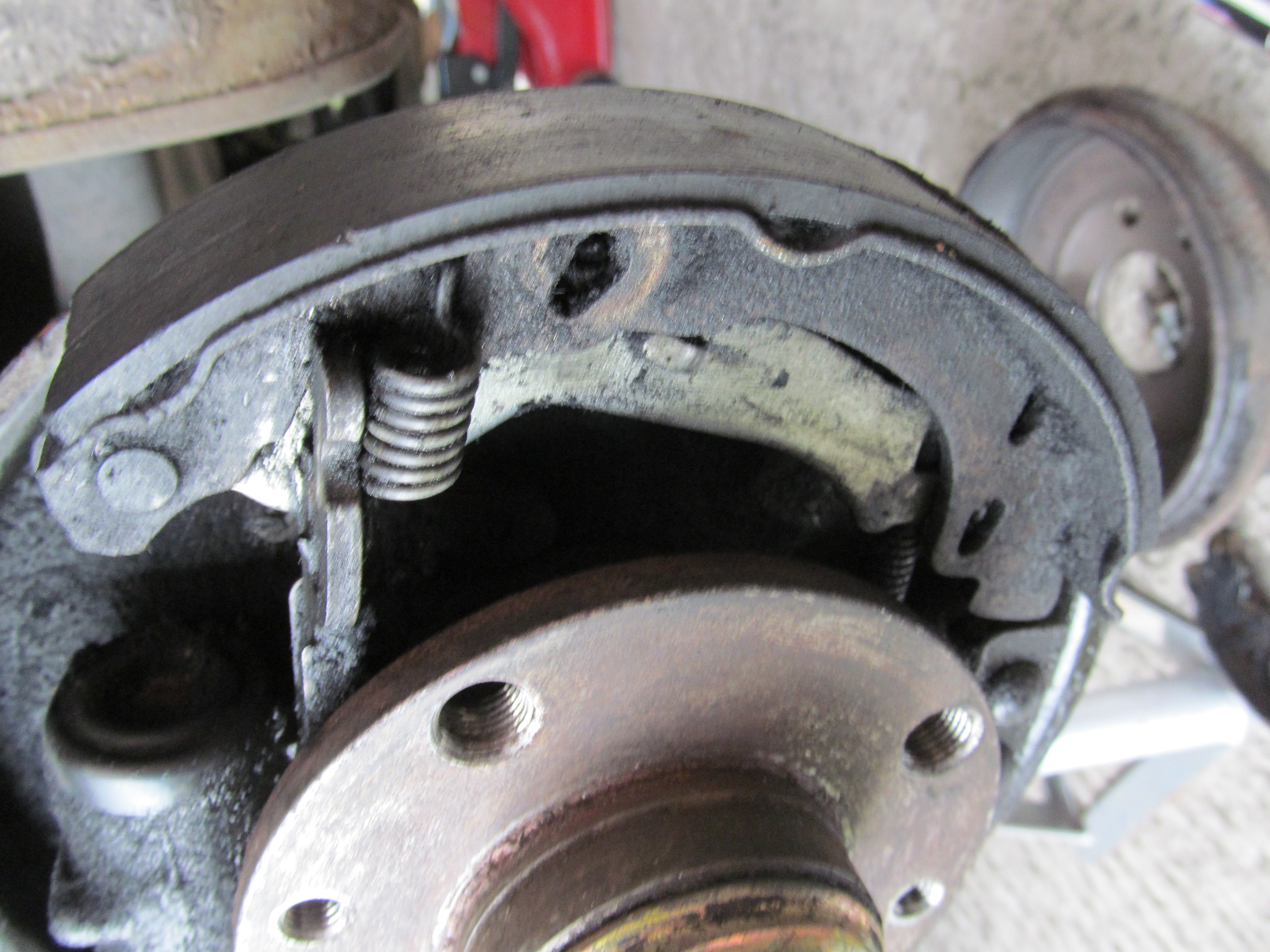

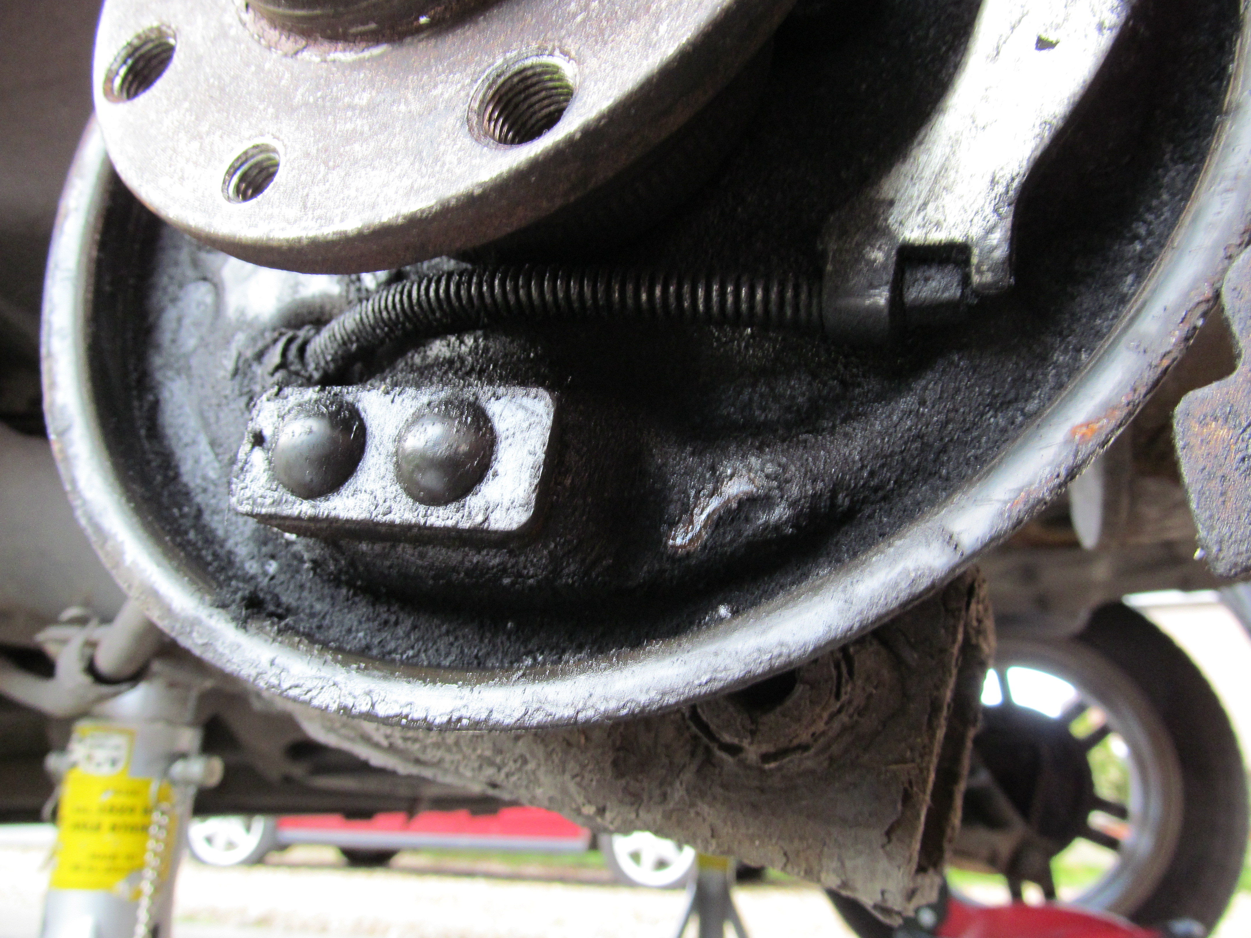

Few more pics when I replaced both cylinders, shoes, adjusters, drums, fitting kit and cable for good measure. drum was a mess after I lost a shoe lining. :bang: it just fell off the shoe so I ended up with metal to metal :eek:. they were bosch shoes too :rolleyes:
think about half of the parts cost were the adjusters :mad::mad:
