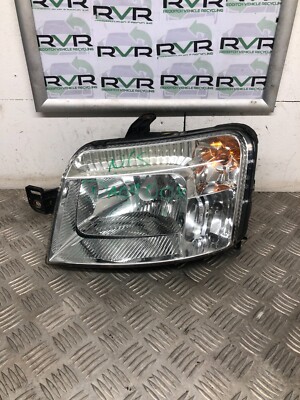

Hi all, wonder if anyone can help me, I need a left hand headlight for my Panda active 2011, it failed MOT on being to high and its wobbly, garage that did my suspension struts £310 seems fair? are having trouble sourcing an aftermarket one and my re-test runs out on Wednesday the 18th, is it possible to get an extensions to these ? Are Autodoc any good on line, I'm a bit flumoxed, cant get about so well in scrapyards etc due to emphysema, Any suggestions gratefully recieved. Oh I,m in SK10 area. cheers

I am guessing the mount here has snapped after a little love tap
Original JB Weld slow cure will stick this
Just rough up the area first and strengthen the gap with something, screws, bits of wood, or anything
You can even fabricate a new bracket and self tap it into place

Bought a o/s r/h one from S4P a week ago £131 delivered free, with the FF discount included. Delivered next morning. EBay sources aplenty have them at down to £59 for aftermarked makes that may well be fine. ECP have them on the shelf for £175. The S4P is a Magnetti Marelli unit which is the OEM maker.

Thanks, think ECP have the left hand one at £145, was looking at this one and sent my reg and vin number the seller said it looked the same but the part numbers were different when he looked it up, I don't know whether to risk buying it.
There are plenty on ebay from trusted sellers that promise 2 or 3 day delivery and even click and collect.

https://www.ebay.co.uk/itm/394294832361?fits=Car+Make:Fiat|Cars+Year:2003|Model:panda&hash=item5bcdcdace9:g:fQ0AAOSwuYlkuWif&amdata=enc:AQAIAAAA8EfuFabh9QZkMWSR36aE0Pg0r2Vbwni+bljWxb1nWw/0bBcTfhBebej/79bGgVeVTF2BJlTFnD9zdpDDRl3eBR6HcvZBfbnSPx8IXFNQbnflSFLDrtDpYiJofEgKILkQtuoHxe6uibbQCEbtGo25Cc8MHquL/S4tKn89Woax0vS9oc9JUFBTu3zrzHeiE5EjlRPdj/re57/CX6npAQ58ridgdMFqcMyo9d8r/sRmWyrKYUPGosblge//J7jJOMEFYIvT3+yWVRhM8wCeGJkVIfDuIzlJtwU1hiU4AriLWq8tkwG5zm4OGu4rSdr4EKYicQ==|tkp:BFBMrvreteNi&LH_BIN=1&LH_ItemCondition=3
Which would appear to solve your problem for about £10

"Pre 2010 will not be a straight swap" thanks for that info koalar. I have some Gorilla epoxy sets in 5 mins stuff unopened so will be going for the codge up to try and get the MOT
Agree with glue for MOT. If more permanent repair is needed afterwards, and the light is good apart from one or more broken brackets:
Repair brackets used to be a genuine part with proper FIAT part number, and the brackets on the light are designed to break on impact.
Most (maybe all) are now aftermarket ones, but are fairly simple to fit.
They are normally supplied as all 3 brackets for one side, so you do need to get the correct side.
Last ones I bought were about £7, but they seem to have gone up to about £10.
