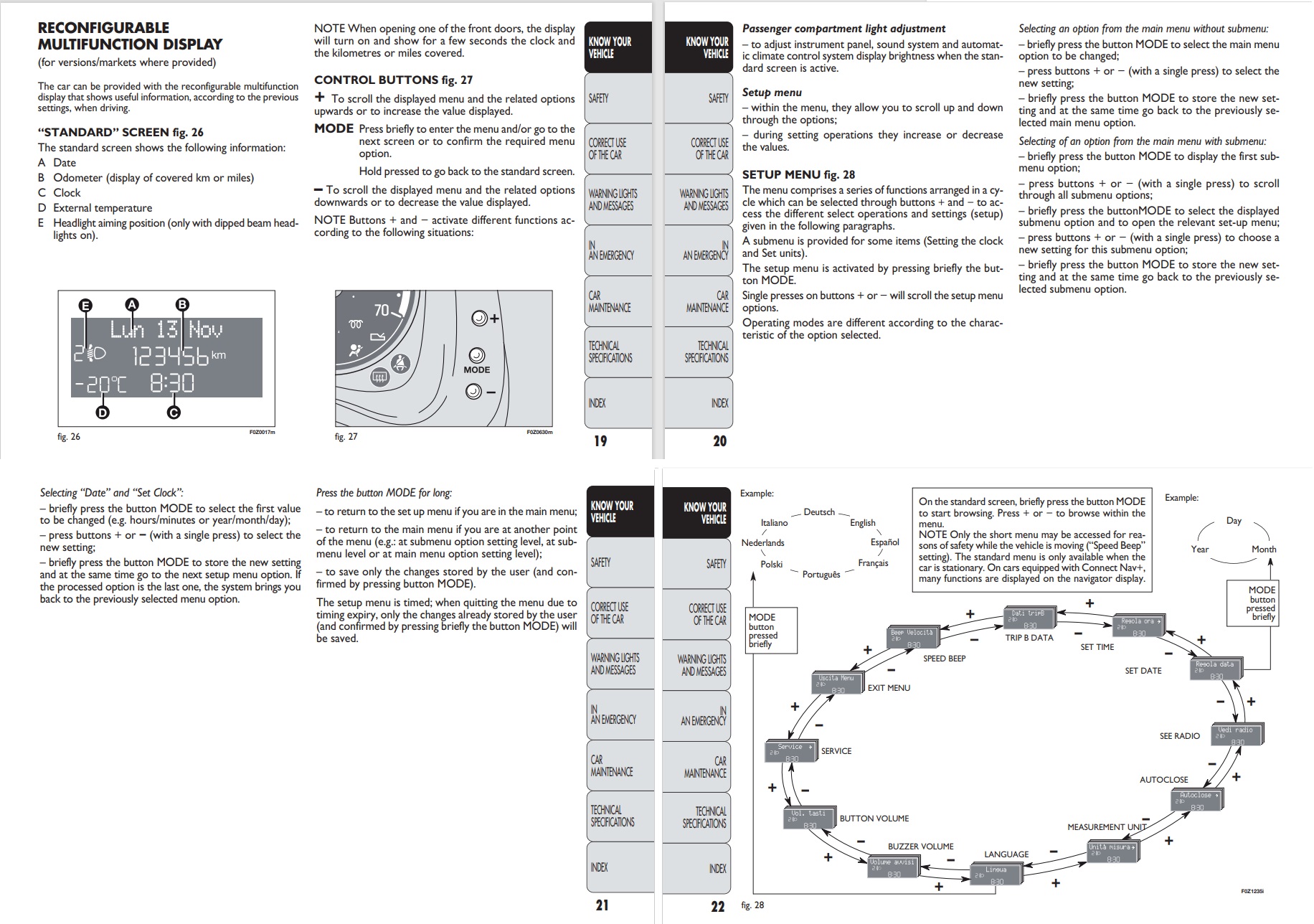

depends which dash display you have
simple display the top increases the clock the bottom decrease and middle nothing
With the more advanced displays the middle one changes mode so you can set the date as well
if the middle does anything it will say mode next to it and the dash will display the outside temperature
https://www.manualslib.com/manual/451836/Fiat-Panda.html?page=22#manual
:yeahthat: Hi Phoenixflier,
This button only performs functions on top of the range Pandas. Not sure if that's all Eleganzas & 100HPs or all cars fitted with climate control?
This button does nothing on my 1.2 Dynamic with manual air conditioning.
Here's pages 19-22 of the owners' handbook to show you what you could have had!
