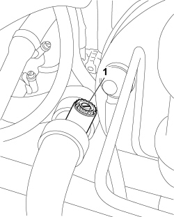

the drainage screw in the lower part of the radiator on the left hand side.
Don't bother with the radiator bleed screw if it's tight
Might be for the 500 but doesn't matter they are the same

Will do. Assuming it needs to be done cold (as the guide says), probably a bad idea to spray out hot coolant on myself? Need to get some coolant myself to top up with too but not sure what it needs. Might just ring my mechanic to get them to sort.
Yes cold
Removing the radiator cap on a hot engine is very dangerous, it can violenty erupt hot water like a volcano
Coolant already in there should be pink and Any Organic Acid Technology OAT is fine
The bleed screw is fairly safe hot, it's still very hot but the quantity that comes out is very small and you don't have the rest of your body near by

The bleed screw open proportionally with less than a mm, If you open when hot, it will start to hiss as the pressure forces the air out, don't open it any further, as soon as liquid comes out tighten, there's that so little flow it just feels a little hot.
It's not official, not rccomended, but it's by far the fastest way to bleed the system.
If you are not comfortable in doing this do it the official way

When I replaced the steel pipe at front of engine, I had a terrible job bleeding the system. The solution was a 2ft long rubber pipe that fitted over the heater bleed point. I put the funnel on the top end of the hose and filled it. Started the engine and kept topping up until it stopped glugging.

Bled the system as described in the guide by opening the air release valve and a little coolant. I definitely heard a small amount of air escape. Closed it once coolant started escaping.
Tightened everything back up and went to start the car only to hear the dreaded 'bubble gurgle'. Tried your quick bleed method but no further air escaped. Started the car again, 'bubble gurgle'. I have now noticed it very occasionally when driving too which is unusual since I would expect it to go away when the coolant reaches temperature/pressure.
