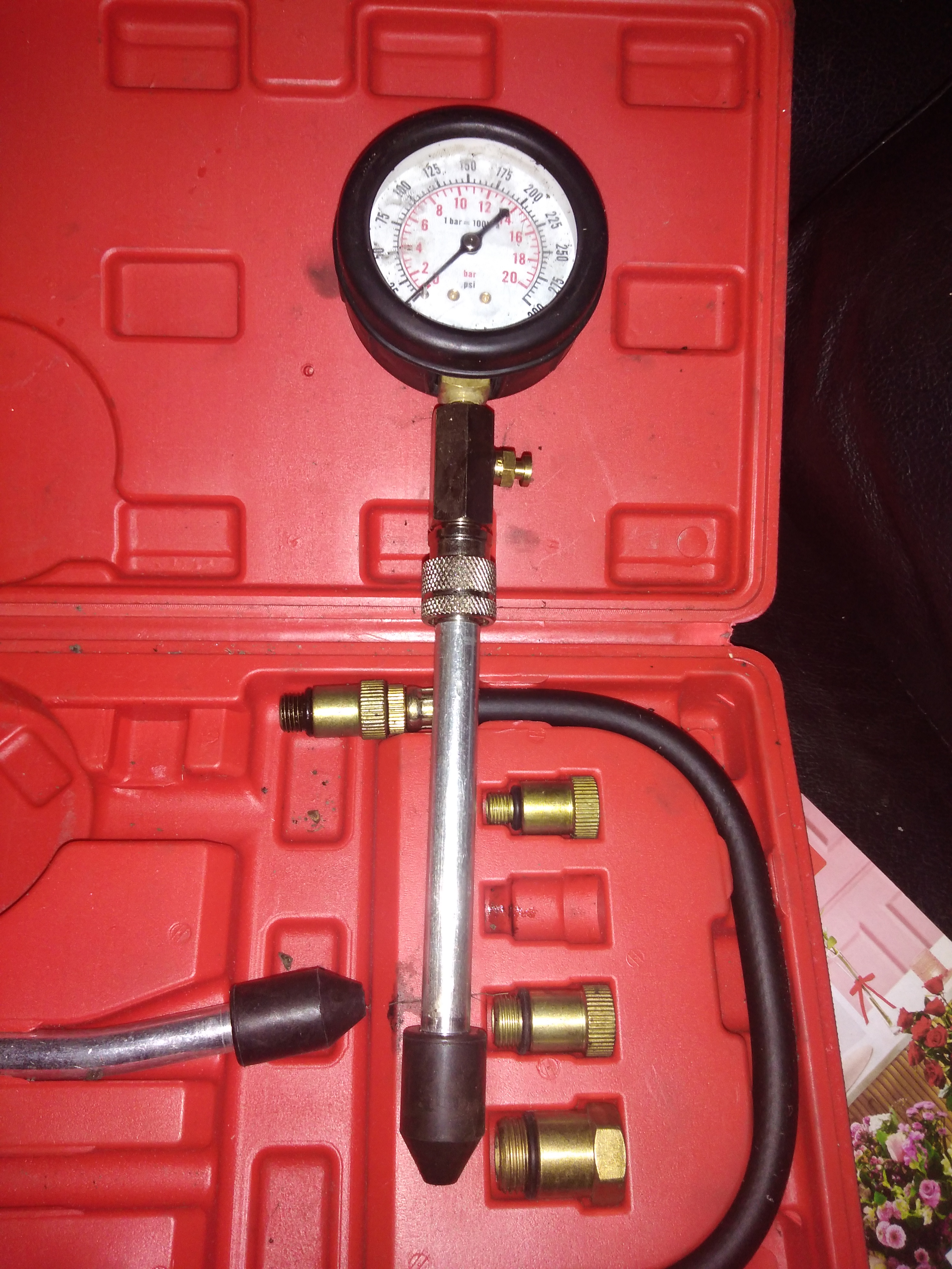

I find the cone works best I get leaks with the screw in tube and adapter
This is what i use

Post a picture of the setup used to test the compression
Does the Compession change if tested wet

Searching on google suggests a compression of 120 - 130 psi for a petrol engine is normal. My cylinders are all lower than this, but why would they all fail suddenly and together? I had the head gasket fail a couple of years ago, but the engine ran for ages like that. I checked the pressures by removing all the plugs and screwing the pipe from the pressure gauge into the cylinder and then turning the engine with the starter until the pressure stopped rising. The instructions with the gauge said not to use a wrench on the adaptor but screw it in by hand. I did this for each cylinder. I don't understand what is meant by checking it "wet".

You are either doing the test incorrectly
The gauge is faulty
Or this is your problem
