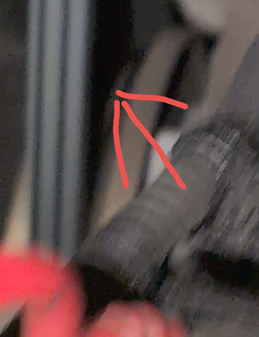

Being an active it won't have a spring loaded belt tensioner, so it may well just be that the new belt has settled in and needs the alternator moved slightly to get it back to correct tension.
Spray a little water on the pulley here and see if it goes away

Silly me! a much safer recommendation and just as likely to be effective. Just listened to it again and I'm going with a slightly slack belt?
Yep people have been using this method for donkey years, simple and quick
